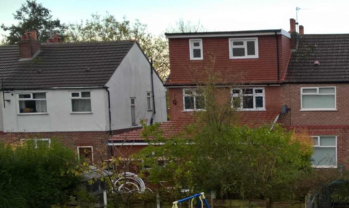

Hi, below is a roof dormer being currently built under permitted development rights.

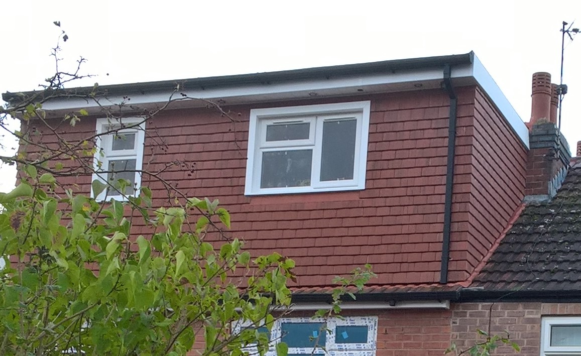

Here is a closer look, they demolished their half of the chimney (have a look at white building to compare) and seem to have extended over the party wall ! - notice how it attached and incorporated next door's chimney and goes almost half way across it.
Then there is the bottom portion where it meets the eves, I believe that under Permitted development rights, it has to be 20 cms above the original eves, as you can see they have extended past the original line of the adjoining property and now have it jutting out at the bottom.
My neighbour has just had a big loft conversion done about a year ago, and had the local council building control on his back all the way, not giving an inch !
But this roof dormer seems to break various rules, my neighbour feels like he has had a rough deal and is really p***ed off at what overlook his back yard.
Is this allowed, can he do anything about it ?

What they've done is build the dormer front off the outer skin, and then added eaves to ensure that the dormer front is at least 200mm from the outer edge of the tiles, where they overhang the gutter.
This is an attempt to bring it within the pd rules (any slight encroachment over the party wall is irrelevant), so technically the dormer is not pd.
However, whether the planning department will do anything about it is another matter, and enforcement is entirely at their discretion. If I was the enforcement officer, I would not take action over that.
In a theoretical worst-case scenario for the owner, they could ultimately require him to set the dormer front back a few centimeters, but this will have zero effect on the overall look of the dormer from your side. It would cost the owner £££ and will do little to help neighbourly relations; consider the wider picture - you have to live there.

If I was the enforcement officer, I would be sorely tempted to take action on the 20cm encroachment. I have a separate issue with the width, which is that it's now nigh impossible for the neighbour to build a similar extension. I think the rules should insist rather the opposite - that the party wall be built up to the full height of the dormer.

But why? As fmt, if the owner re-built the front a few cm back, it would have no effect on the overall look, and would cost the owner £s.
Besides, the policy guidelines on enforcement advise LPAs that enforcement may not be appropriate for "a minor or technical breach where no harm has occured". I would say this is a minor breach, and that no harm has occured, because they could still build an almost identical dormer under pd.
