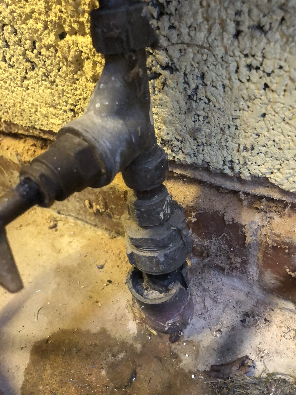

So my dad has just tried to turn the cold water off using the stop cock in his house to change a tap washer (no isolation valves) but evidently its not having the desired effect and the stop cock has now started to drip a little.
I'm not surprised consider the stop cock is likely 40+ years old so i'm expecting to make a visit to have to replace for him
I got him to send a photo (see attached)
From what i can see, it looks like a black alkathene pipe (you can just make it out) that looks like it has been housed in some protective pipe cover
So my thought was to :
  1. remove stop cock and trim/tidy up alkathene pipe
  2. fit a Philmac connector (the ones with push fit 15mm copper on the output end)
  3. small length of 15mm
  4. new stop cock
Approach sound about right ?
If so, can anyone confirm just what the size the alkathene pipe is likely to be please so i can get the right one, as my dads eyesight aint great and if i ask him to scrabble around on the floor, he likely wont be able to get back up again !!! :LOL:
House was built in 1981
TIA !

Almost certainly 1/2 in alkathene had a external size equivalent to 3/4 copper. Came in class C and class D (different wall thickness) so different inserts.
Bottom line as above just change stop tap get a decent one screwfix sell pegler ones.

It looks to me like you already have a stub of 15mm or 1/2" copper pipe, so if you use that, an off-the-shelf stopcock will save you a lot of trouble.
Sometimes you can swap the headworks (the moving parts) from an old to a new stopcock, which save you disturbing the connections, by undoing the large nut under the handle and spindle. Practice by taking your new stopcock apart and you will see what I mean.
I hope you have an outdoor stopcock in the garden or under the pavement (may be integral part of the water meter)

You mean the one in the pic? Might be partially seized through age and lack of use.
It does them good to close and open them once a year
If you can turn off the outside stopcock, it looks to me like the old one is leaking round the spindle gland. Probably age, corrosion and tarnish have roughened it and rubbed loose when turned.
If you undo the smallest nut nearest the handle, polish up the spindle with a green pan scourer, wrap a couple of turns of PTFE tape round it, and carefully retighten the gland nut without scraping it off, it will probably stop leaking until you can make a proper replacement (or until it has to be opened and closed again, if sooner). When built, it might have been packed with greased string or fibre or something. It is easier to clean, polish, lubricate and re-seal if you take the whole headworks apart on the bench, but I don't suggest you do that as it will leave the house without water until you have finished, and something might go wrong. I like to put PTFE on the threads when reassembling to prevent it seizing again. Many plumbers disagree with me.

I expect it's just seizing with tarnish, corrosion, limescale etc. If you have strong hands, work it to and fro, in and out, a bit at a time and it will probably free off. No great force.
