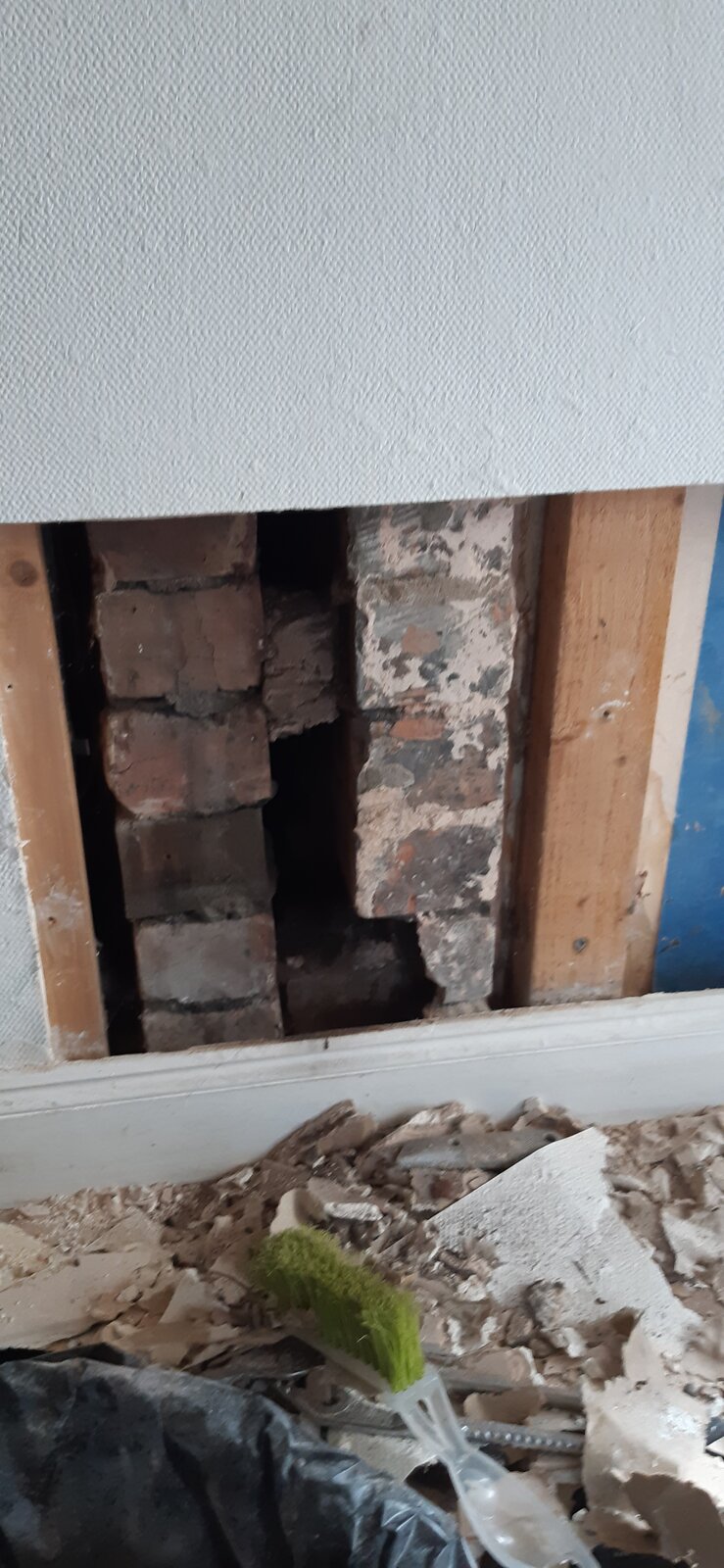

Hi, I have some damp in this area, should I remove that from the cavity?
I had a surveyor in a while ago.
He noted that small areas of damp in our house were caused by what he called "snots":
lumps of mortar that drop into the cavity, catch on a wall tie and set, bridging the cavity.
This is quite a big piece, seems like it was done intentionally
Don't know why that would be.

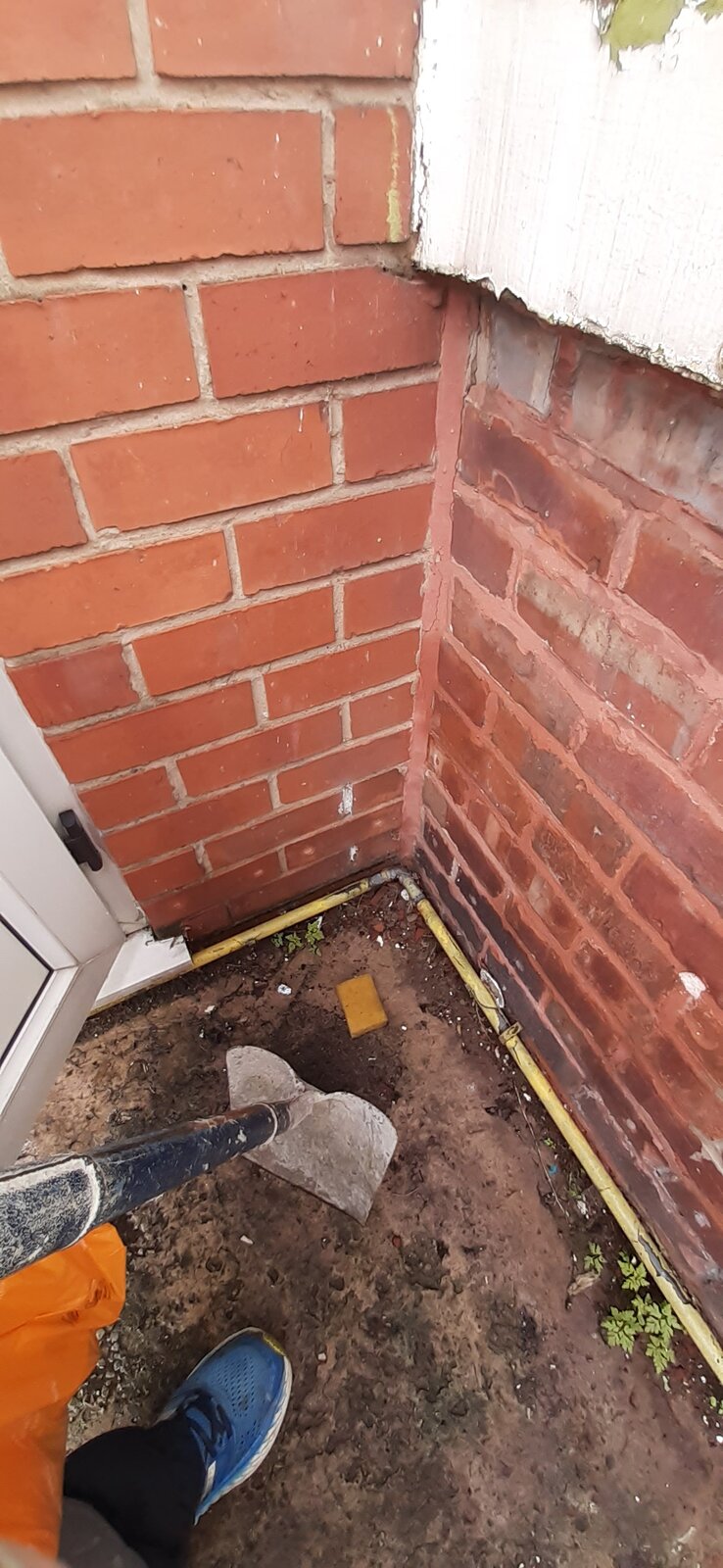

Can you post a picture with a wider view?
Sorry I don't live there so I can't, it's where the new wall of the extension meets the one shown with the cavity.
This is it from outside
Hi Gary,
As I mentioned before - you have some very expensive difficulties that need fixing.
