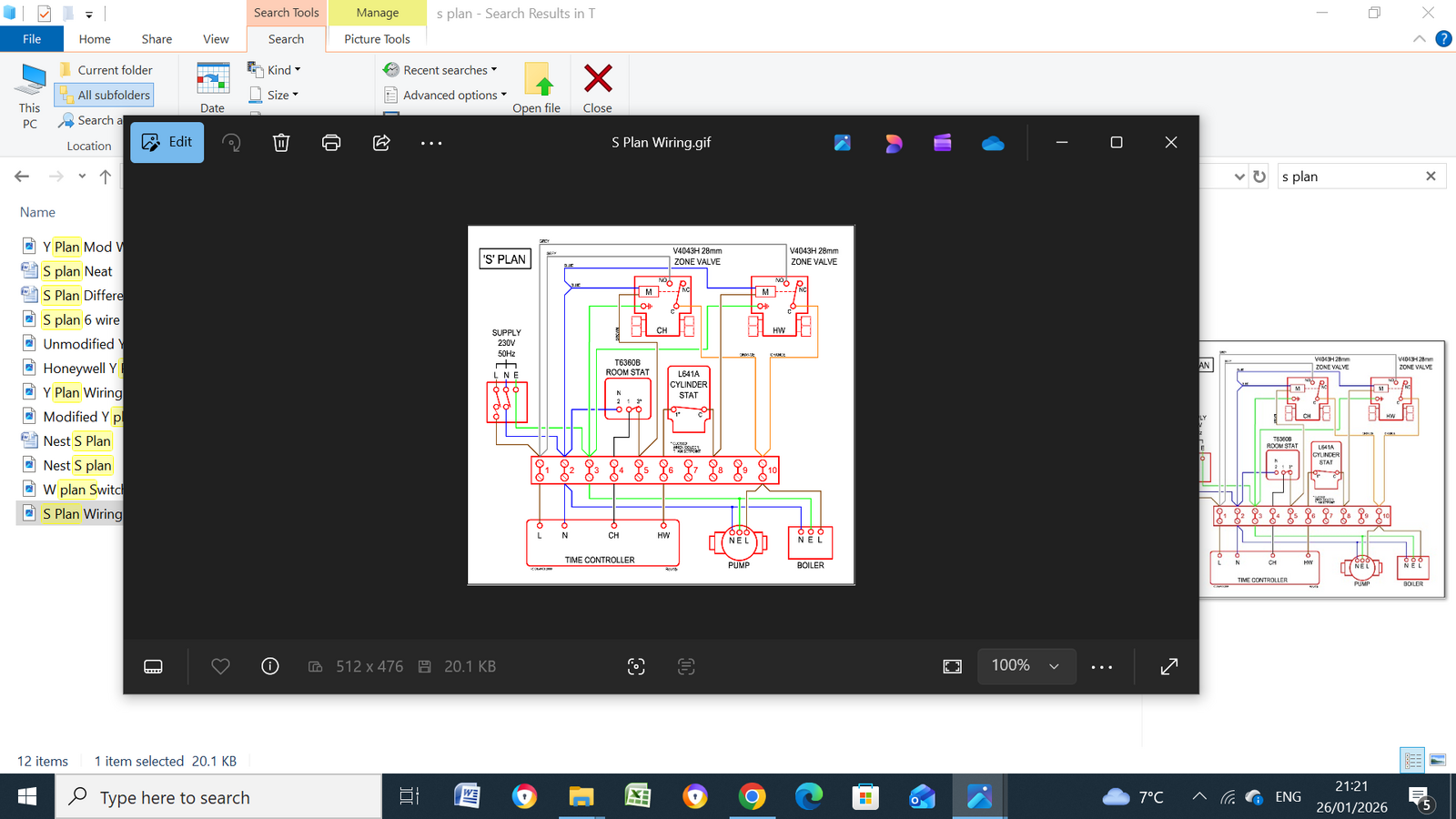

Have you got zone (motorized ) valves, if so, then, assuming CH only on, if the timer is on and calling, then it supplies 230V to the roomstat, if the roomstat is also calling, it opens the zone valve and a auxiliary (end) switch closes which then supplies 230V to the boiler, the boiler then starts and "tells" the pump to start/run, if either the timer times out or the roomstat is satisfied then the switched live to the boiler is turned off, and if no other zone valve calling should shut down the boiler but leave the pump running (overrun) for a few minutes. It seems strange that this only appears to happen only when the roostat is satisfied, if I'm properly interpreting how it works. If that switched live supplies the boiler AND the pump then both should stop, period?. Has the boiler got a automatic bypass valve (ABV)?

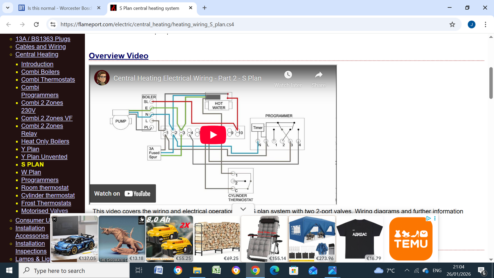

I've referred to the S plan diagram above. It's pretty much the same as on mine except that the boiler has only 4 wires coming out. A black wire I've taken to be switched live connects to terminal 10. The regular live, neutral and earth wires go to terminals 1, 2 and 3 and the pump live comes from terminal 10.
The pump seems to run signalled by the motorised valves which also tell the flame on the boiler to fire up. I'm assuming this same wire tells the pump to continue running when it would otherwise be off.

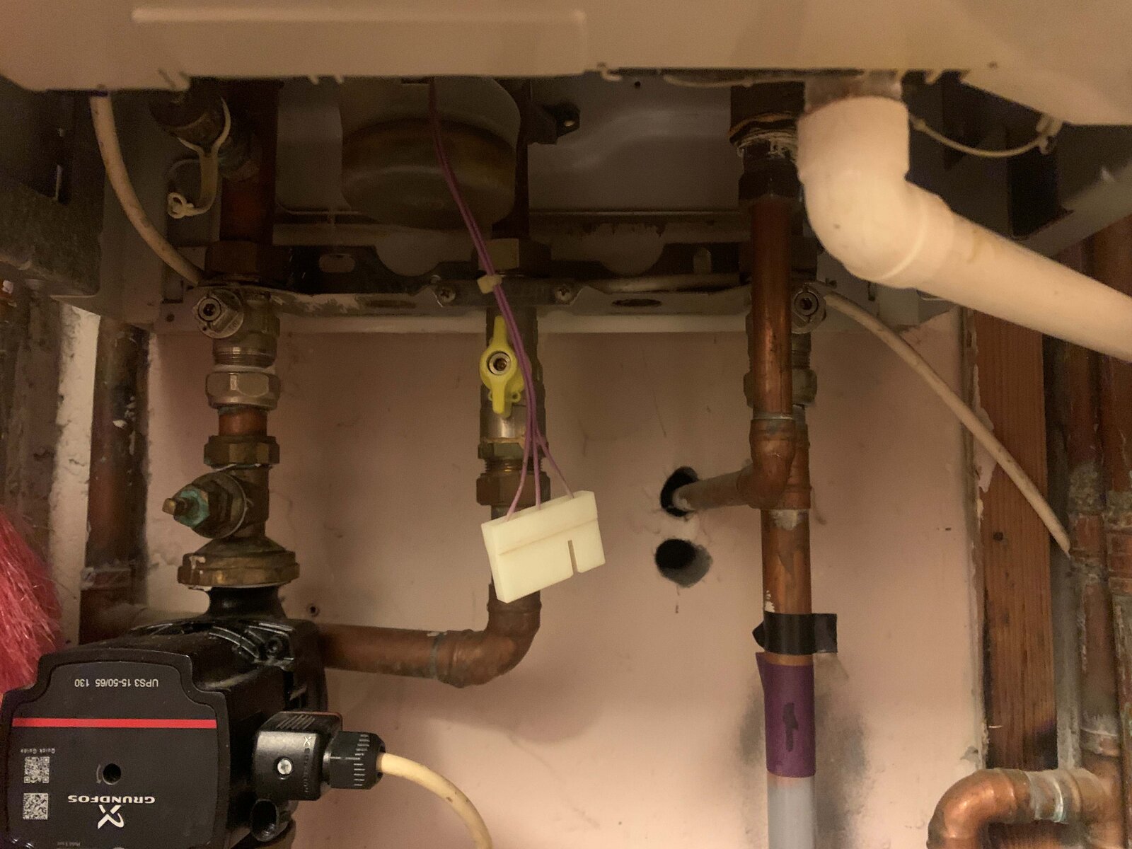

I don't know if this makes sense but inside the boiler there is a plug with three female spade terminals each with lilac coloured wires. This is just hanging loose. I can't see whether this is meant to be plugged in somewhere or is to be used for servicing purposes.

Terminal 10 should supply SL (switched live) on the boiler and PL (pump live) on the boiler should supply the pump, when term10/ SL has 230v then PL (pump live) also has 230V from the boiler's L (permanent live) and the PCB, when the programmer is switched off or all the zone valves close there is no power to ter10/SL but the boiler's PCB ("delay off timer") should keep PL (pump live) live via the boiler,s L (permanent live) for a few minutes and then switch it off.
I have a S plan oil fired boiler but no pump overrun so is wired like the bottom schematic.
Many thanks for taking the trouble to explain this. Regrettably I don't have a separate PL wire from the boiler only the SL wire. If this boiler is normally capable of getting the pump to run after the timer and/or thermostat have tripped out, then I think I have an internal fault or the spare plug I mentioned is not plugged in as intended. This what it looks like below but I can't find where it might go or what it does.
