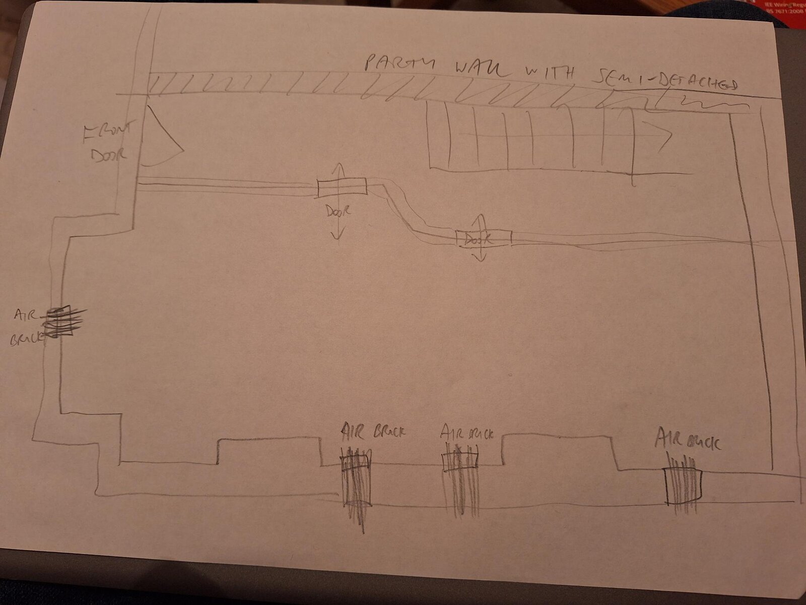

I have now found a slate damp course in the external walls. The sleeper walls also have some basic plastic damp-course.
It is a semi-detached house and think no ventilation through the party wall to the other semi. Also no ventilation to the rear. There are currently three air single air bricks on side wall, and one in front elevation. They are not 75mm above the ground but it's sheltered so no risk of flooding. I've cleaned them out and they are letting in air.
But I don't think they provide much ventilation and there is rot on some beams and a bad smell in the middle of the house. I also plan to insulate between the floor joists and build a few small new sleeper walls to help with deflection - those 4x2" joists are right on the max span permitted for C24 (which they may not be). So the airflow will get worse than it is now.

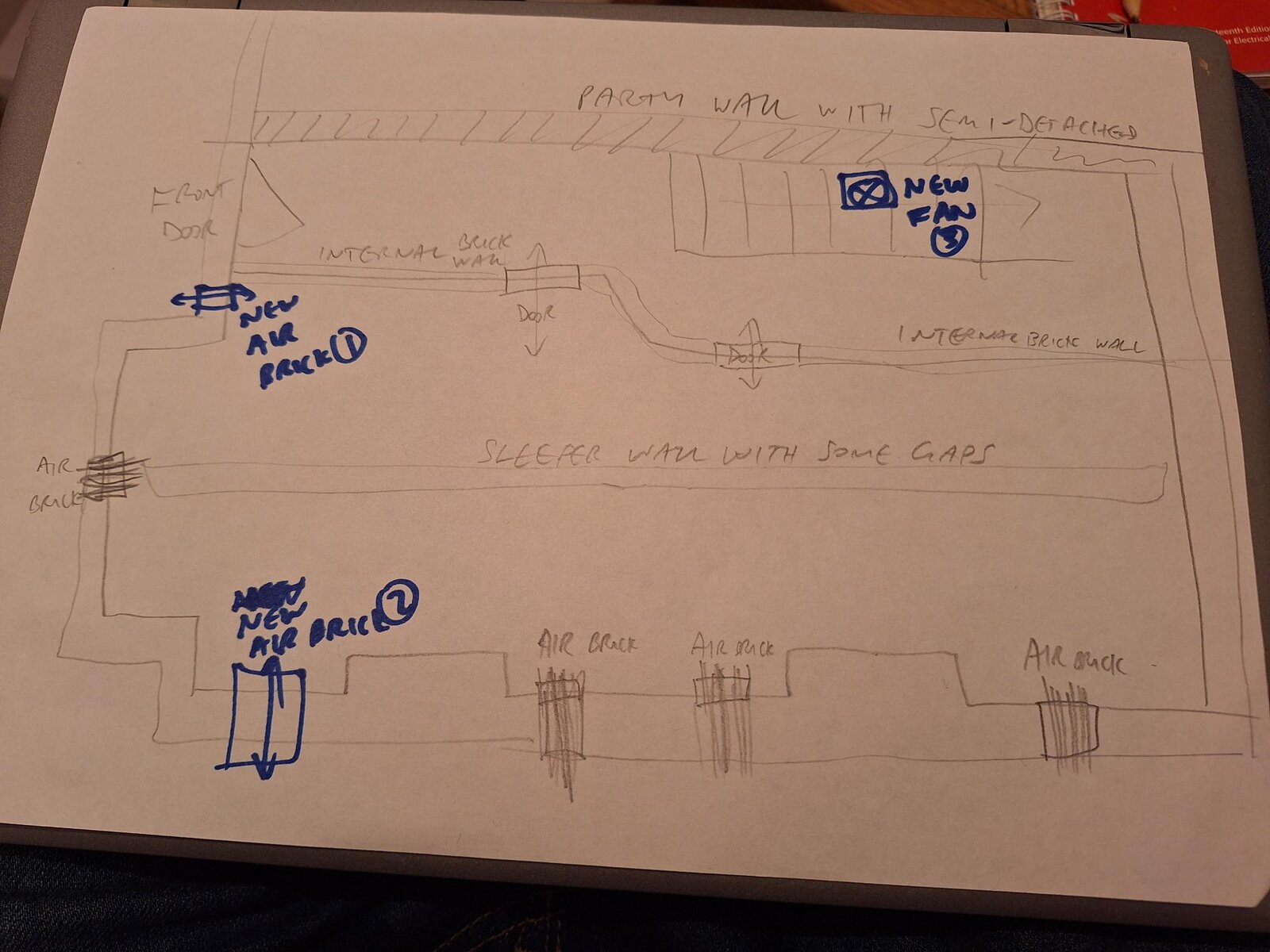

To help subfloor ventilation I have already cleared out rubble and knocked some bricks out of internal and sleeper walls that are not supporting anything. But I think it will need more. Here are my ideas for improving (see pic):
1 and 2 - try to put some new air bricks in?
3 put a bathroom fan under the stairs to push air from hallway down into the subfloor, at the point furthest from the current airbricks and where the stale smell is worth. It could be on a timer so it comes on for an hour a day or so. It would be mounted in a ventilated cupboard above ground so accessible for cleaning etc.
Would any of these work? If there is no cross-flow from air bricks, does it make more sense to put a fan in to push air down into subfloor and out of the airbricks rather than hoping air blows through them?

Thinking about it, I think blowing warm air from the house down into the subfloor would be a bad idea. The moisture in it would condense on the colder surfaces like underside of beams in the subfloor.
Perhaps just a fan under the floor to circulate the air in that part furthest from the airbricks?
All sleeper walls should be honeycombed to allow thro or cross ventilation.

I would only consider a fan under floor in the cupboard under the stairs, where I could make it fairly easily accessible.
Thanks the sleeper walls are not honeycombed but I might be able to knock a few bricks out here and there to make them better.

Would putting in more air bricks in front of house be worth it?
