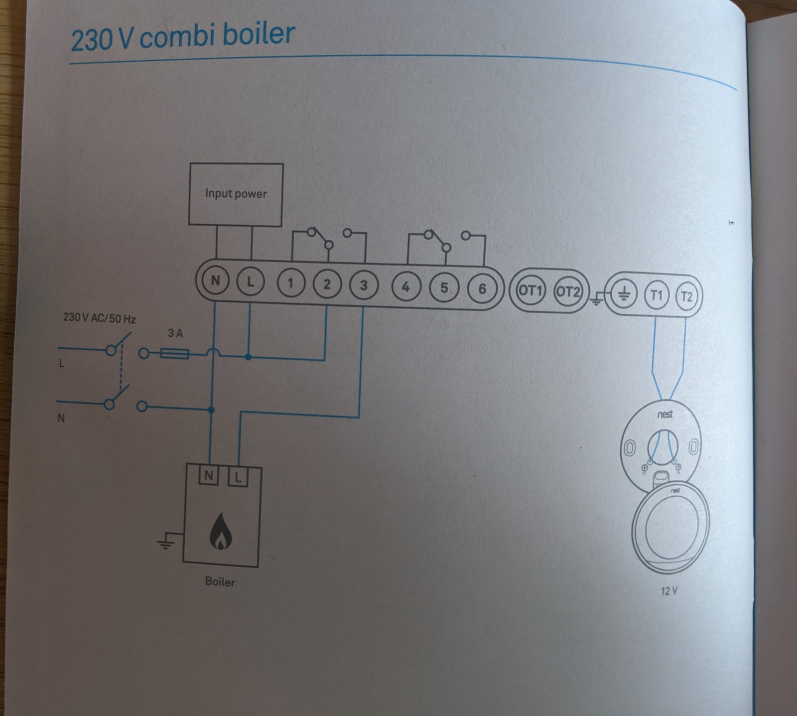

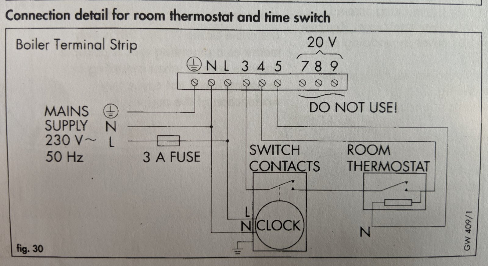

Hello, just want to be sure I'm getting this right. Combi boiler does not currently have a thermostat and I'll be using a Nest stand.
Nest heatlink to boiler (Valiant Turbomax 242/1)
N grey (neutral) to 5
L Brown (live) to 3
3 Black (sw live) to 4
And loop wire between L and 2 on the heatlink.
Probably a daft question but I want to be sure; do I need to run power from the mains to the heatlink too or does the heatlink get powered from what is written above, ie just one 3 core cable running between the heatlink to the boiler?
