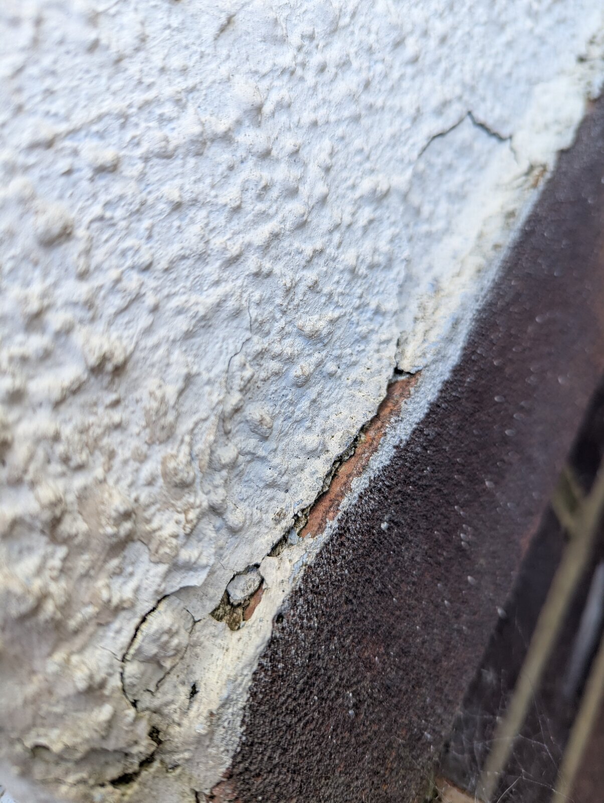

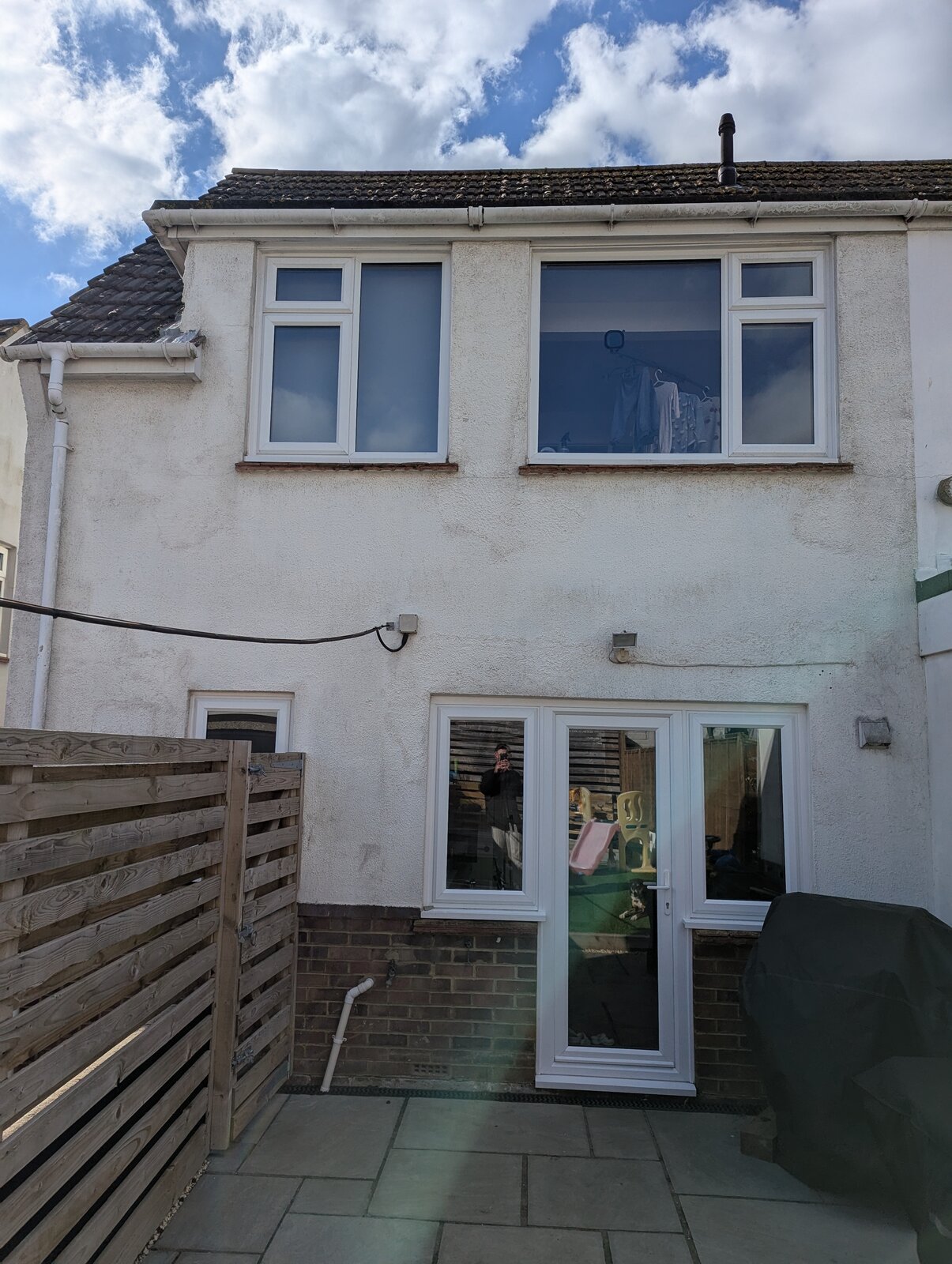

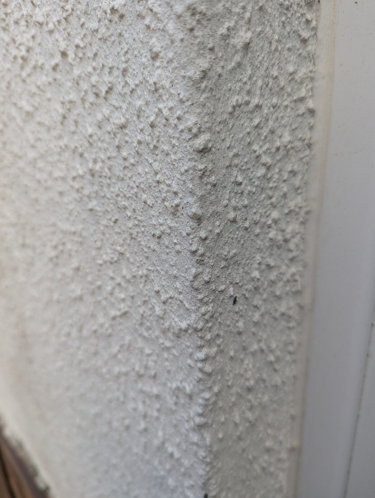

Hi looking to paint our house, no other house has this textured finish on our road so wondering if this looks like textured paint or actual textured render then painted

It looks like that spray on cheap finish the cowboys put on to " seal " your home which ends up sealing in the moisture and flaking off
Or it's like tyrolene ?
I would jet wash that down with the washer on a light setting
Let it dry over a few days then first coat of a ordinary masonry coat slightly tinned , say a pint of water per 5 litre tin
Then a coat , or two , of straight masonry on top
Should come up OK
If there are any rust marks on it seal them first
