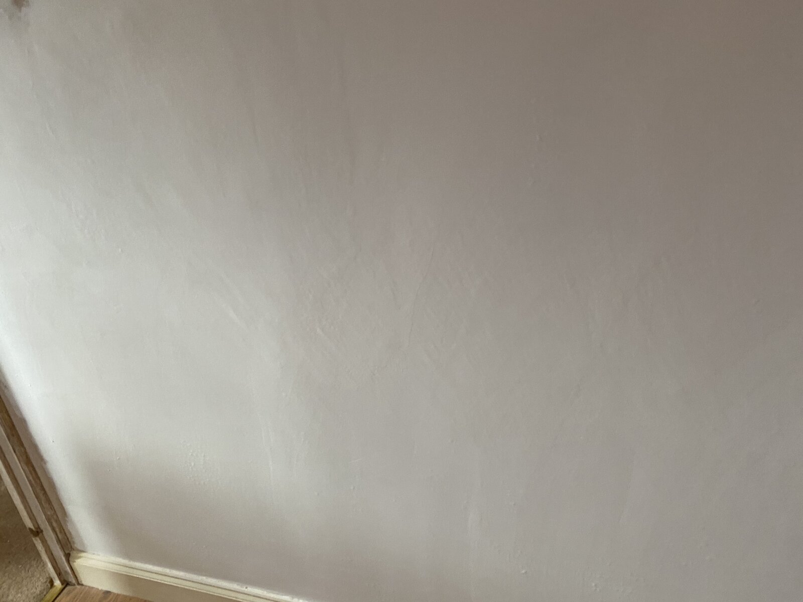

Hello we have recently had quite a few of our rooms skimmed. We waited over a week for it to dry in hot weather and kept it well ventilated. My husband has just done the first coat of primer/ undercoat (water based dulux for walls) and we have noticed the plaster has this rippling. See photo attached. We are disappointed and was expecting a smooth finish. Will it look better when painted or should we be expecting more from the plasterer? Thanks
Looks like it went off before it could be flattened properly or that maybe their normal standard of work,where did you find them and are the other areas of a similar standard?
I don’t understand? Do you mean did he paint on the plaster?
Yeah, when I zoom in, it looks like it’s been applied with a brush rather than a trowel. I wouldn’t be happy with it - it should be as smooth as glass almost. It’s also bubbling down the bottom right.
No the plasterer definitely used a trowel I was there when he did it. We waited for it to dry and my husband put one coat of undercoat with a roller and now it looks like this. Yes we were expecting a nice smooth finish. my husband has messaged him now to come back and sort it out. The thing is he has plastered many of our rooms so I’m afraid this is going to be a real problem for us ☹️
It’s my husbands colleagues son that’s where the recommendation came from. We can’t really tell if other areas are similar because they are still that peachy plaster colour. It’s shown up when we put the undercoat on. Thing is we’re paying a painter to come and do the big areas in the hallway so are worried we won’t know what the score is before he starts work and this is throwing more money at it ☹️
