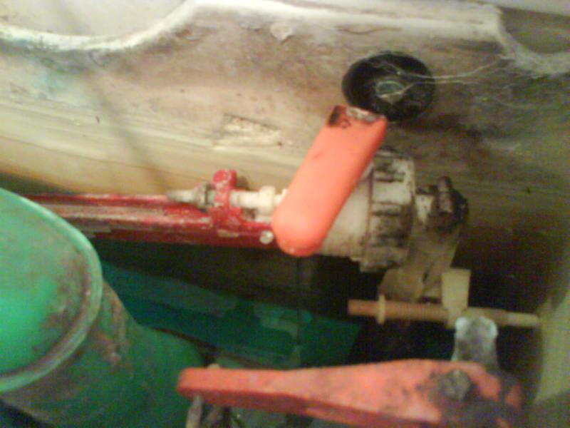

Thanks all. I found the stop cock under kitchen sink (there was a load of junk in front of it) and has therefore shut off all the cold water.
One new problem is that my ball valve won't fit. Someone gave it to me for free so knew it may not be compatible.
Got a couple pics here to give you an indication. What's the thing called the valve arm is mounted to? Is it a side inlet cistern?
Lower pic is the mounting for the new ball valve
The new male thread is way too small to fit the original large plastic nut.
You have two different types of ball valves there.
The one in your cistern at the moment is a BOTTOM feed valve and the one you are trying to replace it with is a SIDE feed.
The one you are trying to replace it with should really only be used in your tanks (in your attic) to comply with certain regs.
Go to any local plumbing merchants and ask for a bottom feed ball valve, should be a standard swap.
