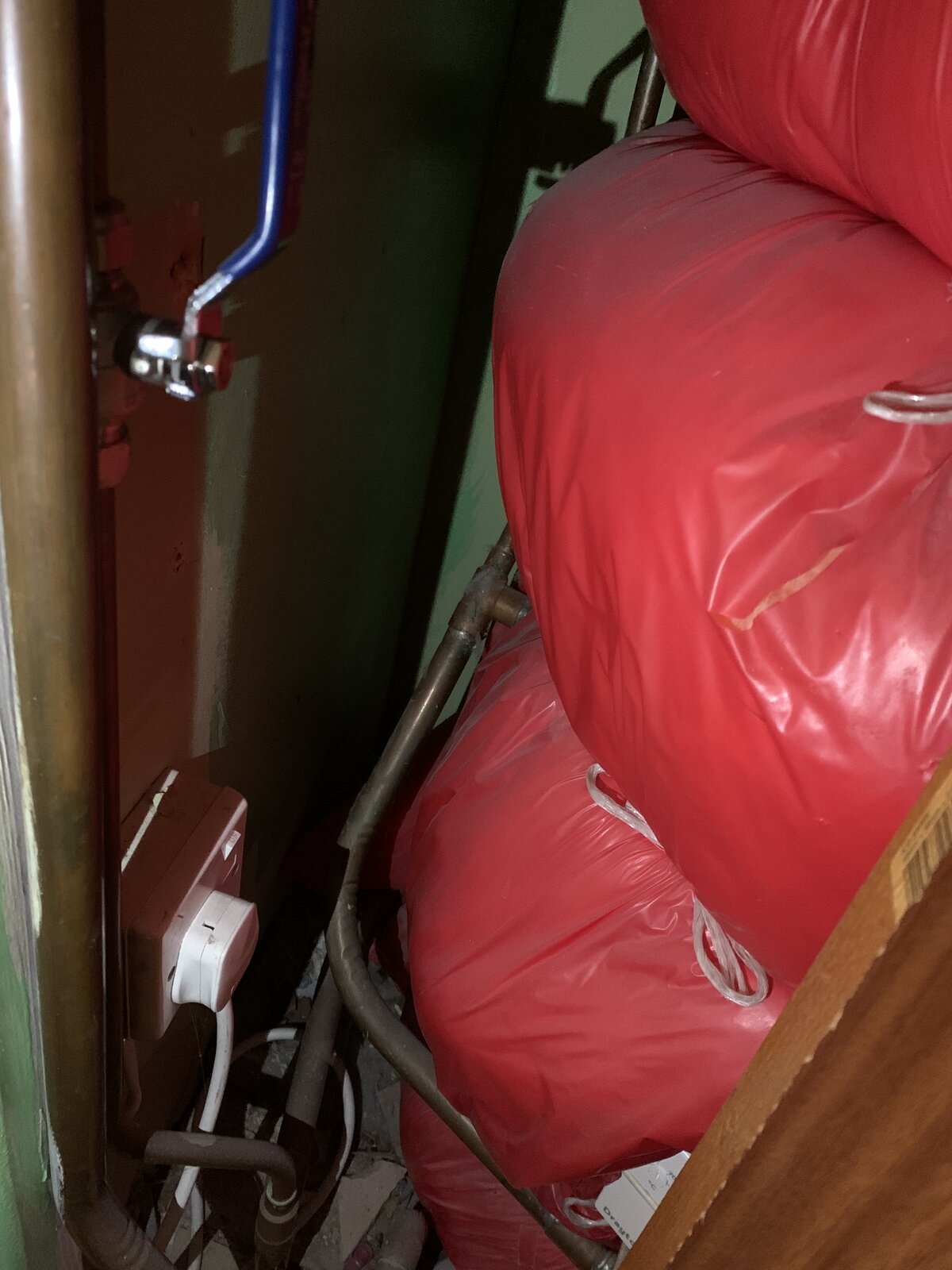

Many thanks for your reply. I’ve just seen this (runs to the smaller pipe in the second picture), will this turn off the flow from both tanks or am I looking for a second one?
The tanks feed separate supplies, one for taps / toilet and one for central heating, so that valve will only do one. Look for the central heating pump, the header tank feed will drop down behind it usually.

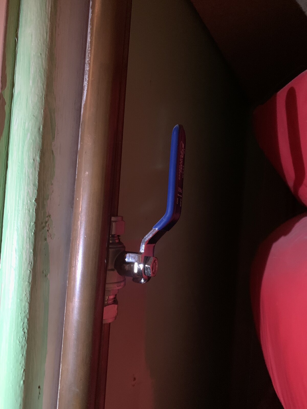

Ah fab thanks. I’ve just found this one which is opposite the other isolating tap, and makes sense based on location of two tanks in loft. Would this be the one?
I’ll turn off the main stop cock outside and also drain the taps. I may also isolate both the tanks just to be on the safe side aswell, is there any harm is doing that apart from the air locks?
Thanks for your help, appreciate it
No harm, but unless you’re carrying out heating work, no need to isolate the small feed and expansion cistern

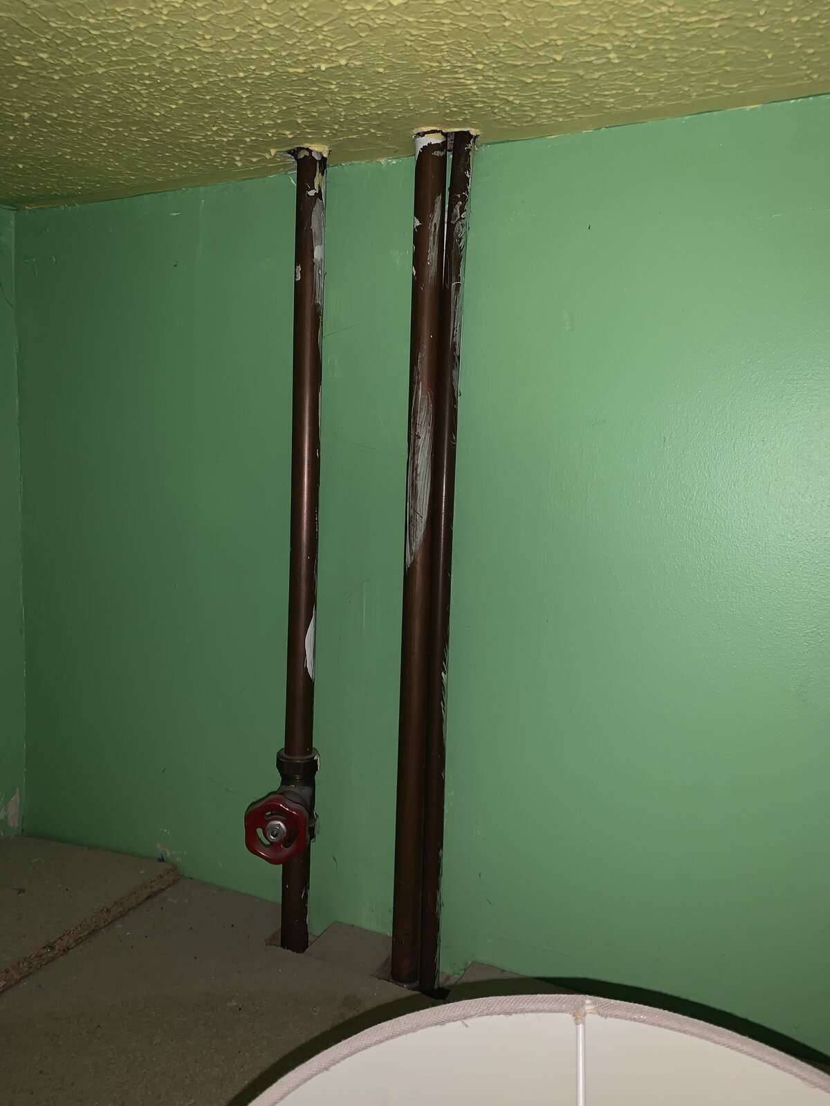

Don't touch any gate valves (red handles) in airing cupboard they have a habit of breaking in the closed position
