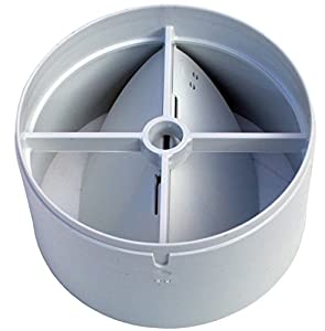

Bought a stand alone wafer/butterfly valve:
Did some jiggling about and set it as high as i could into the duct. My ducting is waste pipe so i used no-nails to set it. If i need to remove it in future I'll have to destroy it but its not been a problem since i did it a decade ago.
With the valve sat high in the duct, i removed the built in valve on my new fan (xpelair) and trimmed down the spigot as much as i need to to get clearance on the valve in the duct.
Works great.
