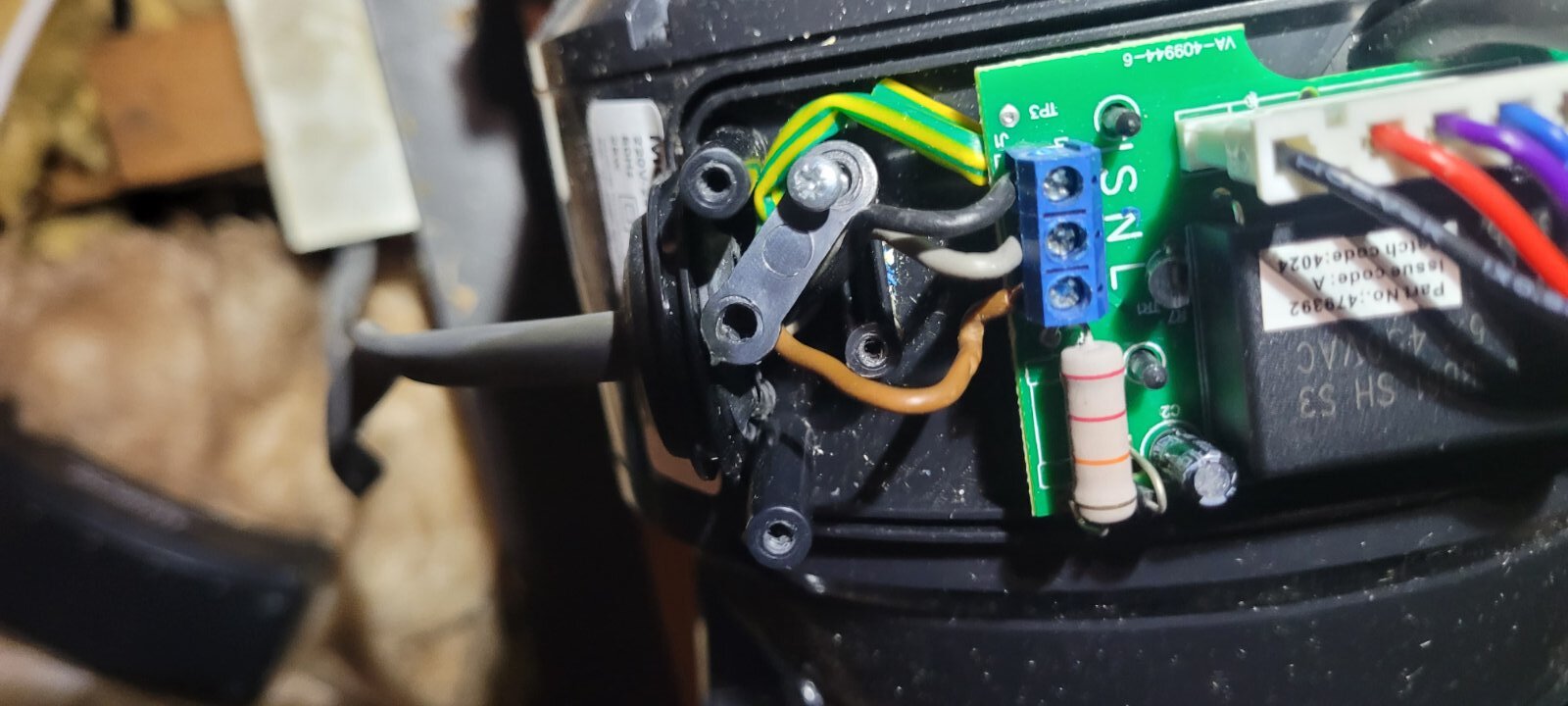

I have an isolation switch outside the bathroom and a pull switch (fan only) inside.
I turned off the main isolator and disconnected the wiring from the fan, after re orientation of the fan and ducting I wired the fan back in.
4 core
Grey (neural) to N
Brown (perm live) to L
Black (switch live) to Ls
The problem now is as soon as i turm on the the isolator the fan runs, i pul the pull switch and wait and the fan doesnt turn off.
No wiring was changed .
but so you know.
Isolator.
L1 - brown
L2 - black
N- grey
Pull switch
L1- black
L2 - black (sl)
brown is wago in back box
Grey is wago in back box
Fan
Grey (neural) to N
Do you think the fan is the issue ?
Some of the condesation got into the pull switch but this is dry now and seems to be working .
Thanks all
Are you 100% sure the Pl and Sl are the correct way round at all connection’s
Hi .
I didnt swap the LS and L as it shows on the fan , this is a pic I found online.
The brown is to L like this pic and black to LS, I'm sure they were this way when I disconnected.
Murdo
Everything I put in my 1st post hasn't been touched wiring wise apart from the fan so if you read it, it should all line up to the the fan from the isolator,
brown all the way from l
L1 to fans L
neutral all the way form isolator to the fan N
Black from L2 on isolator tothe pull switches L1 and out of L2 to the fans LS
so I'll test the pull switch again tomorrow just to be sure .
Sorry didn't attach the pic

How long have you waited for the fan to turn off?
Hi , as I've just put I've tried the fan in each position using the isolator.
Before all this , if the fan was on and I decided to override the timer I used to pull the pull string to off then switch the isolator off then back on .
(Daughter forgetting)
