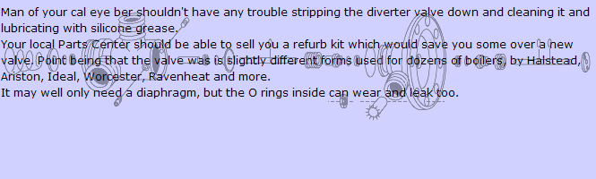

Off to the shop down the road who apparently do a kit for 16 squid. Not too bad. I will strip it down ASAP and keep you guys posted... also for the benefit of anyone else wanting to do the same.
p.s. As I have seen a fair few posts elsewhere on DIYnot about this boiler which is the Sime 30/90 (AKA Sime Holsted Combi 30/90), I thought I would post what I have learnt about the Diverter Valve in case anyone does a search in future. The part number is 6102801 which has now been superceded by 6102802. The diverter valve kit (Diaphram and O-rings) is R238. Loads of suppliers stock this kit in abundance.
Thanks again.
By the way ChrisR... very useful background graphic you put in there. Have you got that as a GIF/JPG that you can put in a post by itself without the text. (or send by email/PM)?
