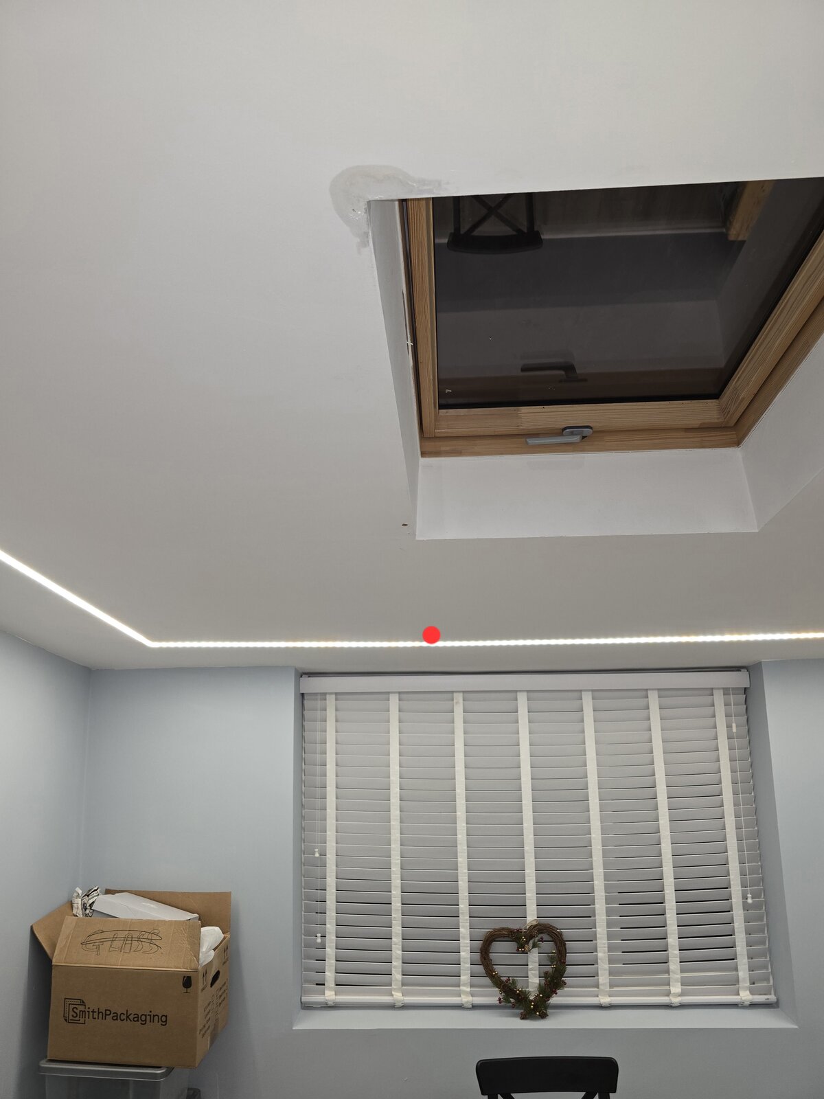

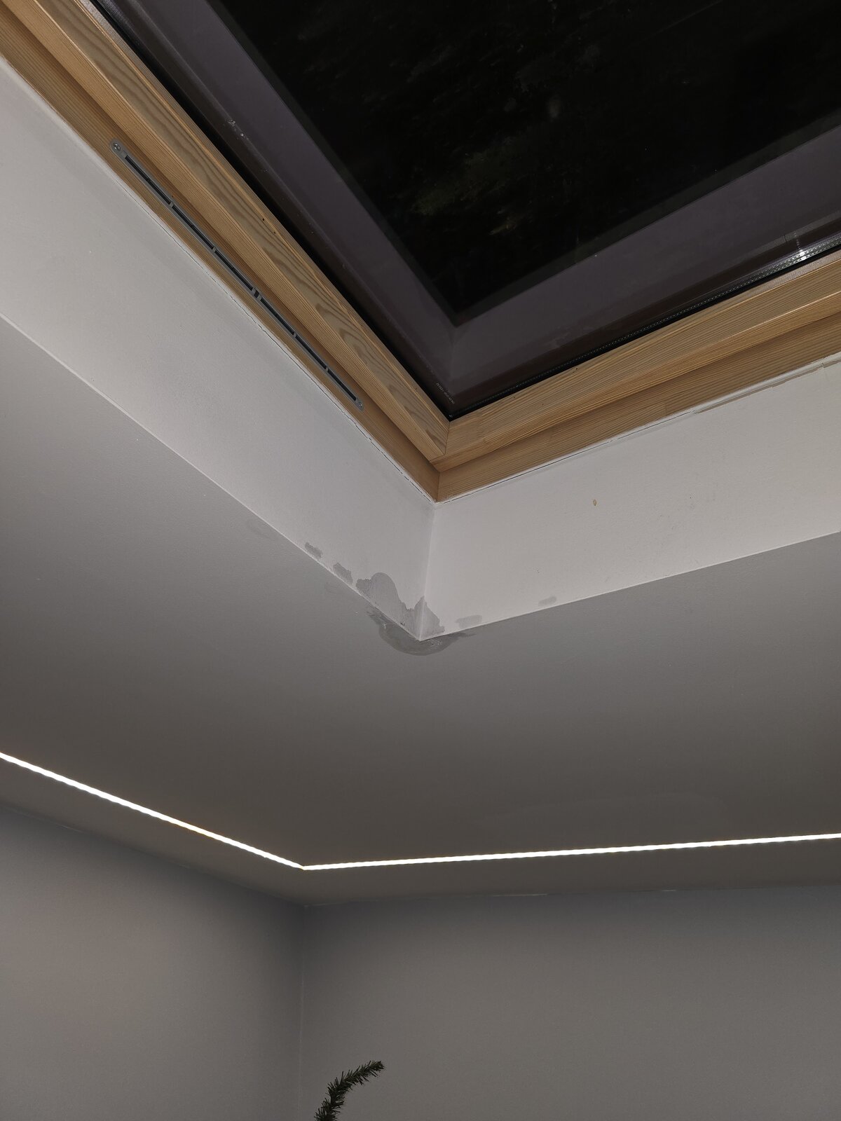

Hi all . I have a leak in the roof for my extension. It's not every time it rains , and it's only done it twice since November/December. Damp patches are only visible in 2 areas one in a top corner of the hole for the velux . And another toward the bottom of the roof where a profile is for a L.E.D strip. Any suggestion on how to locate where water is getting in?
2 pics included. the red is roughly where the 2nd damp patch usually is. Its dried since seing it this morning

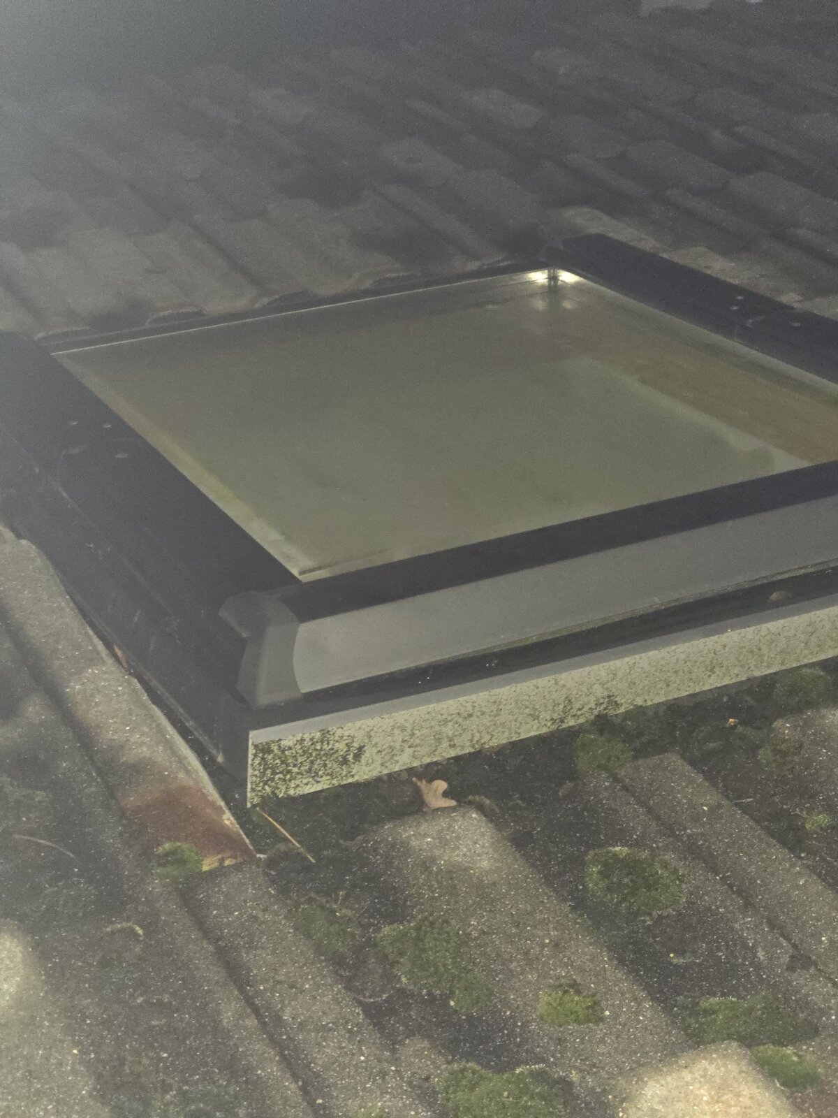

I'll try a get a picture of the outside the the velux in the morning.

You'll need to photo all the way up to the abutment. The Velux is interrupting the water, so it may be a leak further up. We make a rain deflector at the top of our roof windows in the event of a leak above.
EDIT: is yours a flattie with a curb upstand?
The velux is flat on the roof. Any pics of your rain deflector? It's bizarre it's doesn't do it every time it rains. It's rained plenty of times since we've been here but only seen this twice.
To dark to get a picture this morning unfortunately
Pitched roofs only.
It's merely a way of arranging to roofing felt so that any roof leaks above the Velux are deflected to the sides or onto the Velux top flashing tray.

Last thing I want is to go on the roof . I'm not the lightest person. I was hoping to pop my head out the velux. It's flat on the roof but not a flat roof it a lean too but 4m long and 3.8m wide
**** dark picture but tye best can do at tye moment. Does show some moss build up
