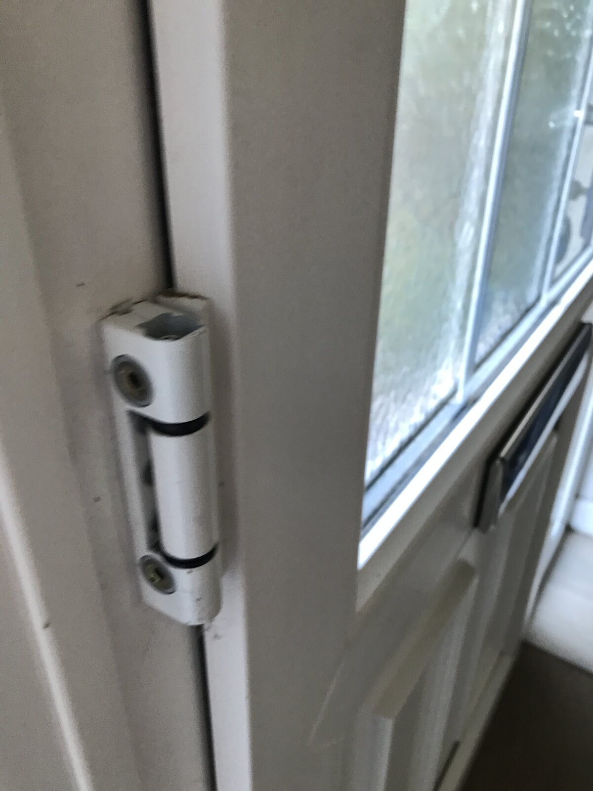

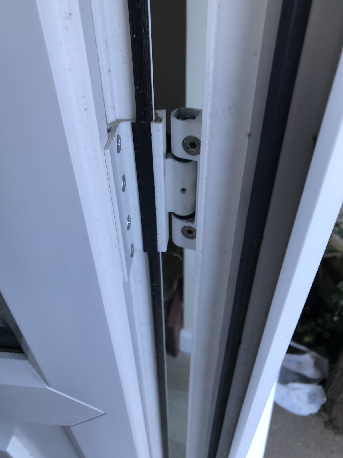

Our 6 year old Anglian front door is starting to catch on the frame above the lock. Checking with a spirit level the frame but not the door is vertical. I guess that I need to adjust the hinges to straighten it up. But each butt hinge has 6 hex nuts to choose from (plus a 7th small one). Can anyone send a link to online instructions or tell me which to adjust please?

Photos attached first from inside door closed, second from outside and open

Take a photo down the top hole, and also a photo of where it is catching
Ok, notice those 2 round gold in colour circles with a dot on them, put an Allen key it them preferably a T handle type for better leverage and on the top hinge turn them so the hinge pin moves away from the locking side, you might have to creep the pin over with a small turn of both a bit at a time, keep checking the door for clearance and for locking when adjusting
