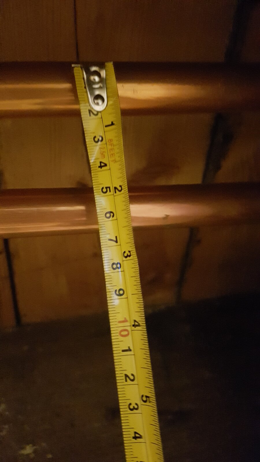

I have reworked/enlarged the WC replaced upstairs plumbing / added sink in wc / repositioned sink in bathroom /installed bath and taps etc. I used JG speedfit and a coil of the JG layflat PEX.
Anyhow, the WC does not have any heating and would benefit from a v.small towel rail radiator.
Directly accessible under the floor of the WC is the 22mm copper runs for the central heating. Boiler is a 3yr old Worcester combi. Boiler service man said it has capacity for more radiators.
I've never worked on central heating and am weighing up whether DIY is a good idea or not.
Can anyone let me know if this plan sounds ok? Am I missing anything?
1) turn off boiler
2) drain system
3) cut the 22mm pipe feed and return
4) add 2x 22mm to 15mm reducing tees
5) route the 15mm to the towel radiator
6) refill system / add inhibitor / bleed all rads etc until air out of system / at correct pressure
7) turn boiler on
Is is that "simple"?
How do I identify the 22mm feed vs return? Do I turn on heating and see what gets hot first?
I understand I may have to balance the system after.
Any glaring gaps or pitfalls?
Should I just pay someone who'll do it in half the time?
Cheers
1. Nothing wrong with your plan.
1a. You could use Speedfit 22:15:22 tees.
1b. You won't need inserts in the copper pipe, but you will of course in any plastic pipe.
1c. I assume the Speedfit PEX is a barrier pipe, which you need for central heating.
1d. You might like to think about coming up in copper to the radiator valves. Plastic is very difficult to get (and keep) absolutely straight.
1e. Don't be tempted to fit isolation valves in the central heating pipework. They are generally not rated for continuous CH temps, and will leak.
2. Flow gets hot first.
3. If your earlier DIY plumbing was all OK, no reason why you shouldn't do this yourself.

Ten bob says there won't be enough space around the 22mm runs to get 22mm speedfit tees in.
