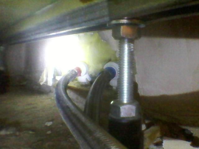

Need to do a bit of plumbing to seal of a pair of hot and cold pipes which appear to have JG fittings.
Screwfix supply both brands. The elbows had a couple of flex pipes for a shower feed which I've decommissioned and need to seal of the pipes for now.
New elbows, pipe then end stop I reckon.

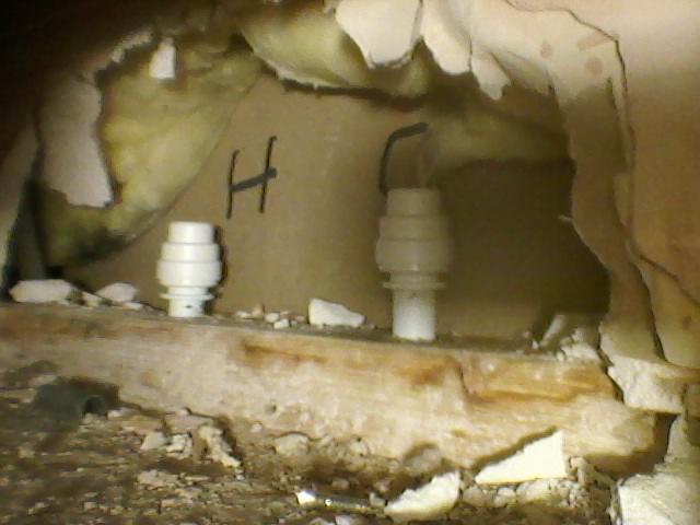

If they're JG then all you need to get is a couple of plugs for the fittings, or stop ends for the pipe. Ideally you would cut them back to the main branch though to remove any dead legs.
th
th
I'm keeping the pipes. In due course I'll befitting a Mira mixer shower to replace the silly Aqualisa Quartz I've removed.
Noted about fitting end stops on to the pipes. thanks!
Job done!
Got a couple of JG end stops since the elbows were JG and had JG inserts. Pipes now blanked off until I re-pipe to fit a Mira mixer shower.
