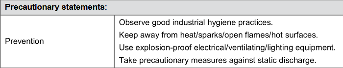

More specifically, Screwfix's No Nonsense 405 Jointing Compound (442RL) used to fill in electrical wall chase's. The product has the following Precautionary Statements: (P210 Keep away from heat, hot surfaces, sparks, open flames and other ignition sources. No smoking.P241 Use explosion-proof [electrical/ventilating/lighting/…] equipment.)
Would this be in its raw state, or after mixed and set?
The product is very similar to Easi Fill, however, that does not have the same Precautionary Statements.
I'd be interested in your views on the above.

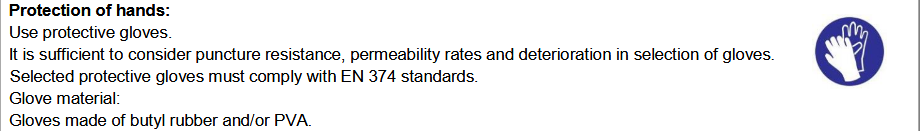

I read the COSHH regulations with interest
But it also states
and it is a very poor document,
does not seem to be inflammable,

Yet it says, "In the course of fire, formation of temperatures > 600ºC carbon dioxide and at . 1200ª C sulfur oxides may be emitted." so it would seem this is the reason for
and
but I can't really see why no sparks, but I failed 'O' level chemistry.
I read the COSHH regulations with interest .... But it also states ....and it is a very poor document, View attachment 397484 does not seem to be inflammable,

As one would expect, this product is basically just a type of plaster and what (little) the COSHH sheet says is consistent with that. The Precautionary Statement in Screwfix's 'listing' is what one would expect of a product containing volatile solvents. I suspect that either the manufacturer or Screwfix have erroneously put the wrong 'Precautionary Statement' into that listing!
