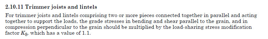

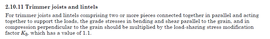

OP - the engineer who designed the beams should have done the trimmers really. There are span tables for trimmer openings and it's pretty trivial to look it up if you ask them. Usually they are doubled but I agree with Tony that the trimming joist may need a triple.
You can use K9 modification for Trimmers but you need to also factor in the grade of timber you are using and its size , c16,20,22 , 6x2 etc
See https://roymech.org/Useful_Tables/Timber/Timber_design.html
There is a complete guide to working out the suitability of a timber component...but in fairness the rule of thumb is and please do not quote me on it was add a sistered joist to all clear openings...glued and screwed at 100mm opposing centres.
Just for my curiosity, does that mean they are 10% stronger?
It means that the allowable bending stress is 10% greater. But there are other factors to consider, such as excessive deflection, and just because the beam might be 10% 'stronger', it doesn't mean the deflection will be 10% less.
In domestic floor joists, excessive deflection, rather thann excessive stress, is usually the governing criterion.
Oh I should think that's because the knots etc are assumed to not to coincide. Fair enough.
Or that the minimum and mean E value of pieces of the same timber differ by 20% or so (and hence the various allowable design stresses) and a one piece section of timber could be down at the minimum E value whilst statistically a two piece section of timber will have an overall value nearer the mean hence the 1.1 K factor. Interestingly floor joist strengths can be enhanced by the same factor but must consist of 4 or more floor joists to be applicable.
