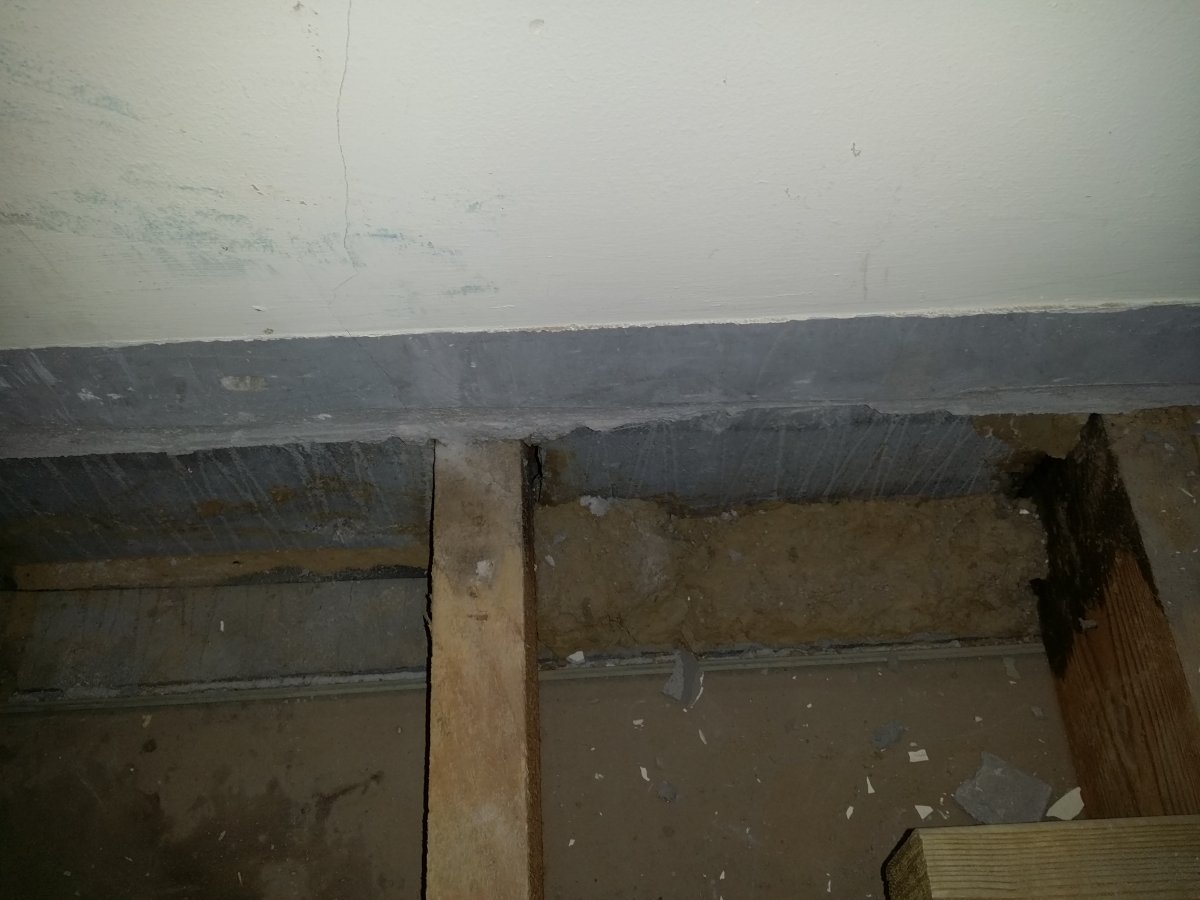

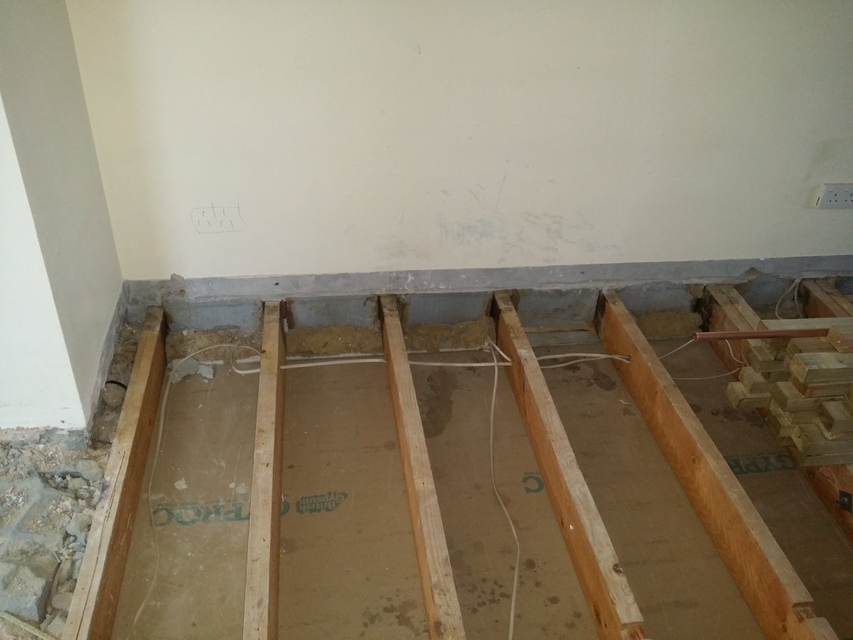

I'm renovating my property completely and want to make it as airtight as possible so I can install a MVHR. The house is two storey detached and has cavity wall in the ground floor but single solid wall on the first floor.
My questions are around the first floor joists, which they currently sit on the cavity wall as per the photos below.
- a side question first: you can see in the close up the difference between a clean top section of the wall and another one that has a lot of mortar (?) deposited on the block. Not sure why that is there but could I simply remove it so I get all top blocks "clean" and tidy?
- main question: how do I make the joist to wall junction airtight? I was thinking carlite bonding / parging on the exposed blocks and then airtightness tape around the joist end. Would that suffice? Also, would that create any condensation risk or damp issues or anything else?
Thanks in advance
That looks like a bungalow made with cavity brick walls filled with glass fibre, where some one has put a second storey on it using Celcon blocks. I would seriously do the maths on the upper wall and see how much its costing you in heat loss. Is the building rendered and painted? It looks nice and dry, but cavity walls are usually have to vent into the loft, albeit slightly, so sealing the top of your one would not be reccomended.

Frank thanks for the response. It was built like that, i.e. as a double storey with these walls, 30 years ago. I plan to insulate the walls externally next year as they're not rendered -just the original brick although the first floor has tile cladding on top of the brick.
What you say adds significant doubts to my airtightness approach. If I can't seal those junctions, I don't see much hope :( any suggestions on how to proceed from here?

An MVHR system doesn't require a house to be that airtight. It's designed to remove damp air, recover the heat from it, and transfer that to the incoming cold fresh air; it's not designed as a completely sealed system, and any leakage won't be that great round the joist ends.
Thanks to all about the replies. There are some conflicting opinions though so I don't feel any wiser :(
I'm leaning towards sealing the gaps to make them airtight and then leaving access or potentially installing wood moisture sensors to track the joists' health. Next year I'll insulate externally all walls which sounds like the best end state to be in.
Any strong objections or further suggestions?
Sorry, but why do you feel you need to seal the airgaps to be able to install an MVHR system; it's akin to a heating system, and that doesn't require an airtight house.
Because the system requires a certain level of airtightness in order to operate efficiently. If the house is leaking so much from that first floor void I may as well leave a window open -which would make the MVHR system pointless since you no longer have controlled ventilation.
I can see where you're coming from, but I suspect you're worrying unnecessarily. If you had bare floorboards on the first floor, then you'd get fair amount of leakage through the joist ends, if like most people you have carpets, then you'd still get leakage, but at a reduced rate. The concept of an MVHR system isn't to heat the property, but to recover the excess heat and moisture being taken out of the damp areas, and then transfer that heat to the incoming fresh air. The warmed fresh air that moves through the property will get moved into rooms that do not normally then get transferred back to the recovery areas. What system are you intending to use.
