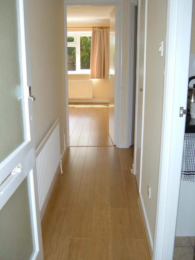

Just wondering if I could get a couple of quick tips? The laminate I’m fitting is drop and lock. I’ll be getting a jigsaw and decent blades and possibly one of those laminate tool starter kits with the spacers and tapper and stuff. I was just wondering from the picture where in the room would be the best place to start.
I was going to run them straight down from the door and not across as I reckon it would be a nightmare to do it across. I was going to start at the front door and run down. If anyone has any recommendations would be glad to hear them. Are there any other tools which might prove useful?
Also when fitting them against door trims at the bottom do I run it straight up to the trim or leave the gap around the entire room? Just a lot of videos online show people cutting into the trim and sliding them under. I can’t do that as my place is rented and if I cock it up ill have to pay to fix it.
My other concerns are your supposed to lay them as such the groove facing into when you’re laying and the tongue side facing the wall. However if I was to start at the right of the front door when I get to the left of it at the wall do I adhere to the rule and lay the groove side facing the wall or do I have to break that rule and flip the board round and have the groove facing the wall.
After posting those pictures I actually worked out it would most likely be best to start at the top left of the door and finish in the bottom right corner. Still any recommendation I f im wrong.
I also see another problem is when I get the bottom part of the hallway with the board that comes from the right of the front door. Do I have to flip the side around as the tongue side wouldn't connect to the right section of the hallway?
Would appreciate any tips actually though I only needed to ask a couple of things but apparently that’s not the case.
Also when getting up to a door separator say laminate to vinyl do i leave a gap between bot materials or go right up to the material in the other room?
