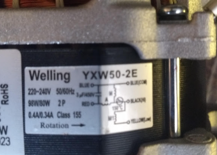

Yeah, it does seem odd, but here's the wiring diagram from the motor itself: Blue(Com), Black(Hi) and Yellow(Low), but maybe I'm misinterpreting the labels. There's also an earth wire attached to the motor body.
That doesn't look like a drain pump motor.
It looks like the main motor, the wash motor.
The pump motor will likely be fitted into a rubber drain pipe at the lowest point and much smaller than in that photo.
