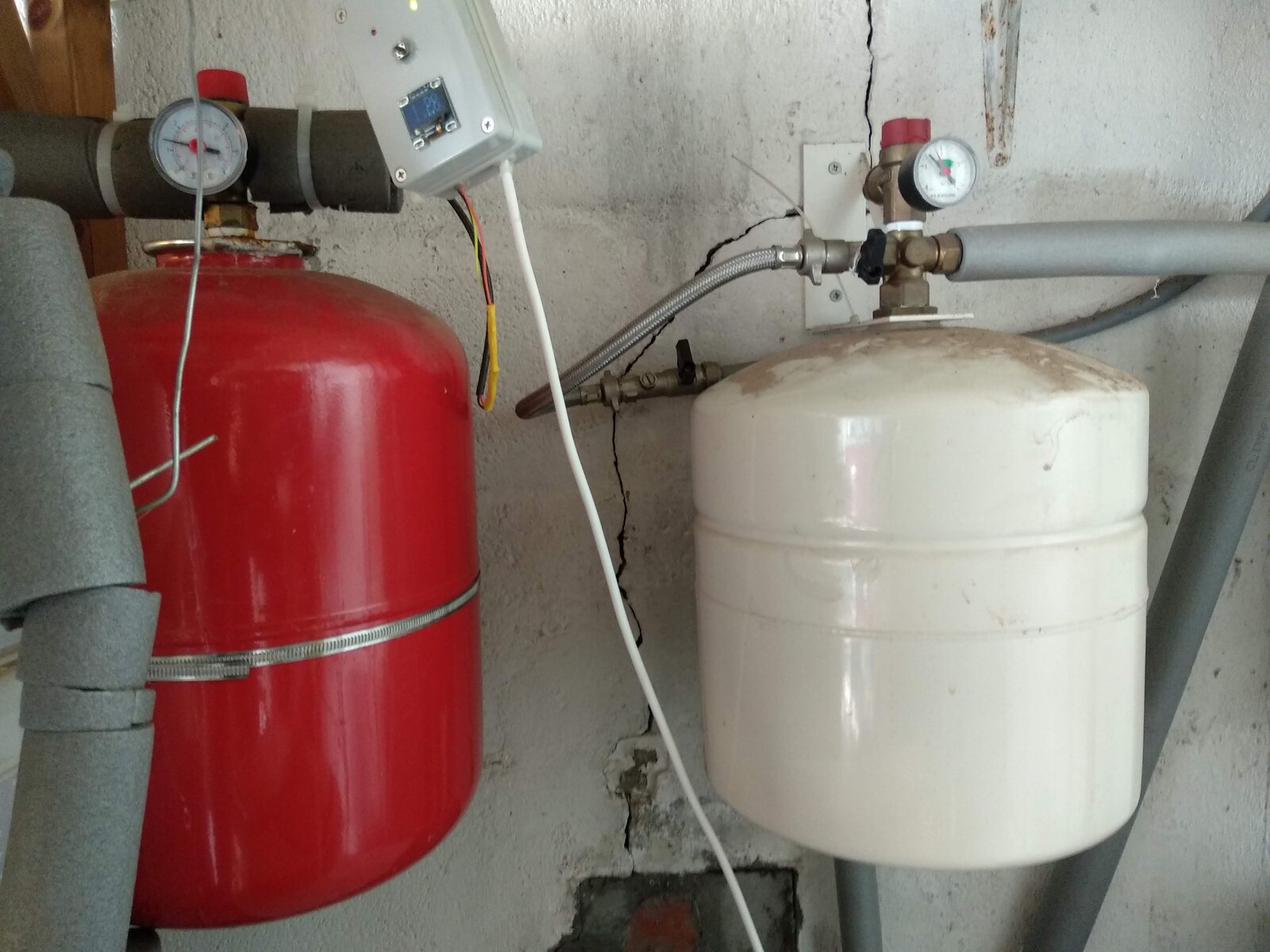

We have a Grant Vortex 36Kw combi keroscene burning boiler,
which has two expansion vessels fitted to the heating side of the boiler.
Recently we added a bit of pressure to one of the expansion vessels.
Since then the boiler has stopped producing the by-product water that's produced when you burn keroscene.

You say you added some pressure to one of the expansion vessels. What was the reason for doing this?
Brother who is heating engineer suggested it might be the source of the de-pressurisation problem.
I did'nt think so, but went along with doing it anyway, becasue I'm out of ideas on this long running de-pressurisation saga.
What did you do to achieve it
Got the air pump out and added some pressure on the schrader valve at the bottom of the expansion vessel.
The pressure seemed to be Ok at about a bar, before I added air. I topped it up to about 1.5 bar while the water heating circuit was de-pressurised, so I might let the air out again and bring it back to a bar, and see if that fixes it.

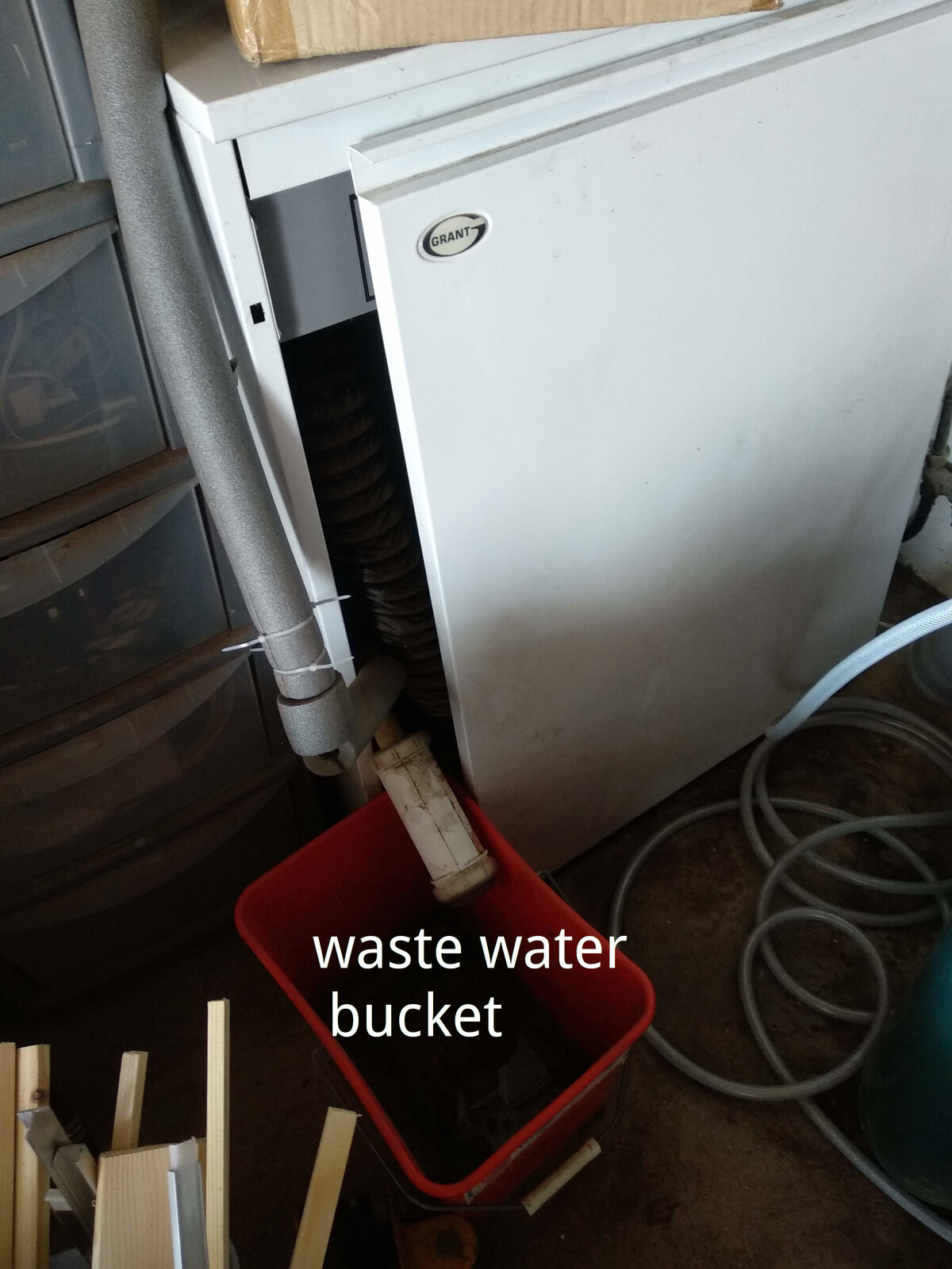

Where is this "by-product water" coming from?
It comes out a pipe inside the boiler & goes through the white cylindrical thing shown sitting astride the red bucket, it goes into, shown below.
It's just a drip drip burn off water feed.
It is supposed to do this.
I never got round to digging a connection to the drain for it hence the bucket.

1. Assuming that the water "by product" is actually the condensate.
2. As Lower suggests, possible blockage in the condensate pipe run. Try removing that white plastic thing from the end of the condensate pipe and see if it makes a difference.
3. If you have set the boiler to run hotter (i.e. the return temperature is greater than 55 degrees), it won't go into condensing mode, or at least, not as much.
I have tried removing the white plastic thing.
Removing it does not allow condensate to flow.
