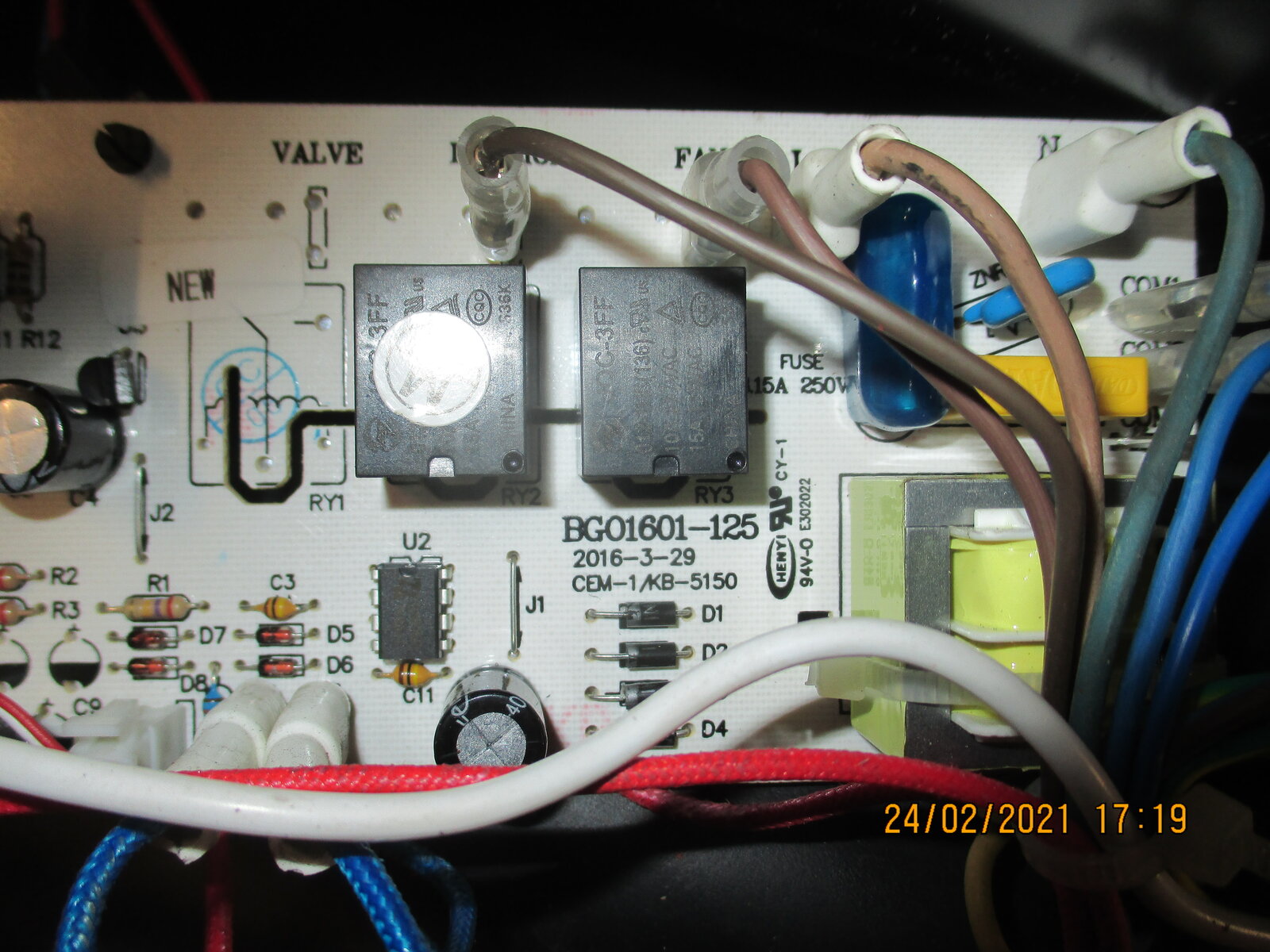

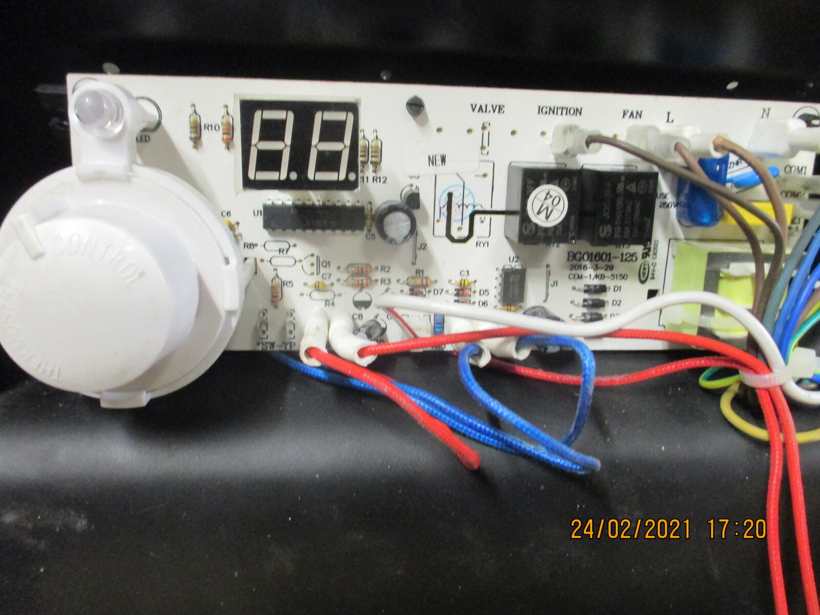

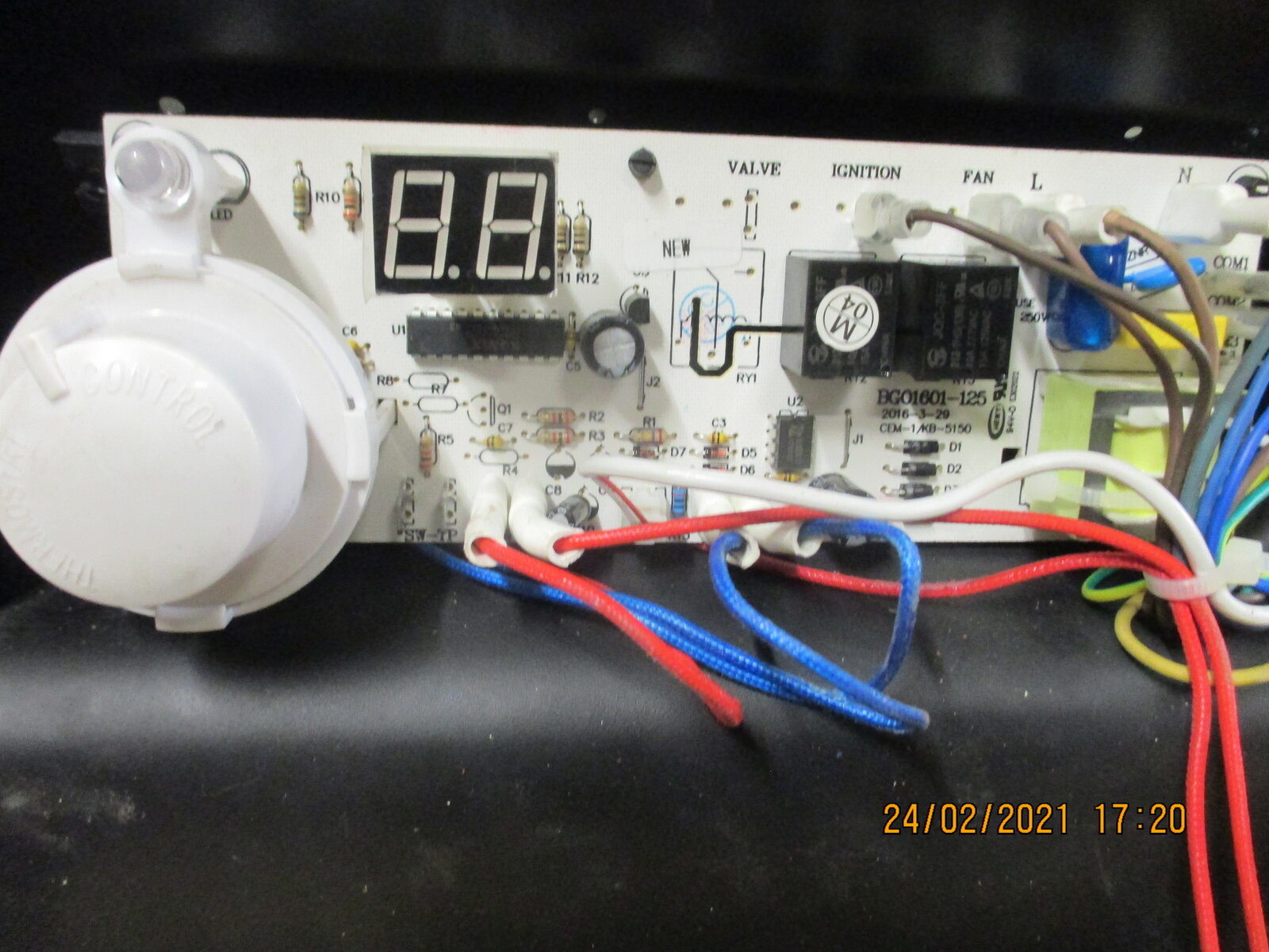

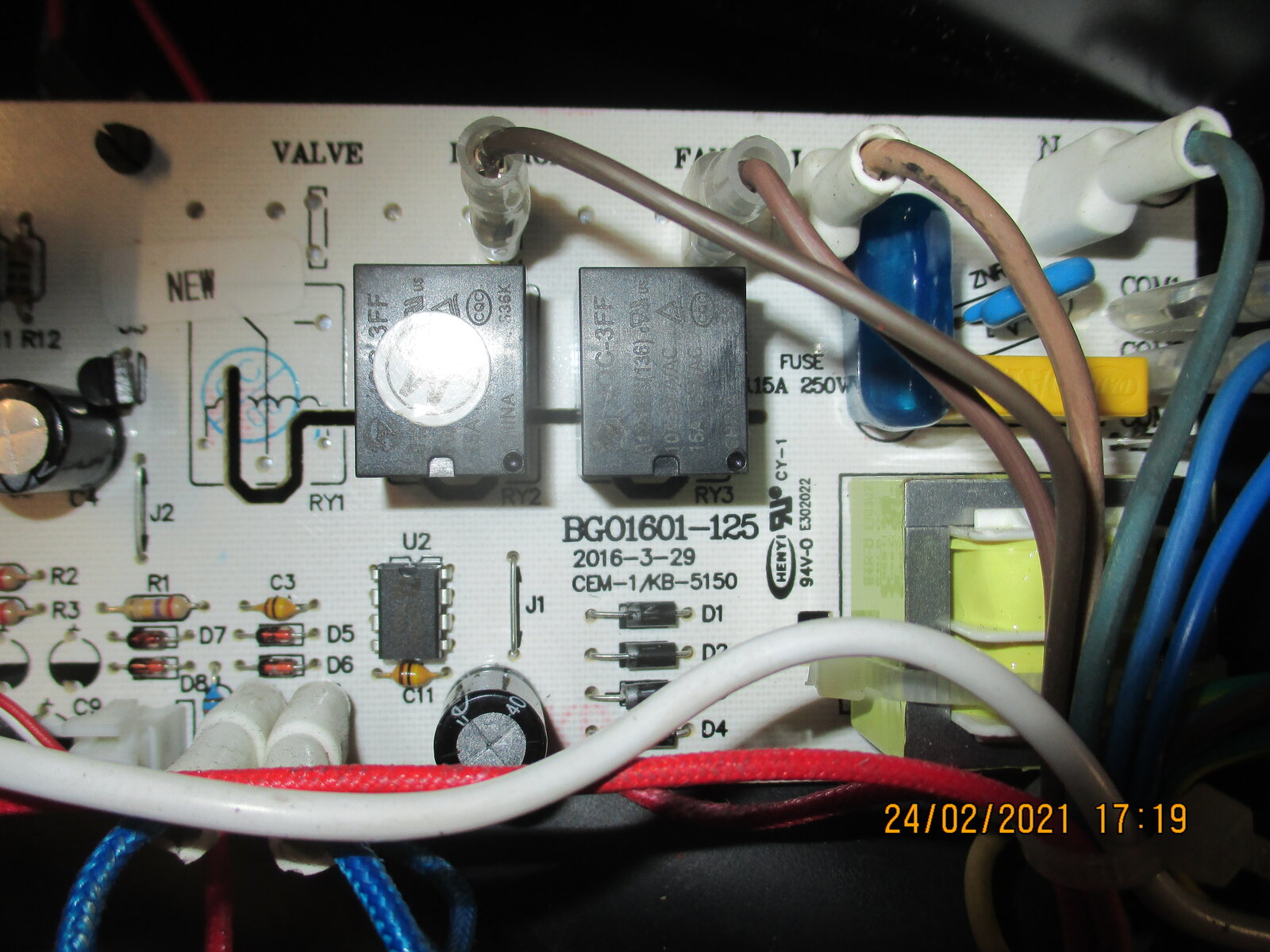

I have a Dirty Pro Tools 30KW Kerosene space heater - practically un-used but out of warranty. The circuit board BGO1601-125 seems common to lots of Brand Names. See picture
Last time I went to use it although the temperature LED display lit and showed the correct ambient the LED lamp above the thermostat did not light wherever I set the 'stat. The heater did not run at all. no fan - nothing.
I checked the fuse on the PCB and it was fine.
I checked the Thermostat at the back on the PCB and it seems to be switching.
I checked the safety stat on the burner and it shows continuity so is probably healthy.
It's not any of the usual fuel or firing problems because it does not attempt to start.
Can anyone help? - Does anyone know where I could get replacement PCB assy etc?
What else should I check?
