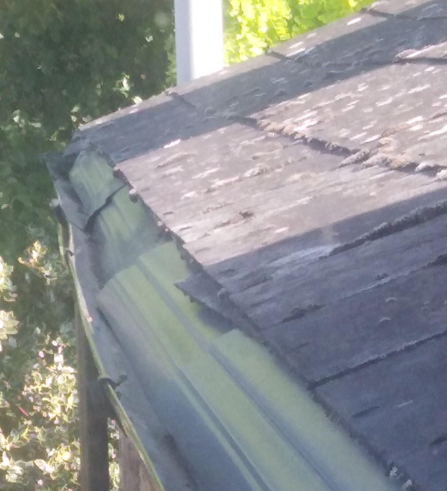

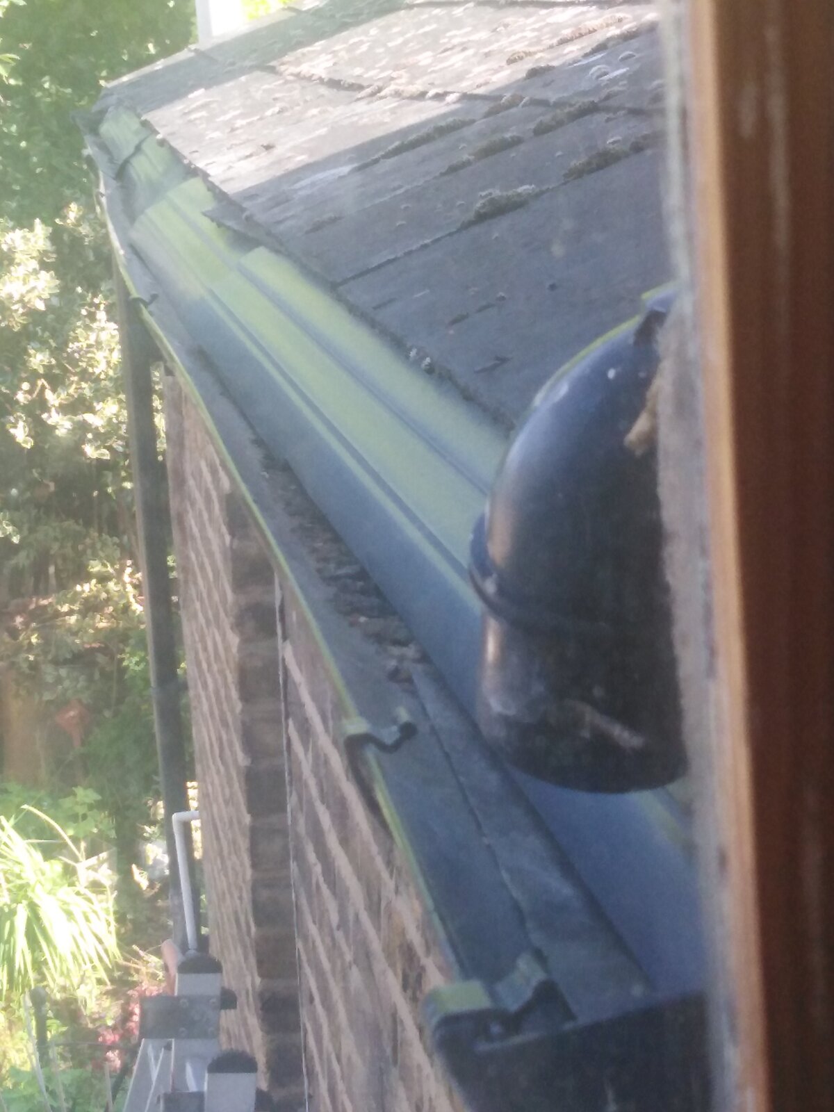

Think I have just been ripped off yet again by roofers. Had water runing behind gutter from roof and down wall. Given quote of £350 to fit Kestrel Eaves which I understood to be secured under tiles and to each other so water run direct from roof to gutter.
They turned up 8 hours late in pouring rain and spent 45 minutes "fitting eaves", took the money and left, also quoting £550 for replacing two tiles and re rendering around the chimney stack.
Next time it rained water was leaking down wall behind gutter in 3 places and it seems the kestrel eaves had not bee secured in any way to the roof or each other just tucked under the tiles and laid loose in the gutter
I am not a roofer but an old painter and if fit enough would like to get up and do a proper job. I can leave them a lousy feedback on Mybuilder where I found them but where the hell can I find a decent roofer or gutter repairer in South East London who wont rip me off ? This is the third time it has happened with roofers, no other trade. Company called LM Doe of London and Devon.
So am I right, they should be fixed to the roof and each other and was £350 a rip off for 45 minutes work for one man working and one watching ? I attach two pics so you can see the "workmanship".

Hmmm, London and Devon eh? That must mean they "travel" between the two. :cautious:
Those are eaves trays or felt support trays, 'Kestrel' is just the make, but yes they should be fixed to prevent what you have there happening, but that involves removing the tiles and more time and effort. Also, the felt may well be rotten and ripped under the tiles, and if so that could allow water to leak down the wall as you are experiencing even after the trays are fitted
The trays are about £2 each, so yes you have been scammed.

I asked for them to come back and do it properly or I will leave them a negative feedback with all the info on the rip off and report them to trading standards & my money back. They have agreed to come back Friday and "put it right" although it needs to be done again not "put right " I found a load of plastic strips where it seems they had cut the supports so they could just slip them under the tiles rather than lift them and fix them to the eaves. I am learning lot about guttering and roofers rip offs. Never had a roofer who hasnt tried it.

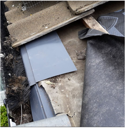

I came across this recently. Working on the house at the bottom of the photo (fitting eaves trays :rolleyes:), the adjoining house at the top of the photo had had the usual "Clean your gutter squire? Oh, and how about something to stop the gutters blocking and you need your felt replacing ... but we can fit these new plastic trays at much cheaper cost" people around previously.
You can see that the gutters are still blocked (and you should see the path below). But what do you reckon about the eaves trays? :cautious:
Anyone got a photo of the trays fitted properly so I can show them what they need to do before I agree to the job being OK ? Thanks
You need to take 2 or 3 rows of tiles of to do job properly, I think my roofer took 3 hours to do front and back properly.
I had them fitted to support the sarking really but the do guide the water into the gutters.
If you thing about how the water runs down your roof you are probably worse of now with them badly fitted..
To be fair , no water should be on the top of the felt..
The trays are wrong, it's going to take some time to remove this roof covering and replace properly.
