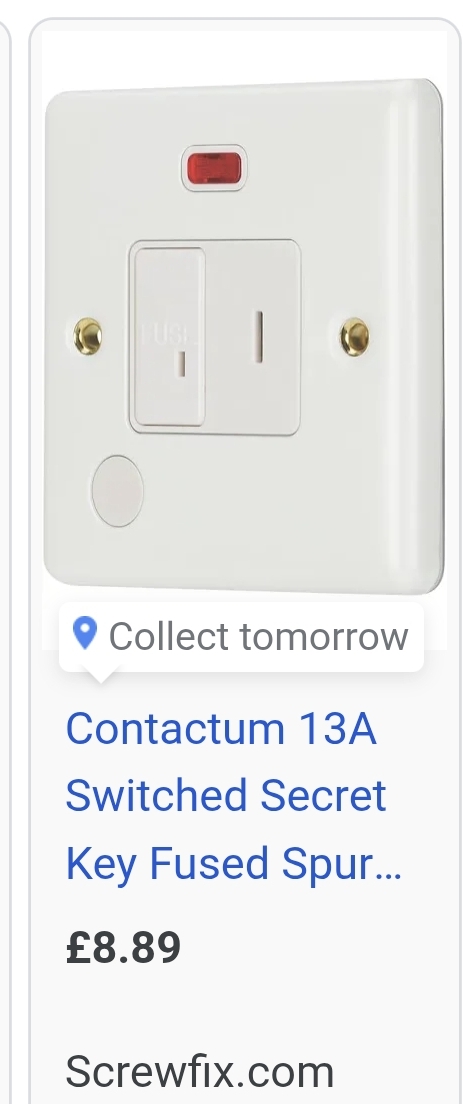

I do wish they would stop using the word "Spur" inappropriately.
A spur is a type of part of a circuit layout.
A Switched (or Unswitched) Fused Connection unit is FCU or SFCU if you like, it is not a "Spur".
Ooh, it makes so so angry that I could crush a grape or rip a tissue paper in half!
I had to fit a supply for a new boiler so I thought I would run a spur from the nearby ring.
The supply required isolation and fusing down so a spur was needed.
I fitted the spur to the ring and ran the spur to the boiler.
Although the spur is 2.5mm² T&E I thought I may as well put a 3A fuse in the spur.
For some reason people think a 13A fuse in the spur protecting a spur to a boiler is not acceptable.
Of course, were the spur supplying just one socket then a spur would not be required but more than one socket on the spur then a spur is required.
It is strange that sockets, flex outlet plates, double-pole switches etc. and these
are not called unfused spurs.
That many people do something is no recommendation nor justification to do the same.
