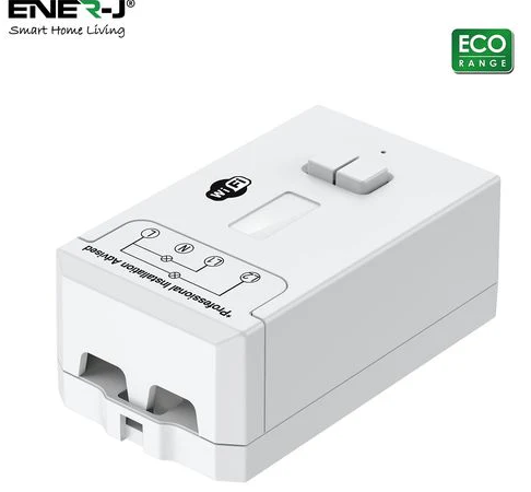

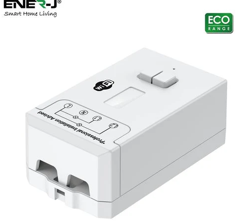

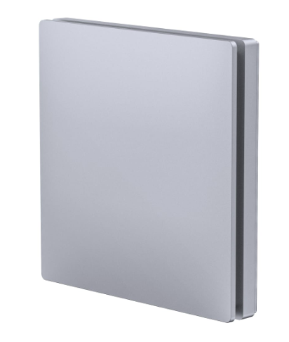

Managed to have a better look today. The ceiling rose is in an awkward position so I’m more inclined to deepen the back box and use a a switch with the built in receiver. Then add a few more switches as/where needed.What I am referring to are slimline switches with a seperate receiver that goes elsewhere - it will not fit in your backbox.
However, if you have a large hole above the ceiling rose/fitting it will fit above the ceiling (you'll get told to put it in a box with cable restraints etc.)
This is the same as the switch I have:
This is the receiver:
Available from https://enerjsmart.co.uk/
Be aware that going down this route is going to cost you a lot more than a simple £2.50 switch does.
The above switch is £18 and the receiver £26-35.
However the Quinetic range appears to be cheaper now and there are switches with inbuilt receiver.
Although this appears as it's no different than having a switch on the wall, what it then allow you to do is use additional separate switches anywhere without wires. You do need a deeper backbox though.
With all of these you also have options for google/alexa wifi smart control etc.
So you can setup a schedule to turn the lights on/off when not in, if you put them in the kids bedroom you can even be a rotter and make them auto turn off at set times lol.
