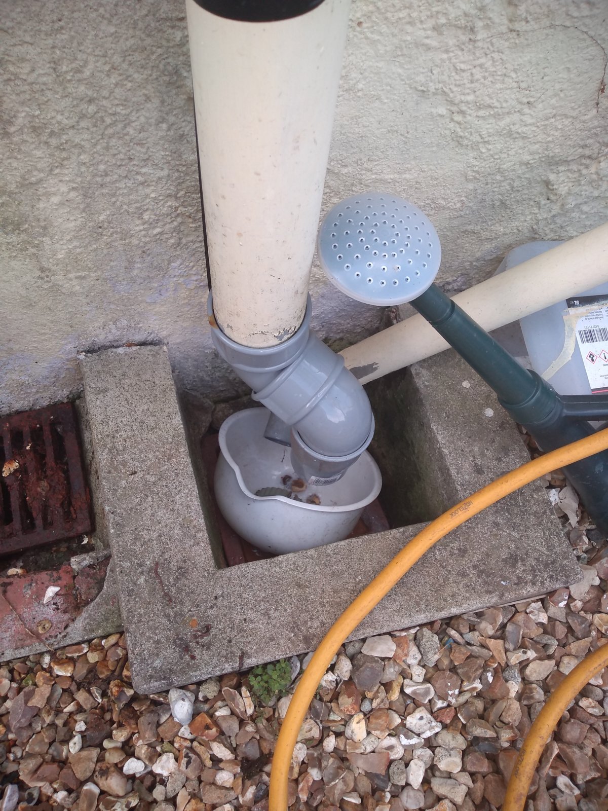

Hi again need some advice on more drainage. This time it's kitchen sink and bathroom. As you see from picture it's a sorta quick fix and is better than what was happening. My idea would be to rise the hole up using https://www.screwfix.com/p/floplast-d504-square-hopper-gully-grid/13687 or I could add pipe to the bathroom outlet so it's nicely in to the hole and cut a hole in to that so the kitchen sink can go down that. I'll show a pic of washing machine drainage later as that's in utility/shed.
But guy what would you do?

I can't see what your problem is. What's the dish thing for ?
what happens when you dont have the bowl there? did you put it in to wash it :D
i like your idea and i would smarten it up sort of how you said
the idea of a grid is to stop items going into the trap part...so make your pipe entries neat
centralising the large pipe would look neat with the sink waste in the back corner
it would be good if you could get a large top grid to cover the concrete surround..you seem to have a cast iron grid there...is it for the rebate at the bottom of the concrete drain surround?

Sorry guys shouldn't have typing when trying to sleep. The bowl is there with a cutout so most of the water goes down the hole. Without the water goes round and the house wall is green in there. Also a bit of mortar is missing so water was going down the side. So what I need to know what is best solution?
My idea is again the square thing on the link above with a 5in bit of tube to extend the height and then also probably extend the brick guard if needed
You could extend the gully up or the pipes down.
Is the gully that’s there now round or square inside?
