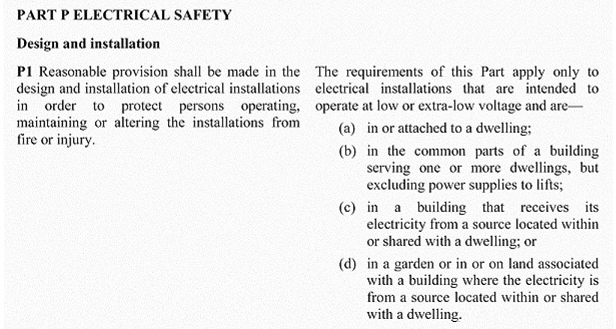

My kitchen has a ring main, in 2.5mm2 cable. It was installed in Pre Part P days.
The appliance loads on the ring are:
Dish washer 2.4Kw
Fridge 0.25Kw
Tumble Dryer 2.5Kw
Microwave 1.3Kw
Toaster 1.6Kw
Clothes Washer 2.3Kw
Kettle 3.0Kw total 13.35Kw = 58A @230vac
Now I know these figures are maximum ratings from the appliance rating plate, (fridge figure is a guess) and it would be unlikely that all the appliances would be in use at max power together.
How would you go about designing the installation to the current regs?
Regards, Rich
Do it exactly the same.
A (32A) socket circuit, whether ring or radial, with any number of sockets is just that.
What else can you do? Limit the number of sockets to two?
It is up to you what you have working at the same time.
If you should happen to overload the circuit then the fuse/MCB will disconnect the supply before the circuit is damaged.
Part P merely states that the work shall be done to ensure safety.
That's it. There is no more.
