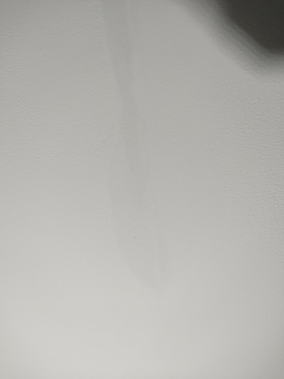

Hello everyone,
Have run into an issue with a kitchen ceiling that I have been painting and wondered if anyone can give some advice / guidance?
Hairline Crack across ceiling.
Gently made crack bigger.
Put some dilute PVA in. (This was a bit mistake that I didn't know)
Then used Easifill 60.
Crack disappeared.
Sanded Back entire ceiling with 180 abranet & vac.
Washed with microfibre cloth, warm water and a few drops of white vinegar.
Painted with AR2.
The rest of the ceiling looks fine however I can't get a uniform finish.
In hindsight I could have tried a Zinsser product before the filler but it is what is so grateful for any suggestions?

Are you talking about the colour mismatch? Or, an uneven surface?
It's possible that in sanding it back, you've re-exposed the pva?
Perhaps use a blocking paint and then paint blend-in with the rest of the ceiling?
Have you determined why the crack is present? Are the boards loose?

Looking back at the photo please ignore the top right dark spot as that's my finger covering the lens!
I am actually talking about both now you've pointed it out. :/
It's almost like I want to add some roughness (as produced by the roller along the rest of the ceiling) to the smoothed filler whilst also ensuring the colour is uniform.
To be honest I am finding working with filler to be a fine art. I have just picked up some 123 to see if that helps.
The original crack was hairline and the boards are not loose. Crack took 6 years to appear after being newly skimmed and I put it down to settlement. I should have probably asked on here / tried an alternative method before jumping straight to PVA and filler.
