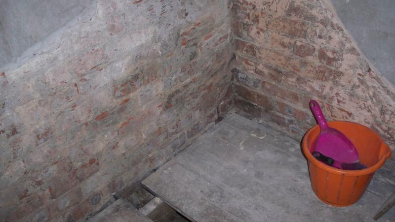

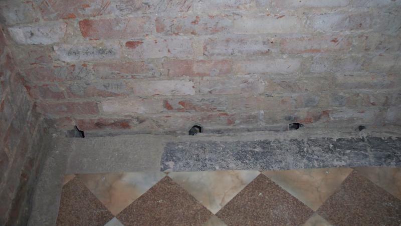

Another problem on this 1937 ex council house
As I have mentioned before it was half renovated in 1976 and as well as a bathroom ext downstairs they have concreted the back kitchen floor to the same height as the living room floor which is wood suspended.
The damp course is 2 bricks below the wooden floor and also below the concrete . This also goes for the outside wall where there is air bricks which are below the concrete doing nothing. The concrete goes from wall to wall, no gaps no water proof membrane and the damp goes up the wall 3 feet. Do you think the damp is a result of the concrete floor?
If I have to take it up and dig deeper then hardcore, sand, waterproof membrane 100mm polystrene then concrete to match living room floor . How do I get over low dpc ??
I really need to maintain this floor level
Please HELP

3 walls affected 1 single brick inner wall
1 outside wall double brick with possible cavity
1 wall between us and next door and they have damp also same problem old renovation done by same builders in 1976

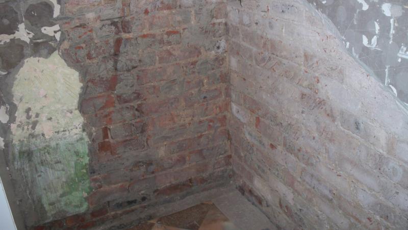

the plaster went straight to the floor I have removed this and the wall behind is damp for about 2 foot
cheers
took these pictures showing the concrete floor in back kitchen and wooden floor in living room also shows the height of damp just below where I have removed plaster
