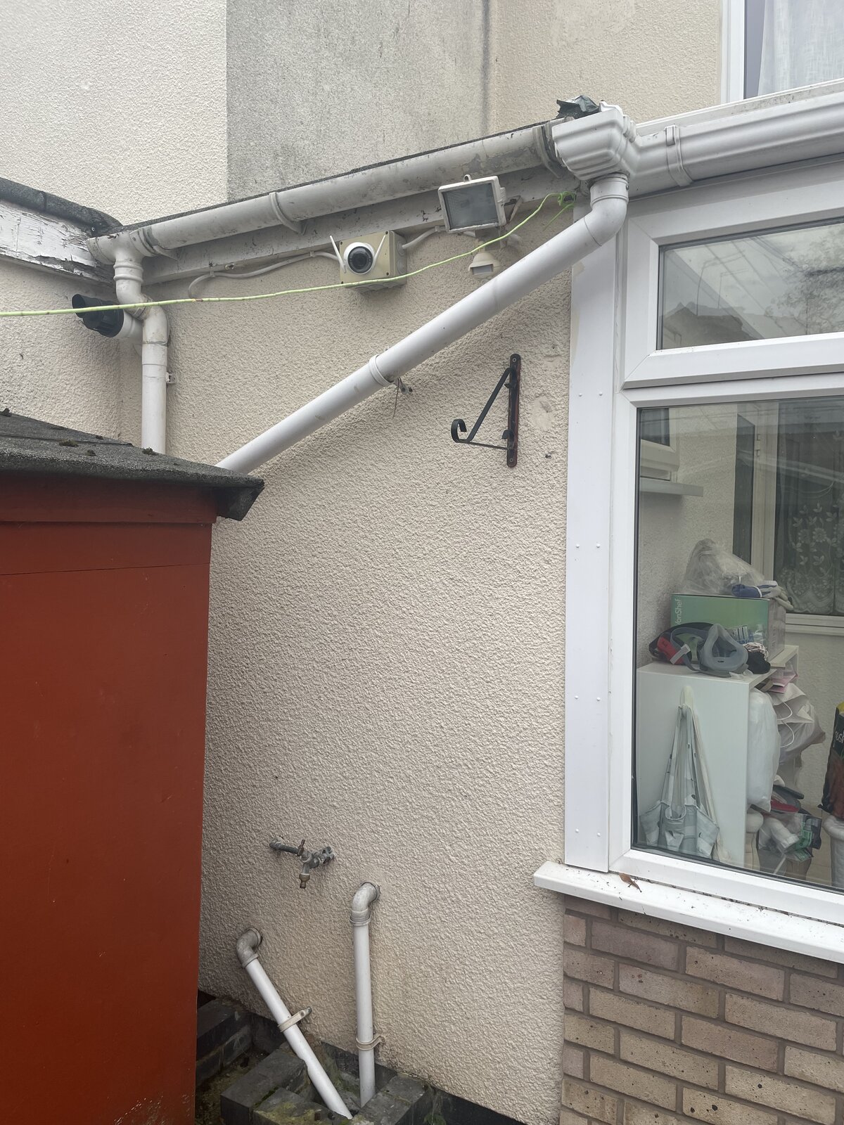

I have now completely ruled out the option of going into the kitchen ceiling void and the directly out over the flat roof as I would have to drill through the flashing
The other 2 options I have left are:
1) running the lenght of the utility room (there is a handy false ceiling), but then go down and towards the centre of the wall to avoid the gutter and the boiler flue

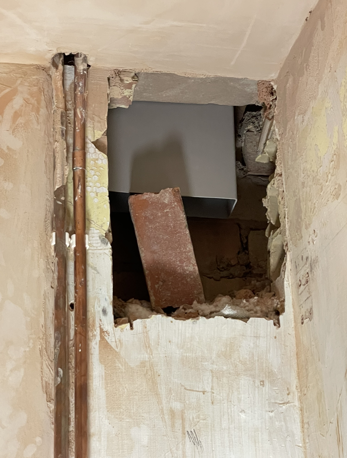

Yes, that's the sort of thing, you might just need to bash a few bricks out of the way till you can get something in. This is mine, 54mm ducting just fits between the joist and the wall, I didn't actually need to go up the cavity with this one as my cupboards will hide it.
does is split in two pieces and you fit one from the outside of the wall, one from the inside and then you join them in the cavity?

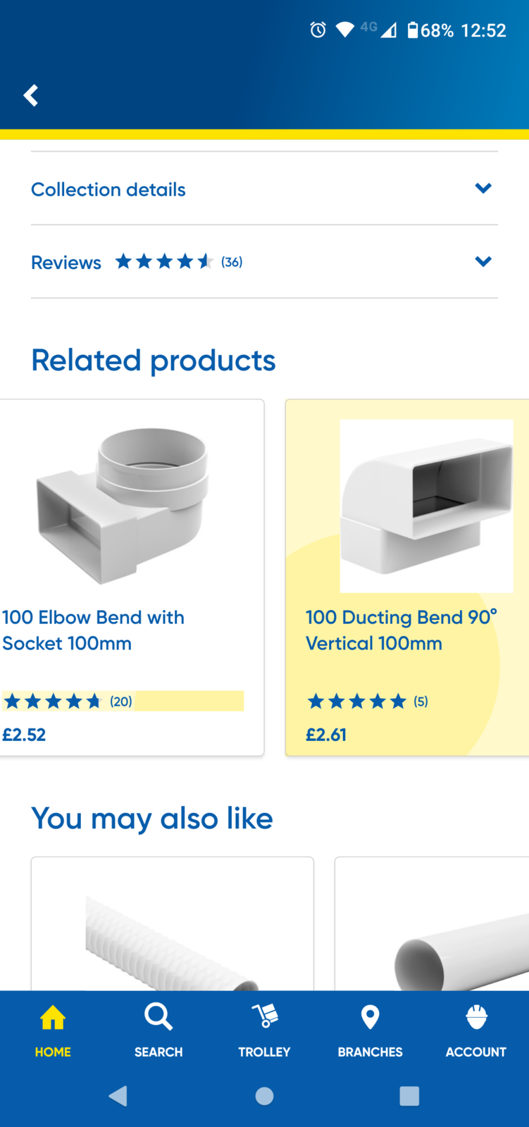

That was 2 lengths of 54x100 ducting - one up the wall, one pushed through the wall, connected into a 90° bend , at the bottom is a round to flat channel adapter. As I said earlier a bit of brickwork might need to come out to get something in.

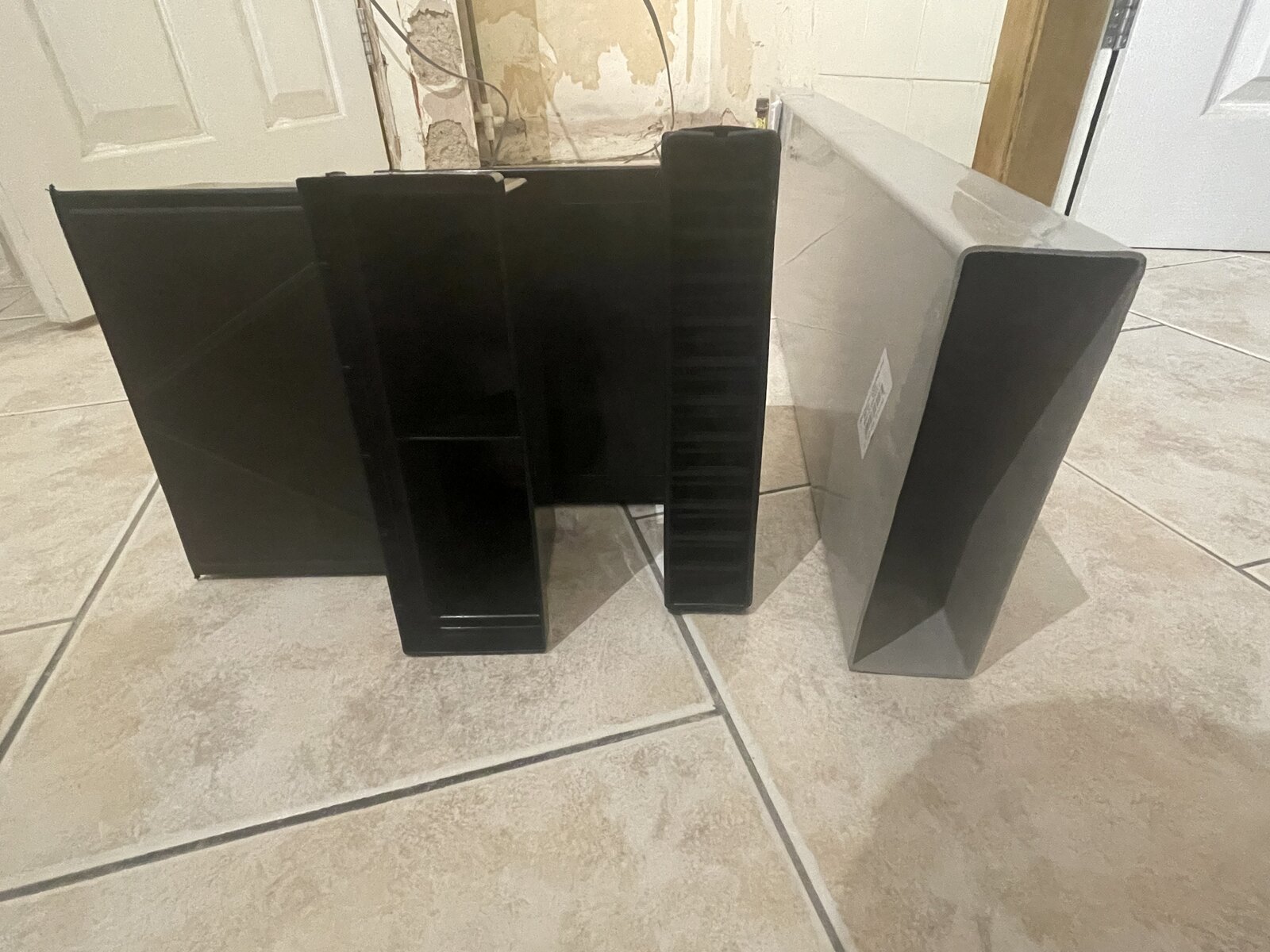

This is the telescopic underfloor vent kit from ScrewFix (next to a 240x60 rectangular duct)
I’m not convinced this would be suitable, there is no seal between the two parts and the outside section has a smaller cross section
Take the black one back and buy the bits from Toolstation to make up what fits your job.

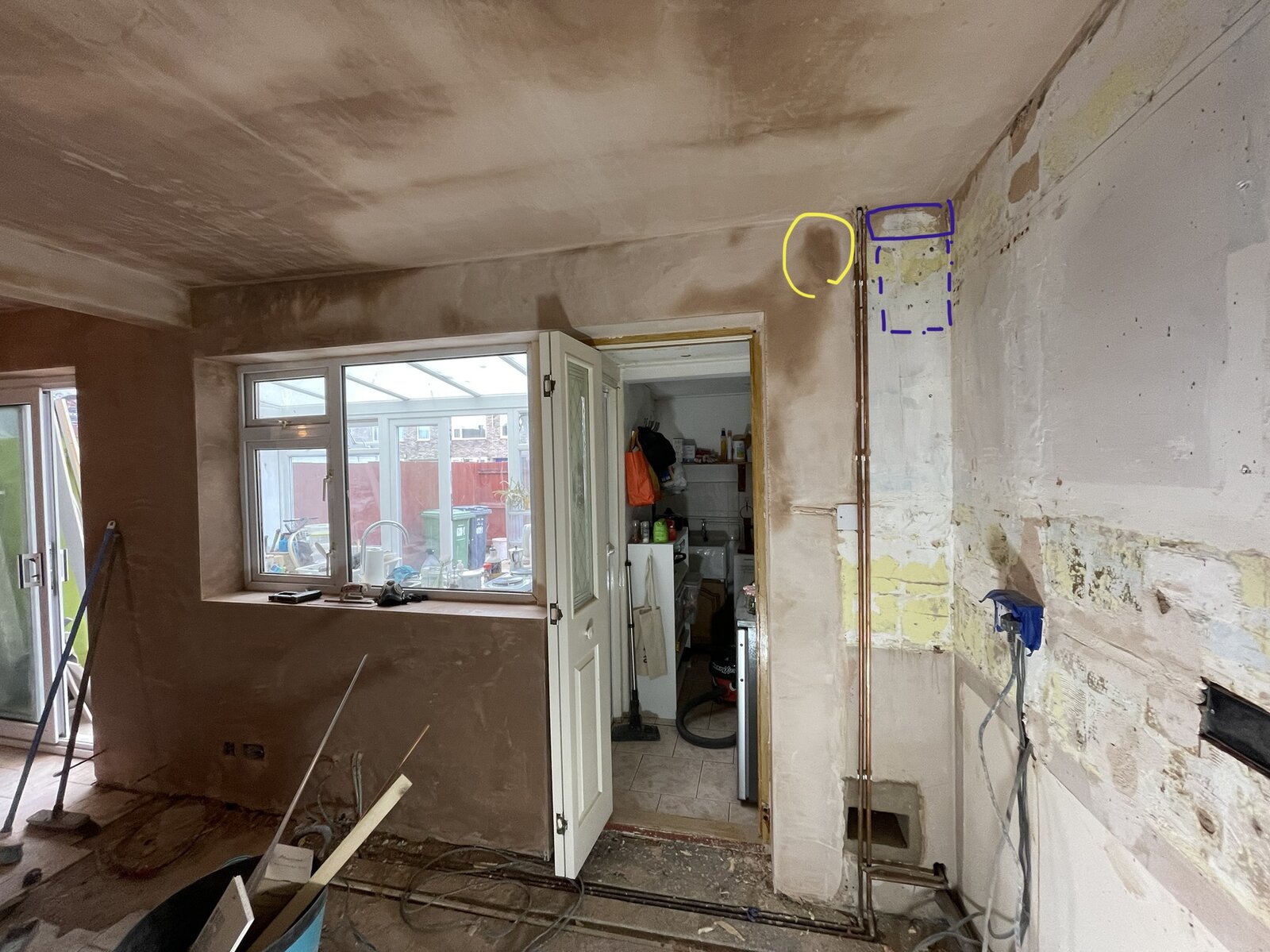

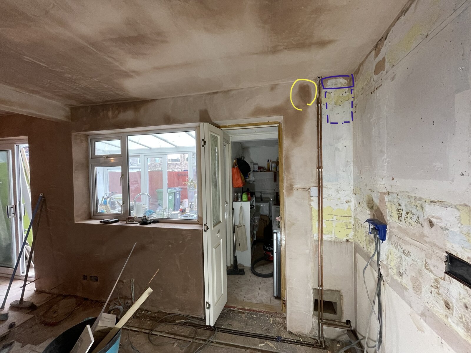

Do you think it’s fine to cut a rectangular hole highlighted by the purple line to insert a rigid section of duct in the cavity?
The damp patch of plaster circled in green is where a hole has already been cut to allow some heating pipes to go upstairs
To the right is a party wall to the adjoining property
To the left there is a lintel over the bifold door and the window

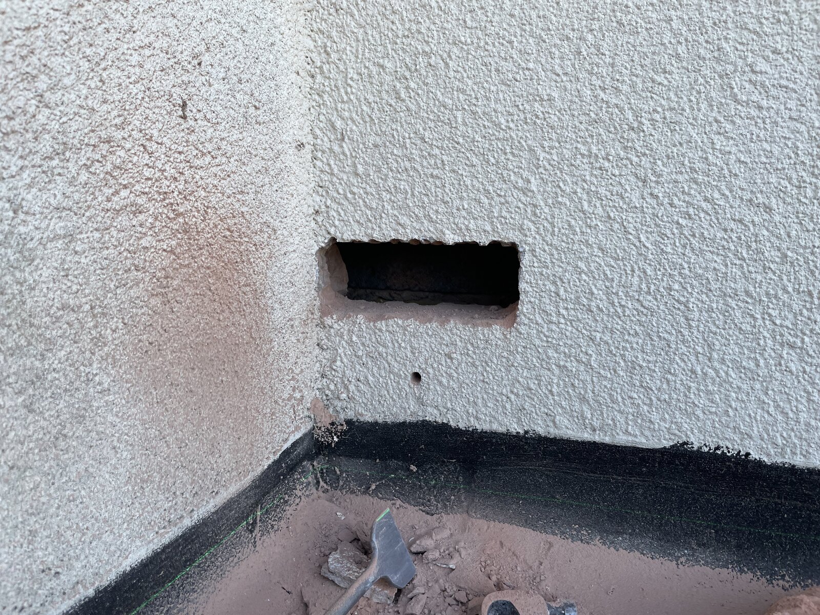

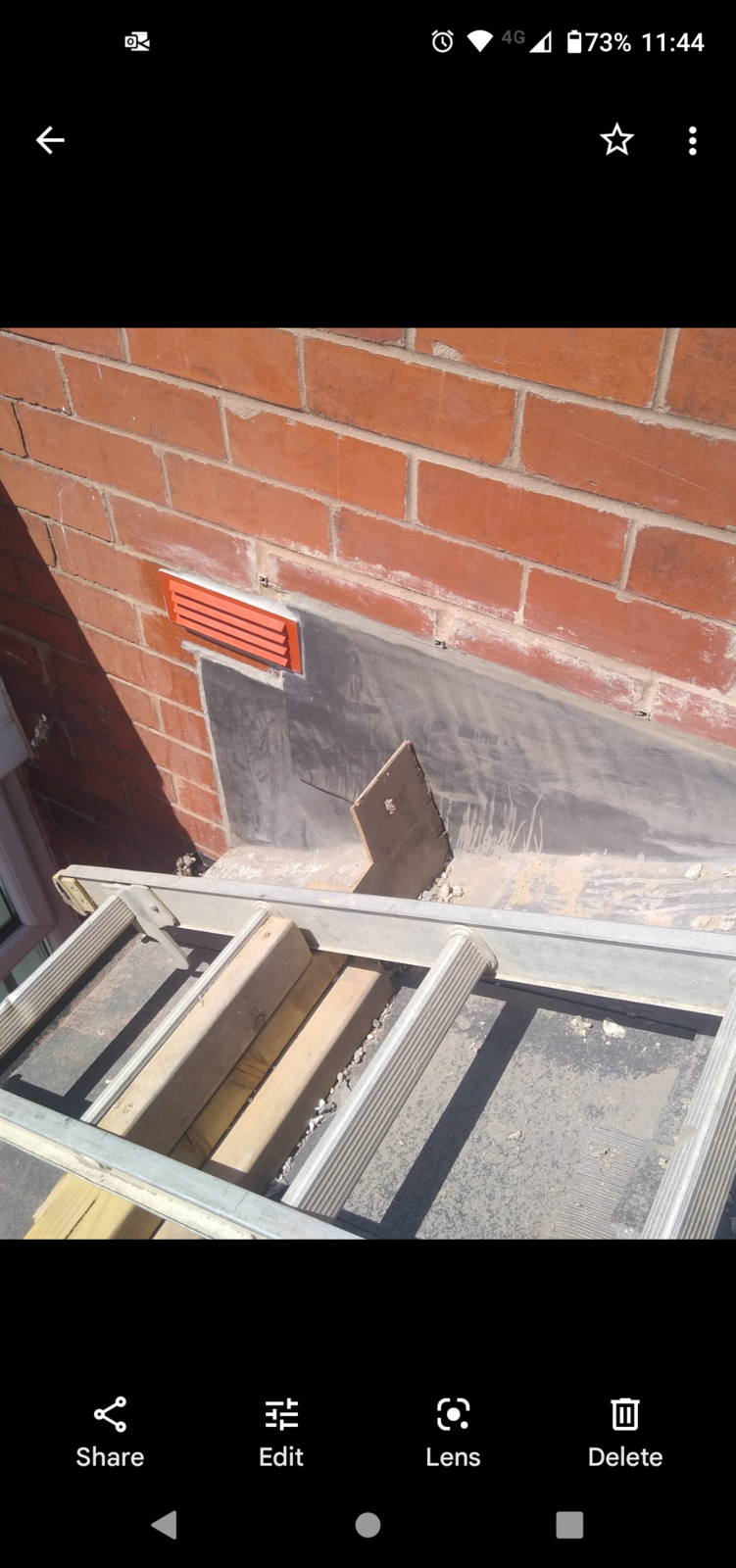

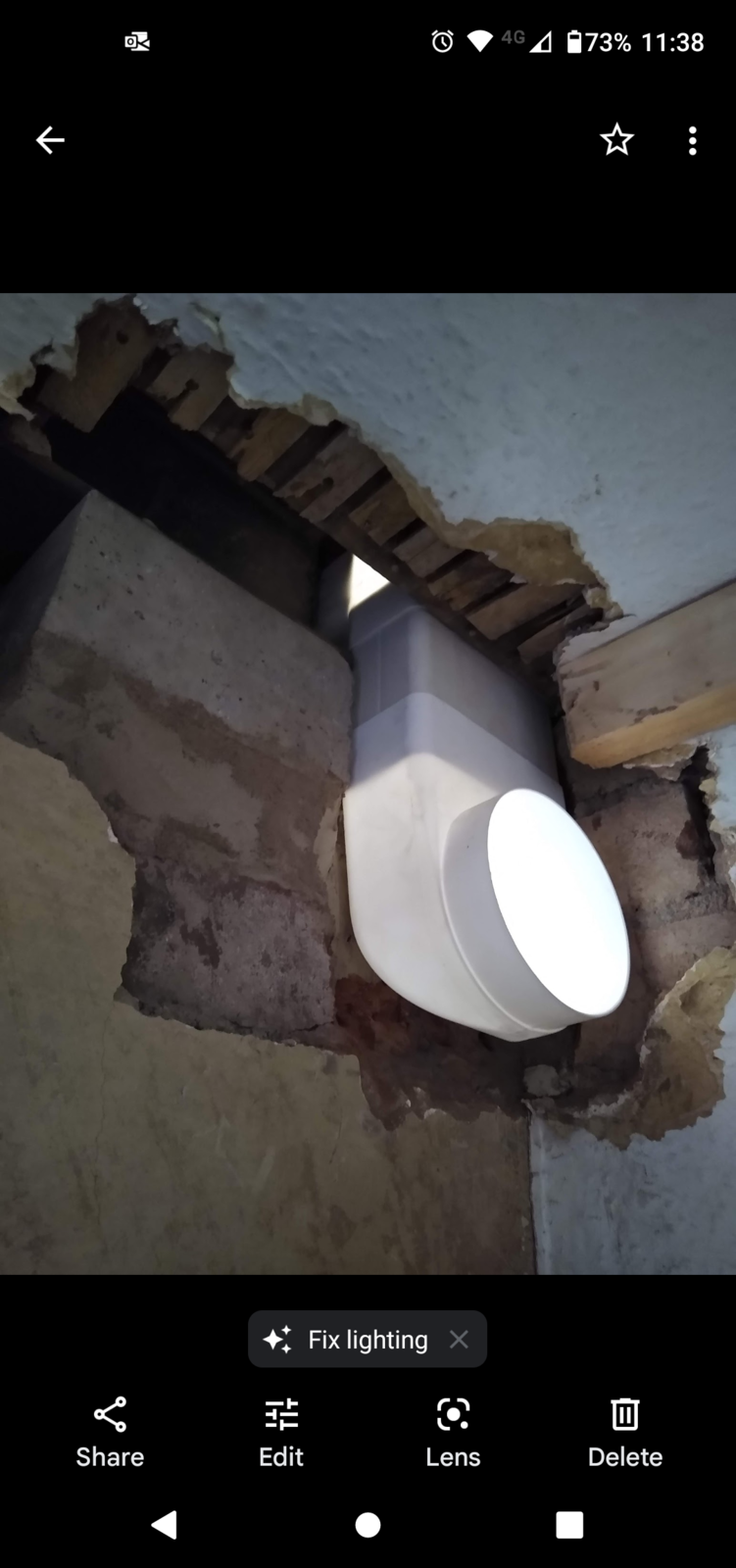

Update; I’ve made the hole inside (house still standing) and outside
I now just have to join the duct to the two 90 degree bends; what kind of sealant do I need to join them? Would normal silicone or caulk work?
And for the outside, is it best to fit an airbrick or just a short horizontal piece of ducting and a flat grill?
