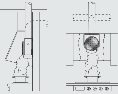

Really grateful for all the replies, thank you, and I now have a significant amount of food for thought as well as actions I will need to take to ensure that whatever I do is safe. At this point I'm pretty much decided on the second option. The first option's ruled out not for perfomance reasons but because it requires six inch ductwork (which I'm doubtful of being able to fit all the way down the chimney) and cannot work easily with a condensate trap. It also has a couple of practical drawbacks unrelated to the extraction itself.
So to make sure what I do works as expected and is safe, I'll...
  • ...get a vane anemometer (can be had for £30-40) so after install I'll be able to check the air speed and make a volumetric calculation at the exhaust point to ensure it's within spec.
  • ...check grease buildup rates in the duct over time (I have a borescope) and assess whether it's likely to become an issue. As I said earlier I think the likelihood of buildup to the point of potential for grease fires, as well as the risk of one actually being able to ignite, is minimal, but I won't rule it out. Despite being in my view a negligible risk - mainly because we're not running a commercial kitchen - it's clearly still the biggest single safety consideration.
  • ...install labyrinth grease filters at the kitchen end to trap the majority of the aerosolised grease.
  • ...install a condensate trap and re-evaporator
  • ...ensure the blower runs for a few minutes extra each time to clear the duct of as much vapour and grease as possible. I'm considering adding/maintaining an inline humidistat near the top of the flue to control this automatically.
  • ...ensure the blower itself is regularly cleaned of grease. The one I specced is easily disassembled for cleaning, plus it has its own additional grease trap built in.

maintenance access to both flue and (probably) an in-line fan that will become covered in cooking grease over time. In a normal centrifugal extractor the motor isn't in the airstream, but I doubt a centrifugal fan will have enough waft for this application.
It actually is a centrifugal fan, which I was a little sceptical about myself, however it is purpose designed for the application.
According to the spec sheet the fan will still move 300m3/hr at around 420Pa static pressure. From my amateur Googling it seems friction losses tend to dominate when moving air, but a theoretically frictionless 5m vertical duct would create about 60Pa static pressure, so I should have a lot of headroom for friction losses (which I am minimising anyway)?
Maintenance access to the fan and duct won't be an issue. The blower is at the kitchen end, inside the hood, and is designed to be disassembled for cleaning.

From my quick look, I think if that fan really can maintain 300m3/hr against 420Pa you shouldn't have any problem with flow - you only need 110-120 m3/hr. That should give you an airspeed approaching 2 m/s which hopefully is enough to get it outside before it cools enough to condense.

When they are built into commercial kitchens, there is usually a metal mesh grease trap under the hood. Needs to be in sections that can be washed daily. As it is full width, the pressure and airspeed are low and it is not easily clogged
According to my OH in her experience it's more often labyrinth than mesh, but yeah same idea - force the grease-laden air to (repeatedly, if possible) hit some sort of solid surface that will catch grease before it gets into the duct, and make that surface easily removable to allow frequent cleaning.
