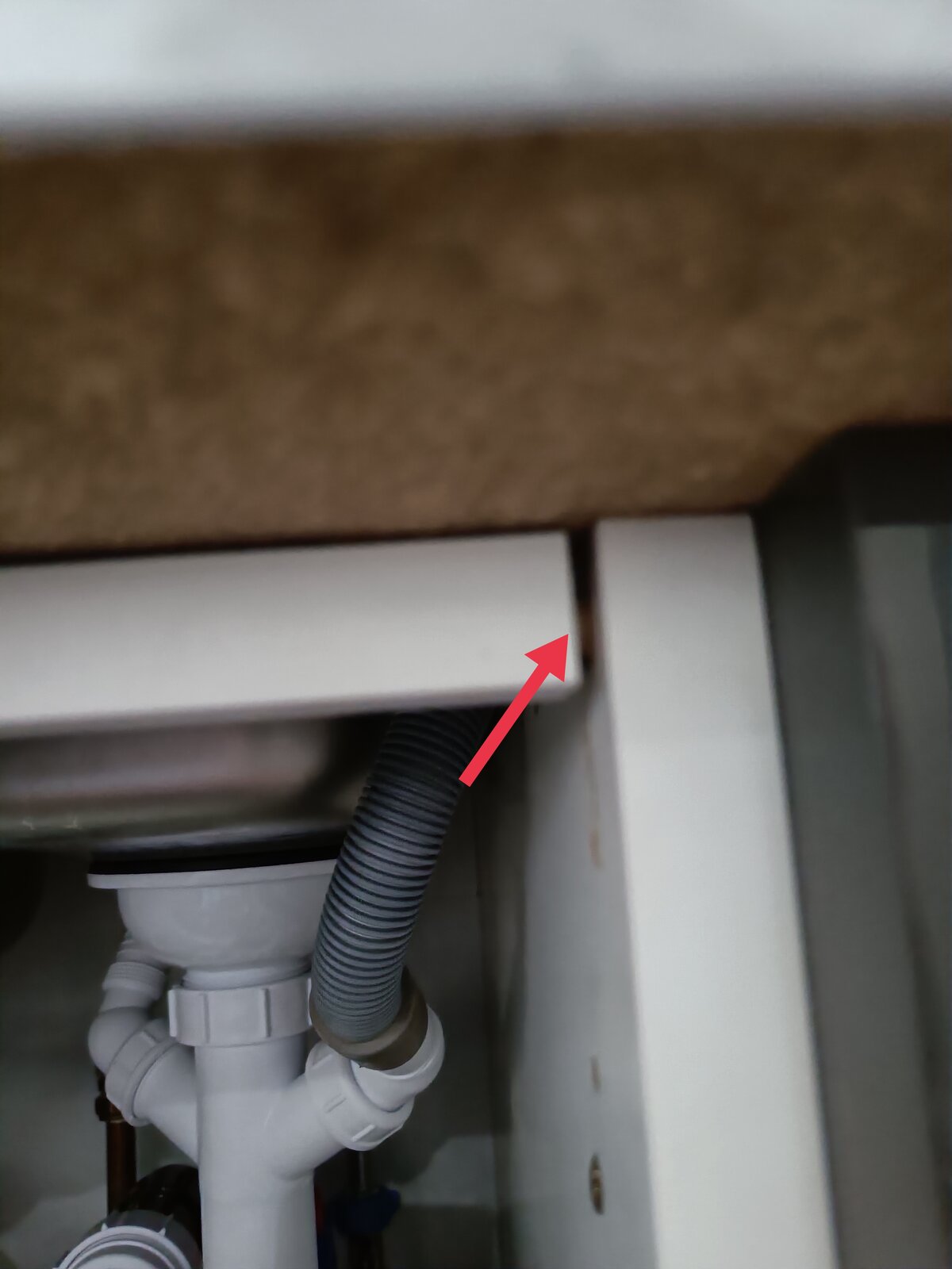

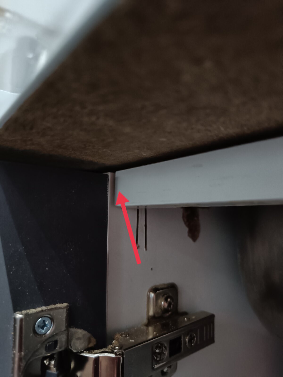

Just noticed my sink base unit inside at the top, he has cut this panel and it is just inserted with the dowels, he must of cut the part that screws into the unit off, not sure why he has done this, but the right hand side of the unit has some play in it, can this be sorted

Yes, couple of screws will fix it.
What part did he cut?
Looks like he cut the sink opening with the worktop in situ and cut the cabinet as well.

The bit were the arrows are pointing to,it effects the strigity of the unit. He might of cut it because of the sink.

Not sure I can get couple of acres into the bracket, one side is attached to end panel.
That's not something you have to do.
He needs to fix that.
If he's cutting the cabinet support, most likely he's not a kitchen fitter.
He would've realised after the first wrong installation that the sink cutout must be done on a bench, not on the cabinet.

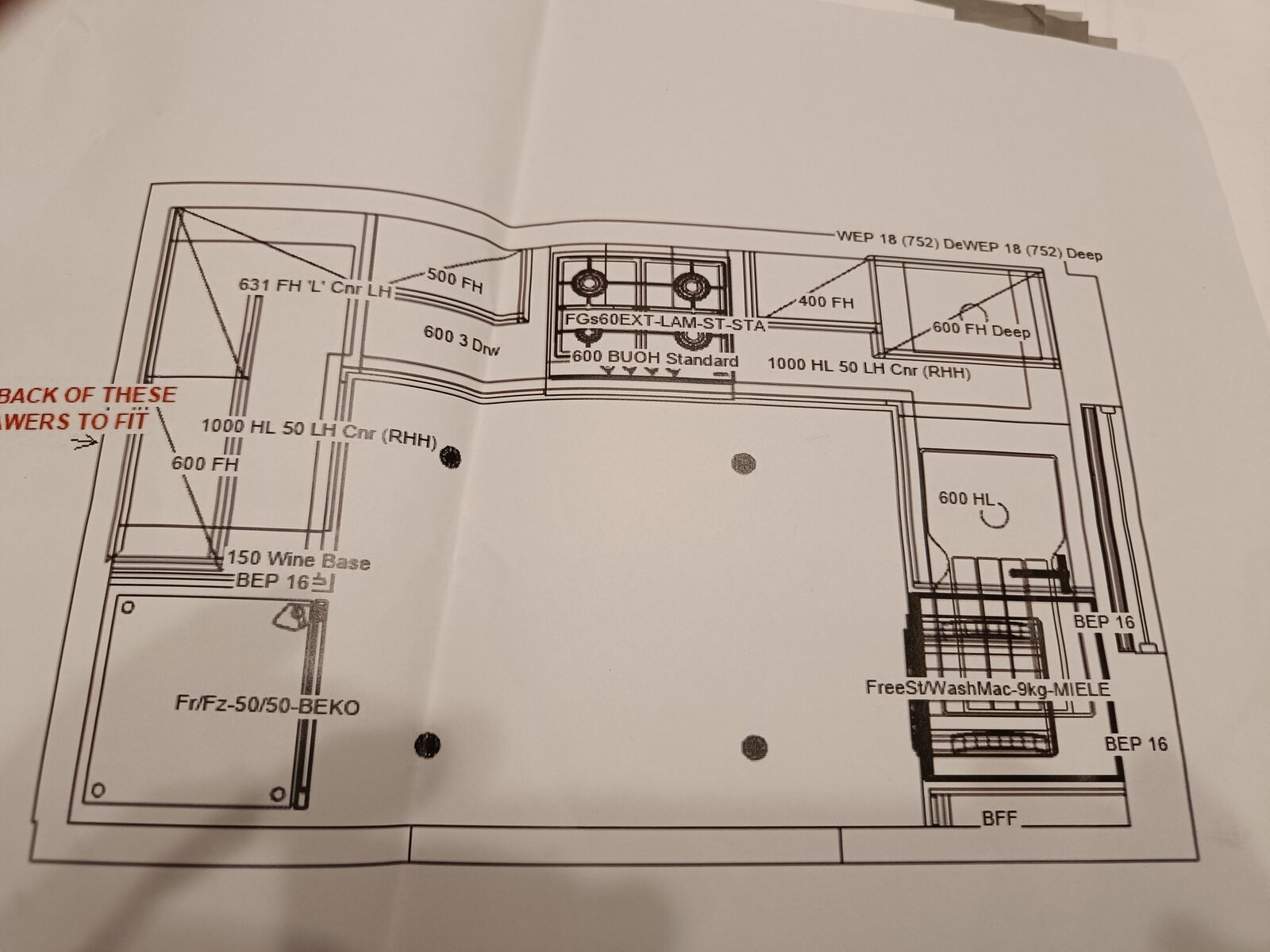

Post a picture of the plans and I tell you how much i would've charged.
Of course, if you wanted gas, electric, pipework and tiling done the price goes up.
I paid £850.00, that includes me getting rid of old.kitchen, and also putting 7 of the flat pack units together, he ripped it out. He is coming back to finish something will ask him about that panel, is it fixable

Yes, it can be fixed.
By a kitchen fitter, surely not by a bodg ere r who thought it was ok to leave it like that.
I have a metal l-plate could I use this, could only use small screws though or it would go through end panel.
In fairness not sure who cut that piece, might have been plumber to attach clips to underside of worktop, fitter wouldn't let plumber come round when he was cutting worktop to attach sink to, so was difficult to get clips on underside of worktop
