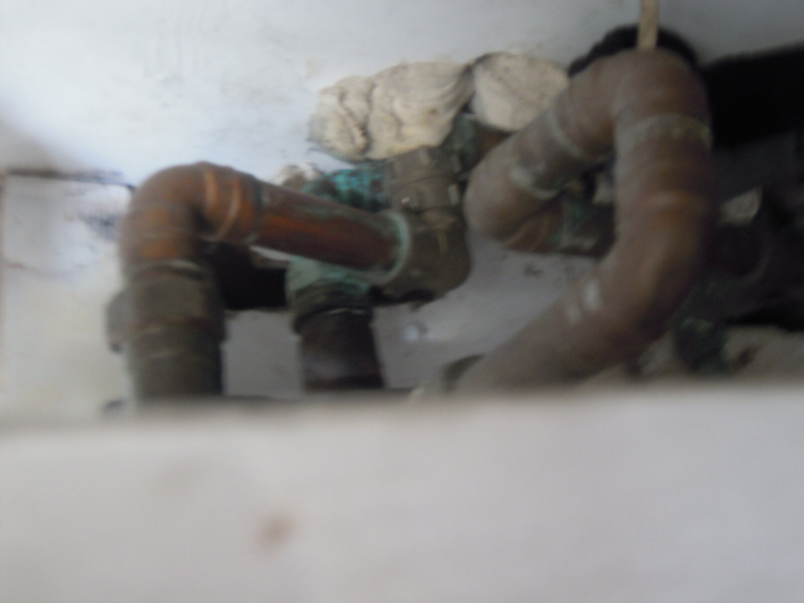

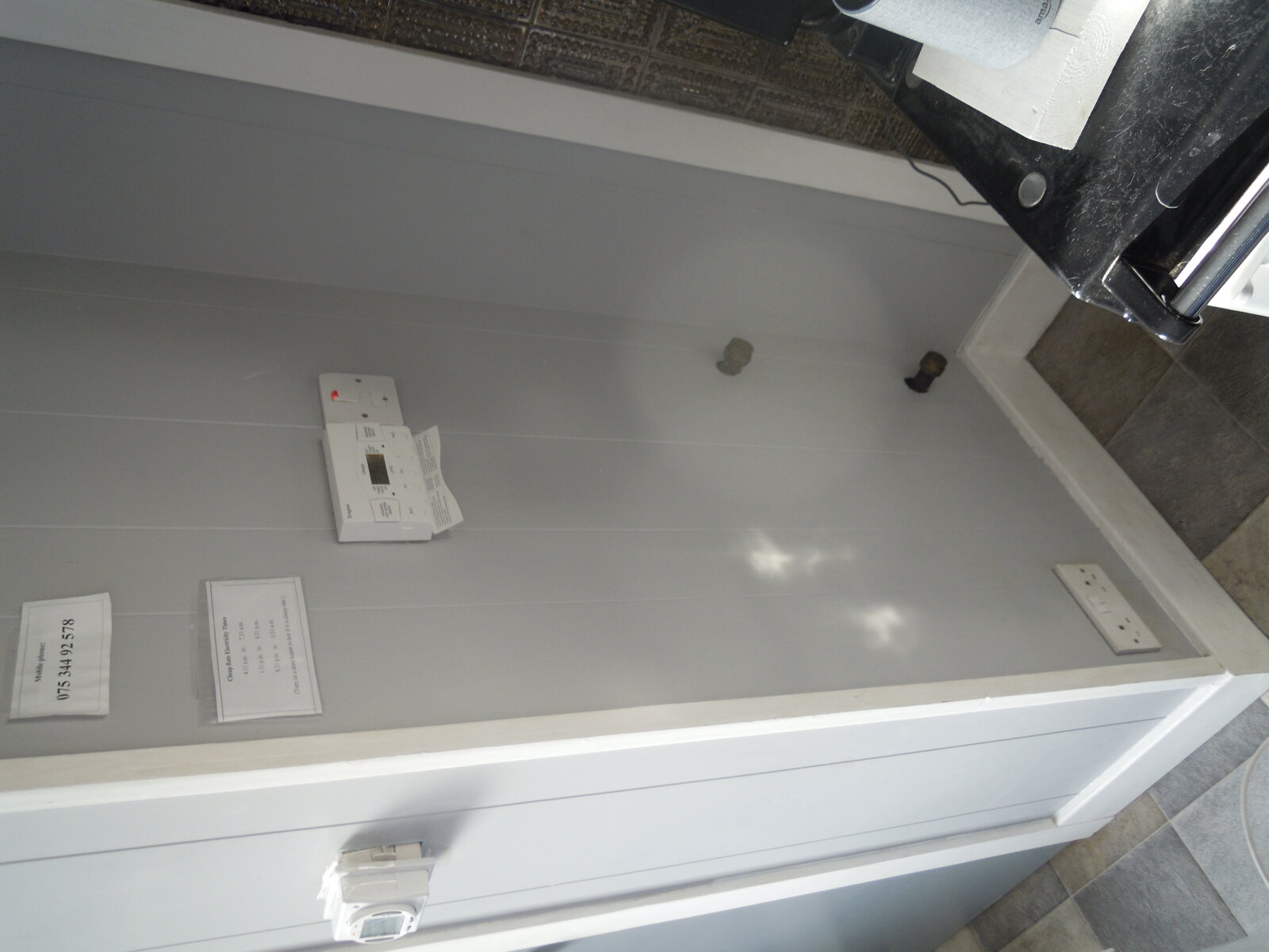

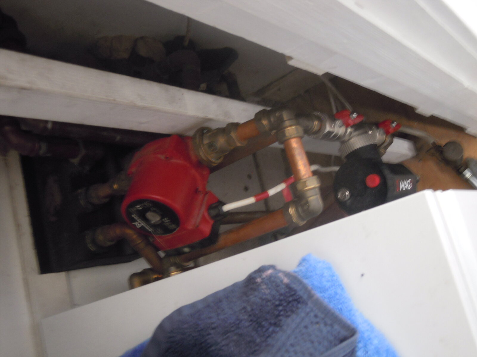

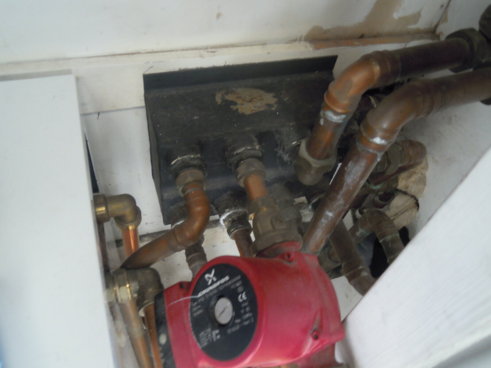

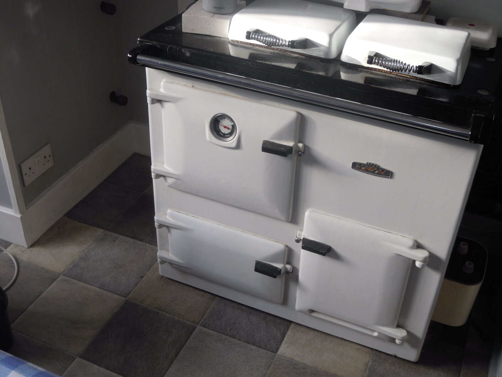

There used to be an old oil burning Rayburn in my kitchen. It was dirty, smelly and expensive. Many years ago, I had it cut off, and an electric storage heater was installed in the kitchen.
Where I live it is very remote. After 30th June I can no longer get Economy 7 - I live too far from the smart meter transmitter.
Can I transform the old Rayburn pipes into some form of hot pipework or radiator? I have a modern oil boiler hot water and central heating system, but no radiators in the kitchen. The radiator pipework does not go through the kitchen.
I am looking for ideas of how to heat my kitchen next winter. If it were possible, I would get a professional in to do the work.
I have included some pictures.

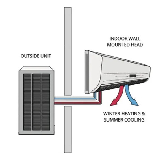

I'm not a massive fan of heat pumps pre-se, but they do have their place, and this could be one of them. A simple split air-con unit for a single room running on full rate electricity would probably cost less to run that your storage heater does to run on Economy - 7. And as a bonus you could use it for cooling in the summer should you wish to.
If you can install a radiator where the Rayburn was, and find a way to connect into the existing CH system, I don't see why not. But impossible to say without knowing the house details.

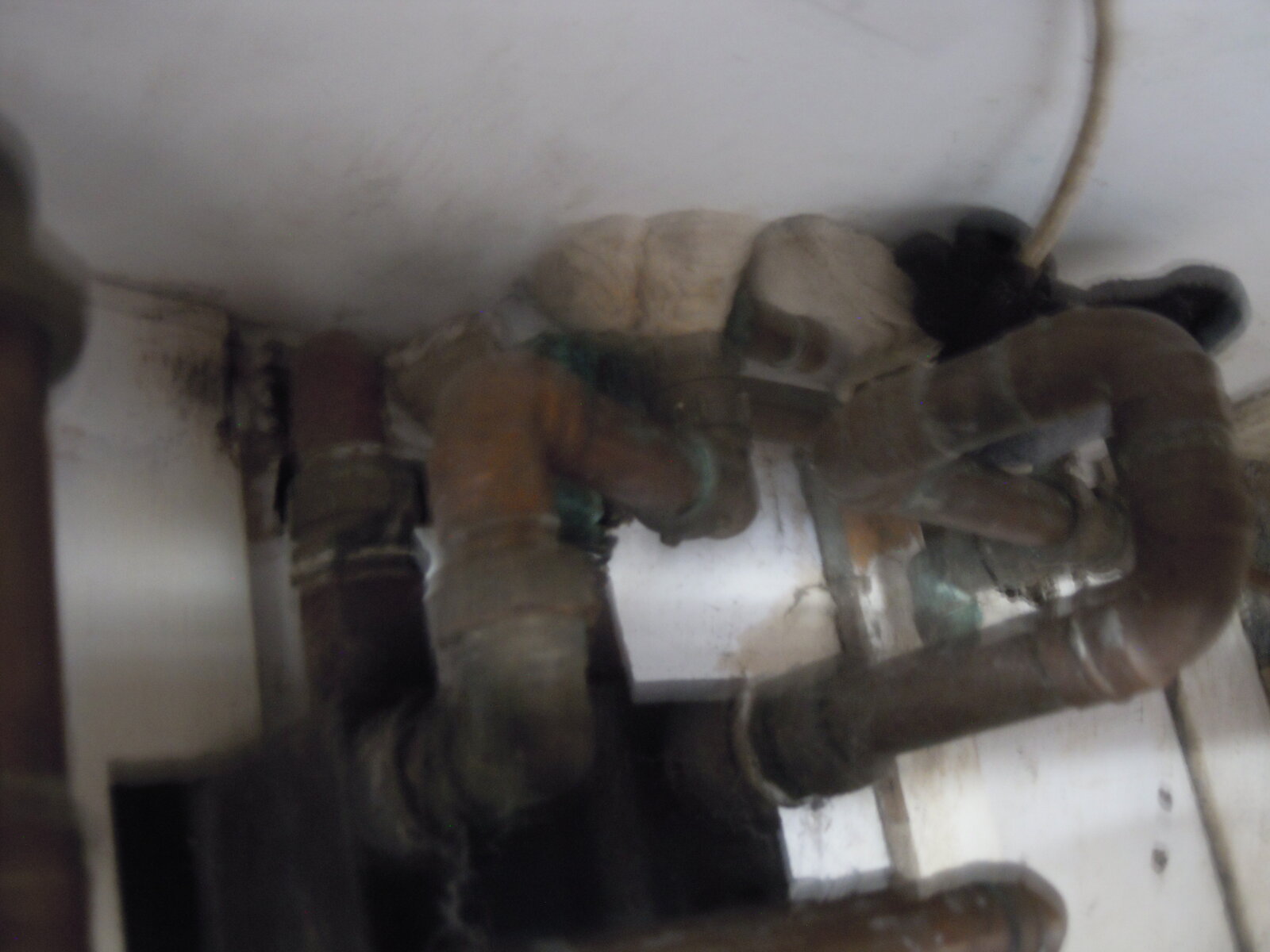

What I was hoping is that there could be some way to use the old Rayburn piping to heat the kitchen. Even if it was not a radiator, but just piping in a loop say. What is the old Rayburn piping connected to, do you think? Could it be connected to the radiators pipework, somewhere in the airing cupboard?
I don't see how we can judge that from on here. Maybe a heating engineer could work something out

Assuming the layout of your home isn't too challenging, I suspect it would be far quicker and less disruptive to install than hooking the Rayburn up to a new radiator and recommissioning it. Most Split AC-units are installed in a day or less. Just two components that are interconnected by pipes and cables. You never know, you might even be able to repurpose the existing storage heater wiring.

I got on my hands and knees. Both the cut off pipes, previously to the Rayburn, go into the rectangular black box at the back. Altogether, 8 pipes go into it. If the old Rayburn pipes were now connected outside of the cupboard, would it need a pump? I know that two of the pipes into the box are from the living room wood burning stove, which has a wrap around boiler.
I do not want to get rid of the Rayburn, but it is in too bad a state to do up.

As to pump, with my own micro bore central heating there must somewhere be a manifold, but we have electronic TRV's on 9 of the 14 radiators, so not only temperatures set, but also times, and for the recovery after the heating has been off, just 10 minutes delay between TRV's opening gets the kitchen first, then dinning room followed by living room, and once the flow has started the thermo-syphon in the radiators seem to keep it going.
The fan assisted radiator is an odd one out, really they should be piped in series not parallel, and there is no restriction on water flow, but I had one odd fan assisted in the last house piped in parallel, and it seemed to work OK with a non modulating boiler, most oil boilers don't modulate, that's something reserved for gas it seems.
