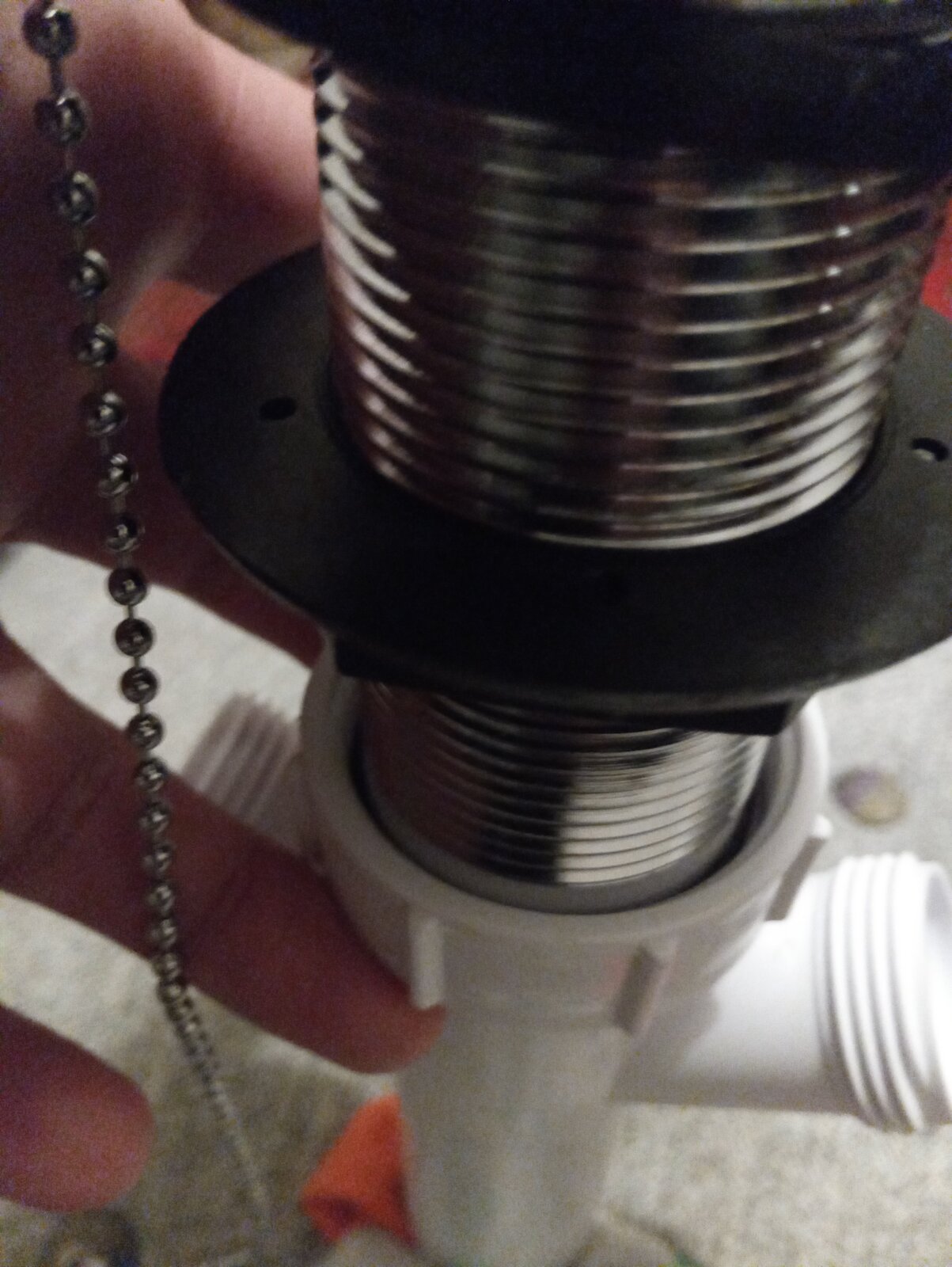

Hi, I'm changing the sink waste plug and trap for my kitchen sink. I've purchased McAlpine appliance trap 40mm and a waste plug with 40mm thread.
I cant connect the female thread to the basin waste as the thread is approx 50mm. I've searched and not been able to find a sink waste plug larger than 40mm. Am I missing something?
I don't want to add any other parts on like reducers as I'm tight for levels to the outfall.
I've got an old stainless steel sink that I'd like to keep, it doesn't have a large enough depression for the strainers. I'm live 1h drive from a DIY shop, so it's not easy to pop in. I've looked on Victoria plumb, and their kitchen wastes are still 40mm or 1 1/2". The trap I bought is for domestic, it's just with these plastic systems you have the 40mm pipe, then it fattens up where the joints so the thread dia is like 50mm or so.

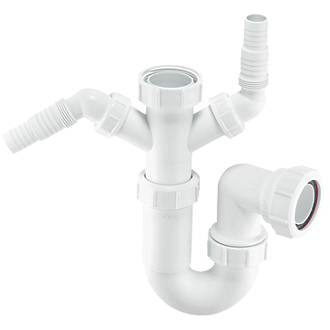

Generally there are two sizes of connector for sinks 11/4" (wash basins) and 11/2"(kitchen sink). The picture shows a trap with a 11/2" connector. This will have a standard thread for connecting to a 1 1/2" sink waste. Sounds as though you have an old sink with a smaller waste,or you have purchased a 1 1/4" waste ( the bit that fits the sink and has the plug). You need 1 1/2" waste. The pipe sizes are metri but the sink wase connectors use the old thread sizes.

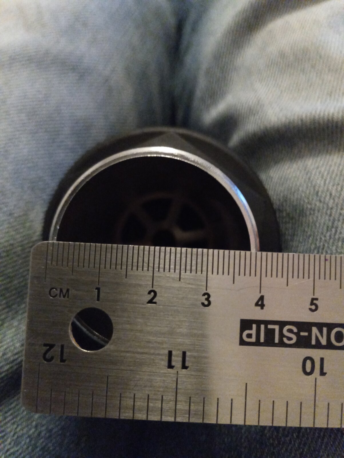

From your pics it looks like the plastic female thread (not the outer wall) is ~4cm diam and the metal male thread is the same?
Okay, figured it out. The sink waste I bought was advertised as 40mm, but I now gather it's actually 1 1/4" BSP, which actually measures 1 1/2". What I need is the 1 1/2" BSP which actually measures 1 3/4". I should have known it was not as simple as buying a 40mm trap and a 40mm sink waste
1 1/2" BSP = 47.8mm Ø, 1 1/4" BSP = 41.9mm Ø
