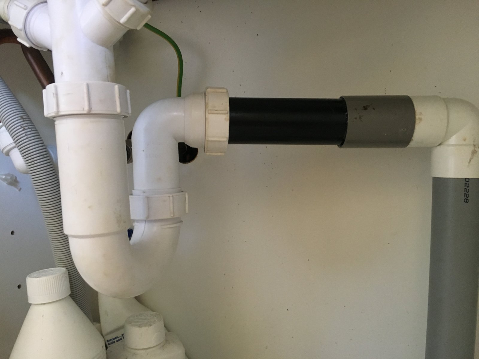

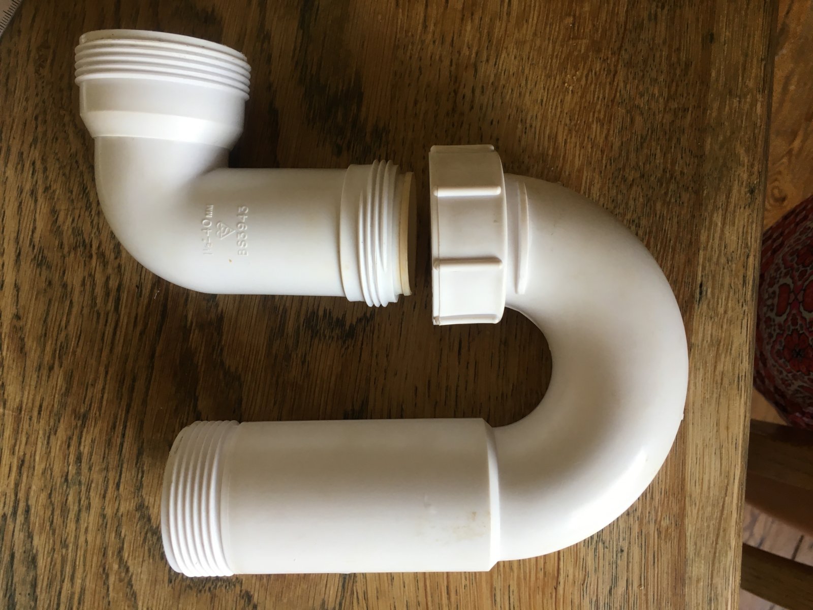

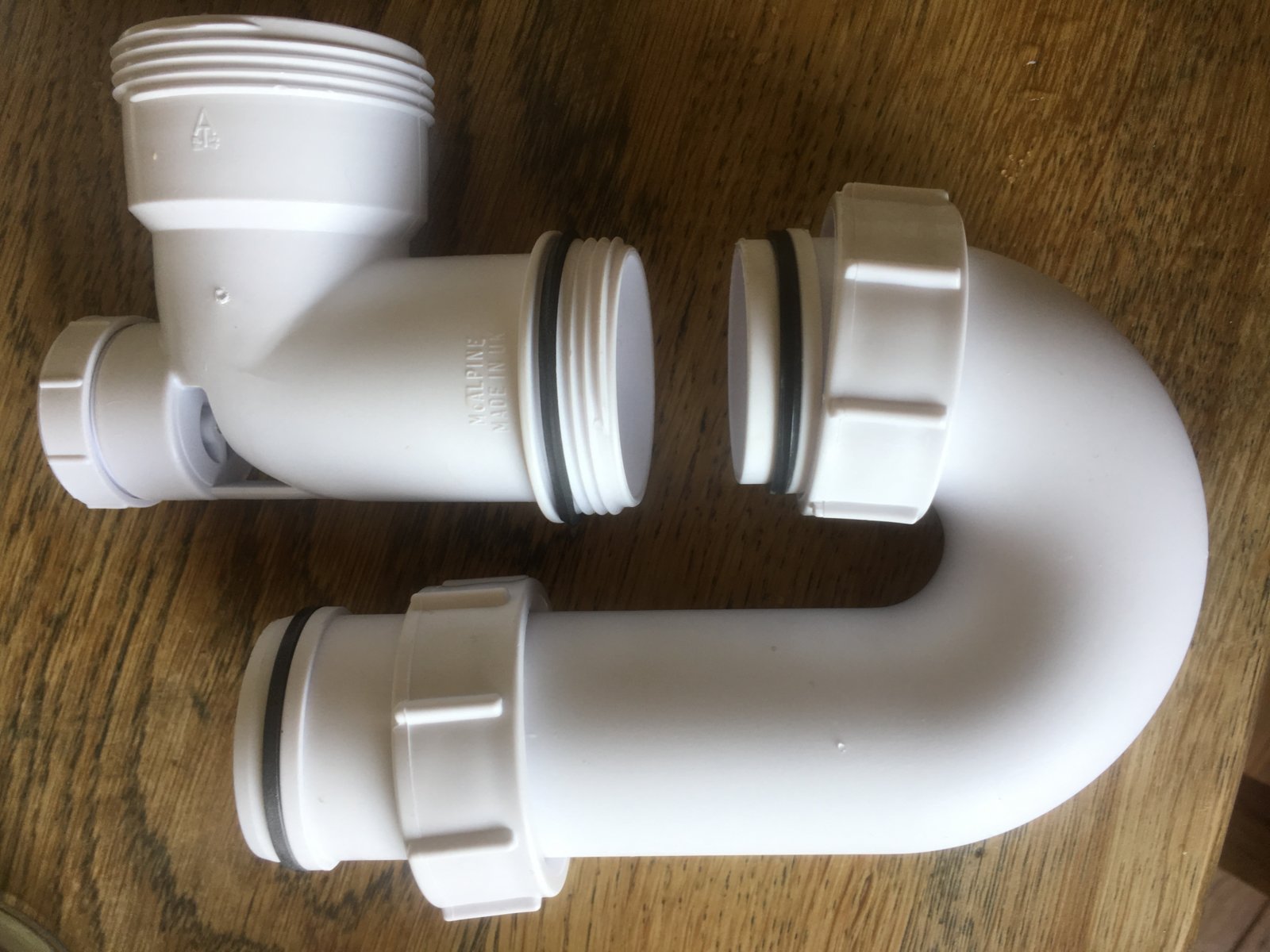

Hi Rob - pics below. The issue is that the old one is wider at the top end so it slots up onto the existing pipe, but the new one only butts up against it because it's the same size.
The third pic is the one that was needed. You're old one is an adjustable appliance P Trap, it's not a standard P trap, like your new one. If you took of the plastic adapter that the WM/DW drain hoses connect to, your new trap would then fit to sink waste.
The trouble is getting your original adjustable double appliance trap with an Anti Vac valve. Don't think I've ever seen any, only seen singles. If you really want to try an antivac and keep the double appliance adapter then you'll probably need to plug an anti vac valve in after the trap

I made the assumption that the top part on the left could be removed to enable the lower part to fit to my existing 'top part'.

I've had confirmation that the left top part is removable and would therefore fit onto my existing double appliance adapter, so it's now on order and I'll give it a try and report back. Thanks for your helpful responses so far.
Yep, good one .... if it's the same maker (looks like McAlpine) then the end of the adjustable appliance adapter may be the same diam and fit the new AV P trap, once you remove the long end. Make sure the seal is the same size and nice and tight.
