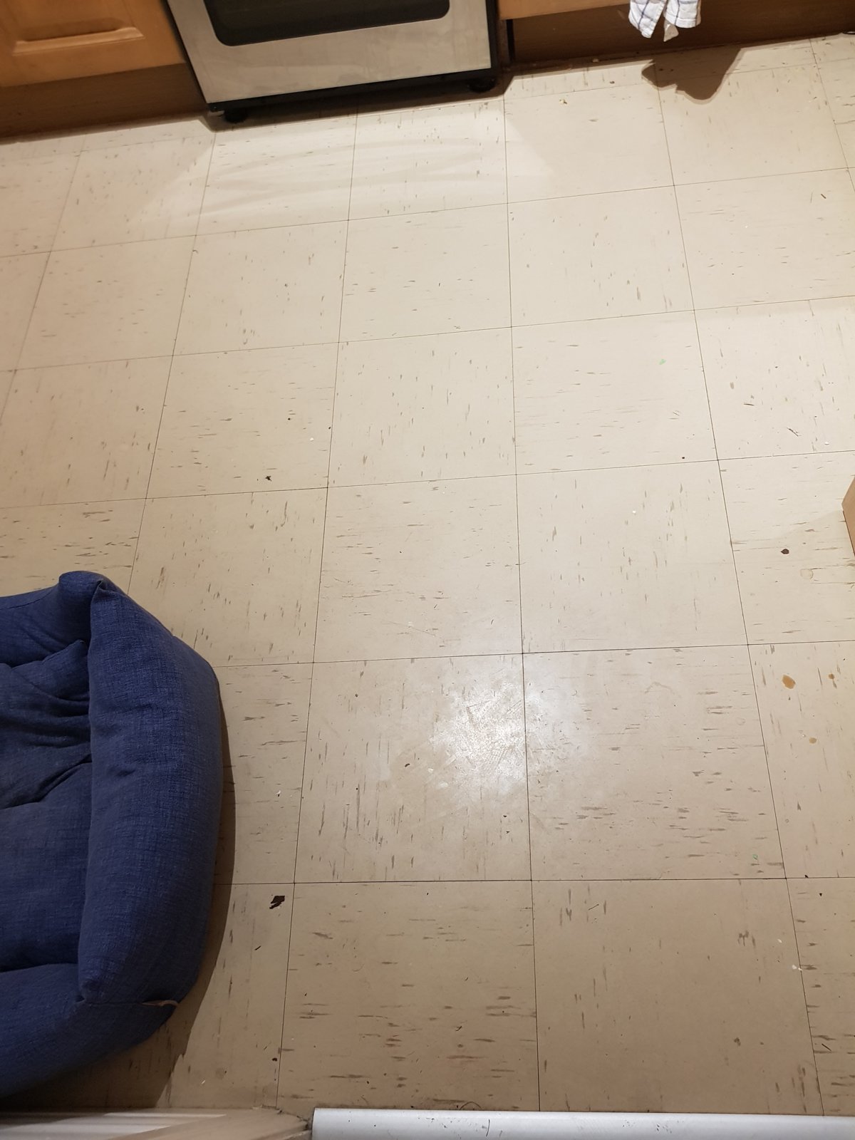

Your existing laminate floor tiles- really? As in what are they, tiles or laminate? (Pic might help)

Floor tiles are attached
With the floor I want to go straight through with the same flooring into the adjourning 9sqm hallway, we've put a laminate sheet down that's fantastic and only temporary as we never had the funds to buy the rest of the tiles to finish in the kitchen.

Those floor tiles look like lino to me, not laminate. If the rest of the floor is that flat save yourself the grief and chuck your LVT on top.
