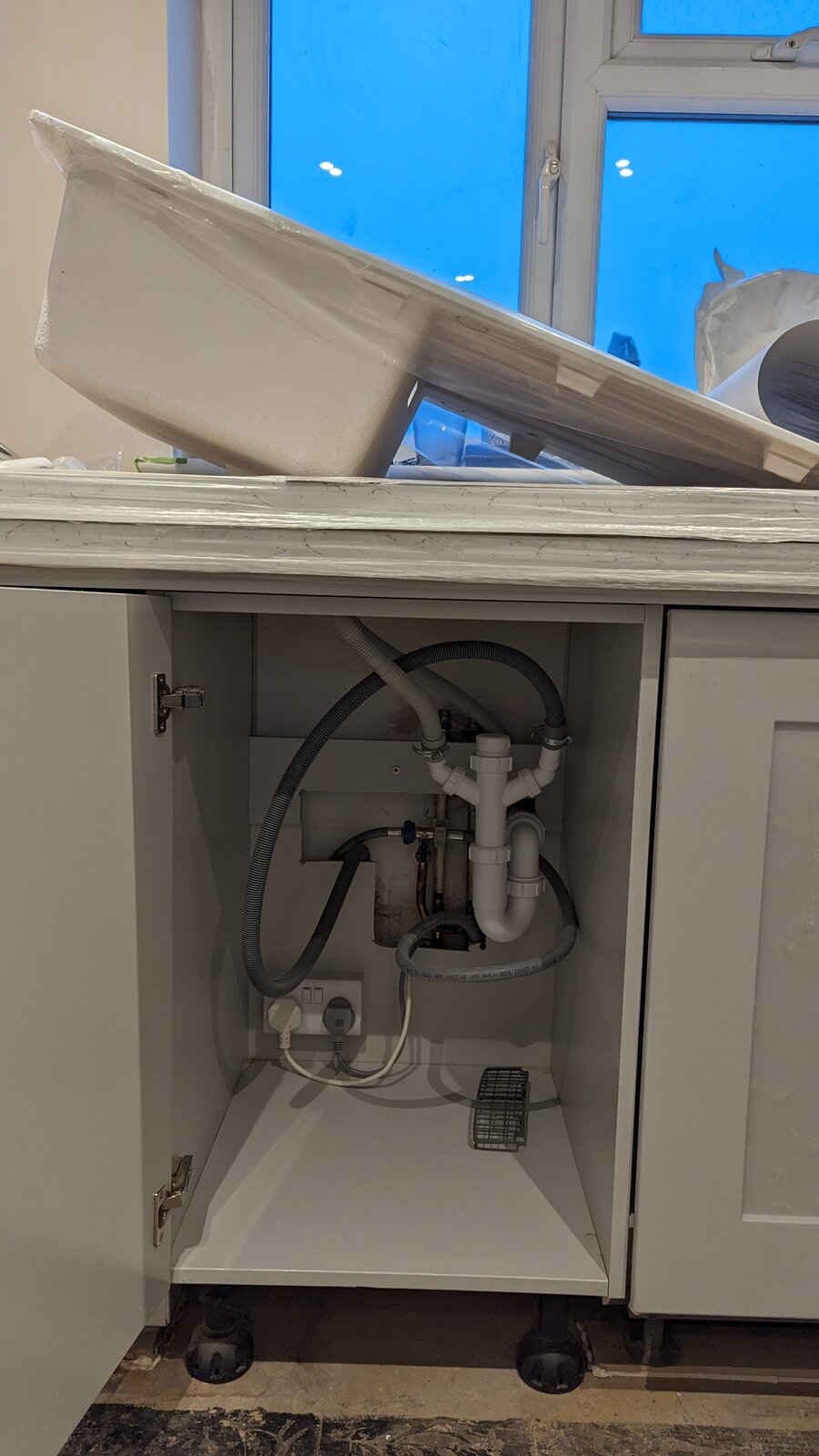

I'm going to be fitting the sink on Monday but I might need to rethink the plumbing underneath as space is going to be very tight.
Has anyone got any suggestions on the best route to take the waste pipes from the appliances? I didn't know if it was best to drill out holes under the cabinet and pull them up through there
The traps going to need to be moved over to the left abit, can it be lowered as well?
I'm just not sure on how to fit everything underneath once the sinks in.. if anyone has any good ideas that'd be great

Does the waste pipe from the trap (to drain) go straight out through the wall or drop in the pipe void? As it is its going to be close to sink bottom if not above it.
Flexi waste from washing machine etc- redo them so they travel up almost vertically behind the machine to the spec height then fall towards the trap.
Appliance drain hoses are ideally position up and over the edge of the cabinets and then down into the waste spigots. Routing then underneath the cabinets is a recipe for disaster longer term - smells/backflow etc into the appliances can be an issue and the drain hoses will never empty properly so can cause a build of crud in the pipe.

See @Madrab post above for why along from appliance then up is a bad idea. Up then along is much better.

The ideal with drain hoses it straight up out the appliance and up and over the unit into the spigot - exactly why some machines come with the hoses already clipped to the top part of the machine - so there will be little standing water left in the hose once it's finished pumping
All you need to do is cut a couple of 25mm holes in the top side of the carcass

I was about to question your logic, but then noticed that you explicitly mentioned the fact that the appliance will only pump out a given amount of water. Many thanks
