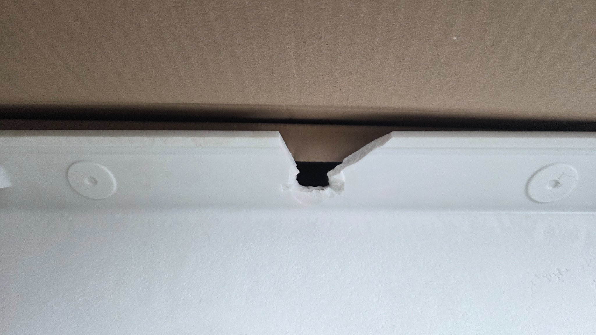

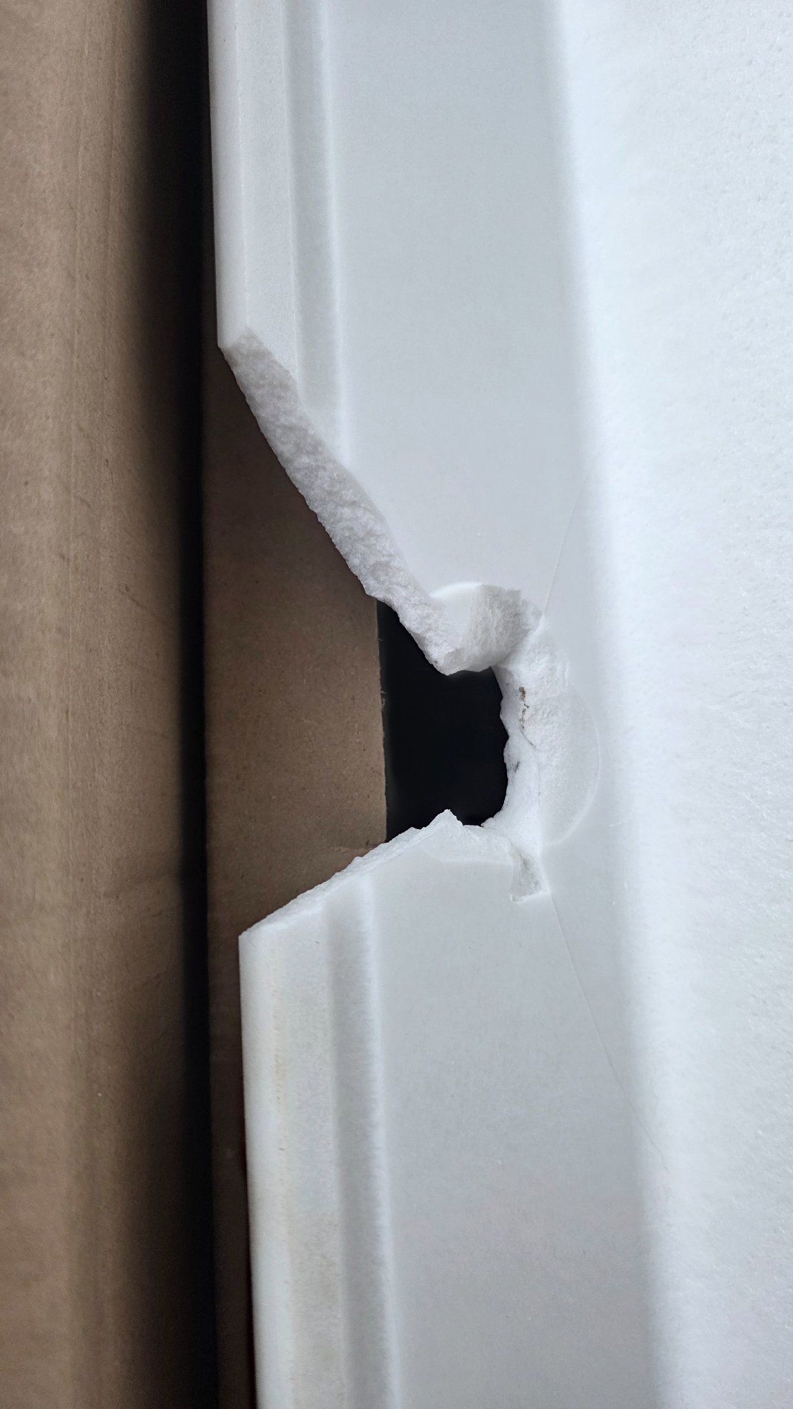

My plumber had a little accident when trying to knock out the tap hole on a rangemaster oridian granite sink.

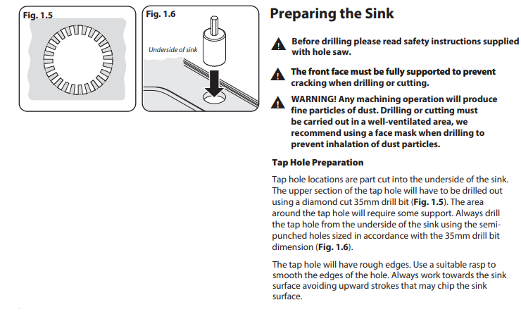

The instructions are clear, mark out hole on top and use a screwdriver and hammer to punch hole out.
But if you look at the pictures of the damaged sink you can see that there is no cut out or weakened area to tap out.
Any suggestions / guidance on the best way to sort this please.

Hole cutter suitable for granite, sometimes fits a grinder.
Did he follow the instructions? If so, i would be blaming rangemaster
Yes, I watched him.

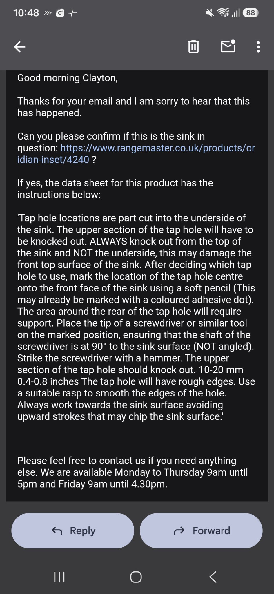

Sent an email to rangemaster saying the cut outs are not cut out. You can see from the pictures theres no prep for the cut out done there. Would it be safer to drill?
Looks like it, but the fact that the holes weren't part cut should have raised alarm bells. There was only one outcome when trying to punch that out, it shouldn't even have been attempted.
