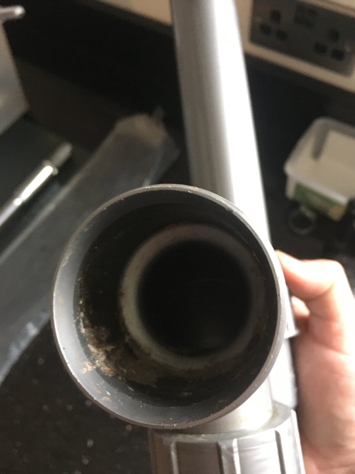

My plan is to remove the solvent weld plumbing and change to compression fitting for future ease of dismantling for cleaning etc, but here comes nightmare number 2, it’s 43mm, seems someone at some point had the urge to make 40mm instead.
Because of this I want to go with 40mm and not get new 43mm (if you can even get it) so at least it’s standard.

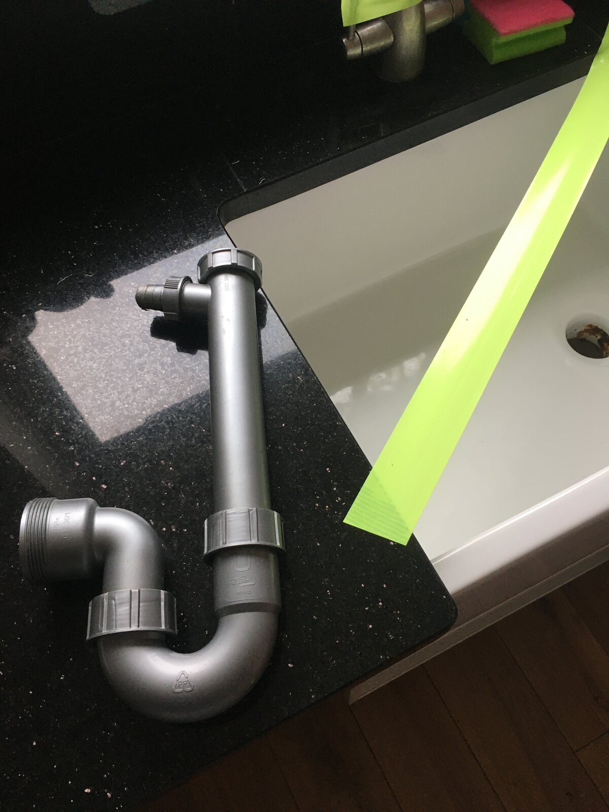

Now onto nightmare number 3, the kitchen sink waste pipe plumbing (bends, down pipe etc) is some weird silver stuff, I believe it’s Lira/Franke space saving (not needed at all)

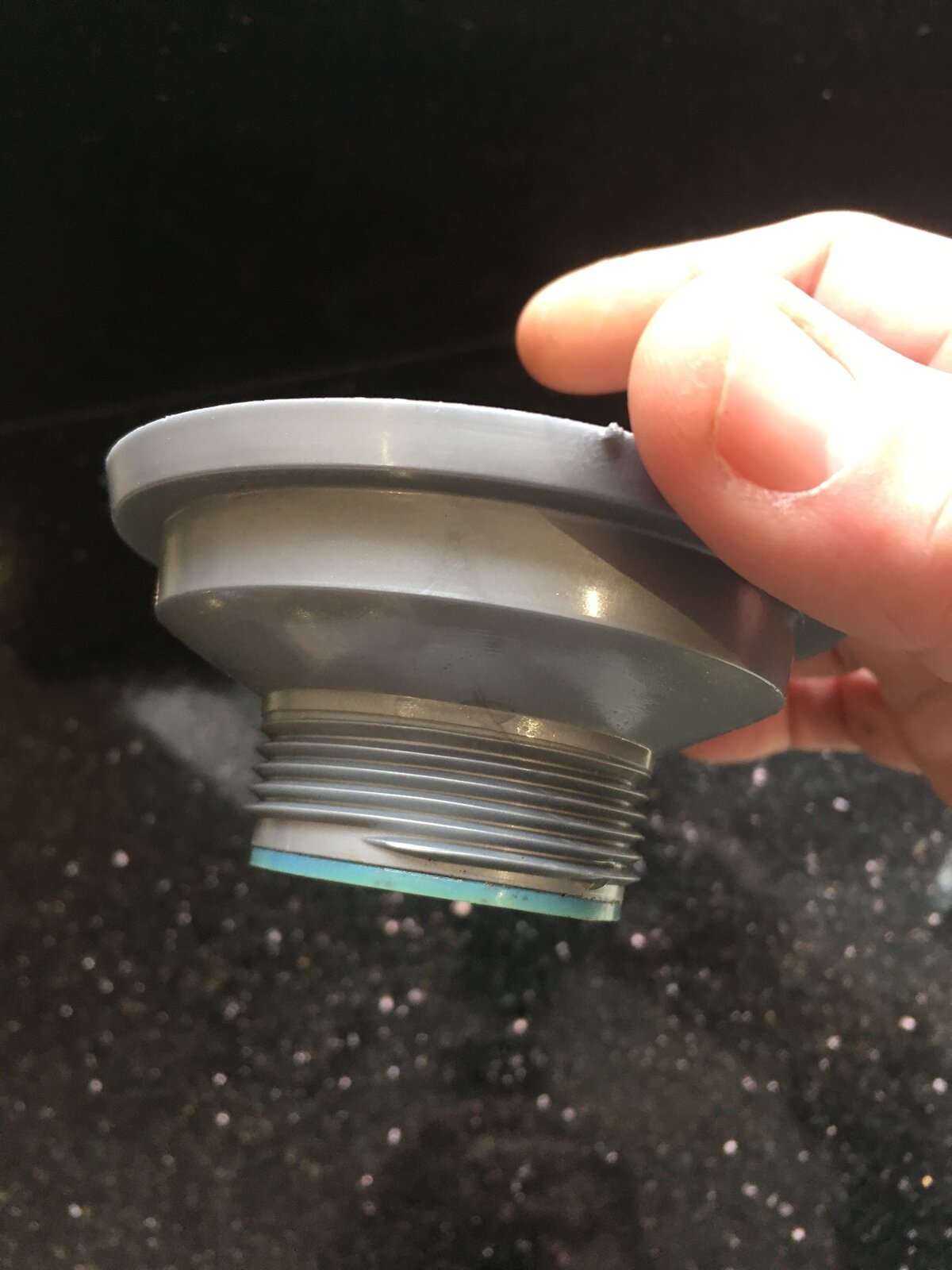

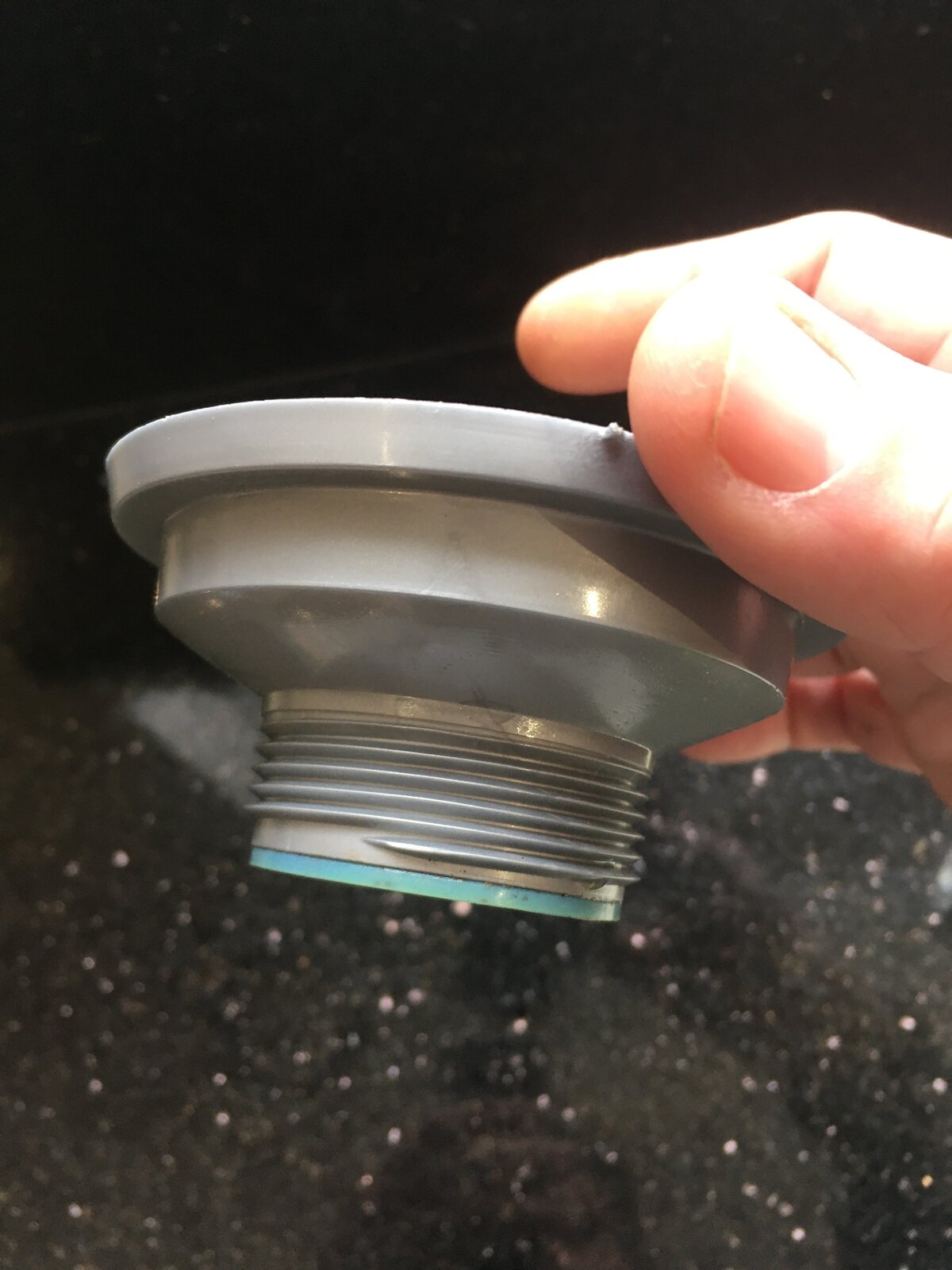

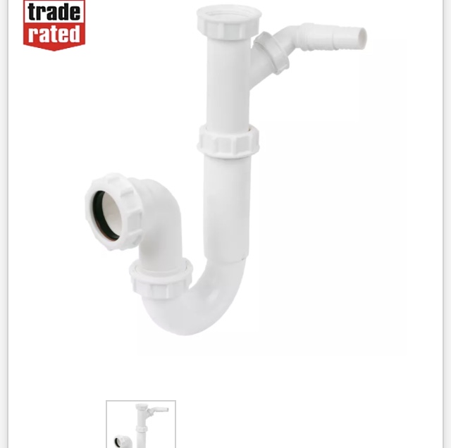

If I keep the existing plug bit, would a 40mm waste trap kit work on it, or will I need a whole new plug. Below is a picture of the bottom of the sink plug, if I get a standard telescopic trap such as this
Will that fit into the bottom of my sink strainer which is
If so I think I’m good.
Is there a way I can measure the bottom of my kitchen strainer to know if the new waste trap will fit?

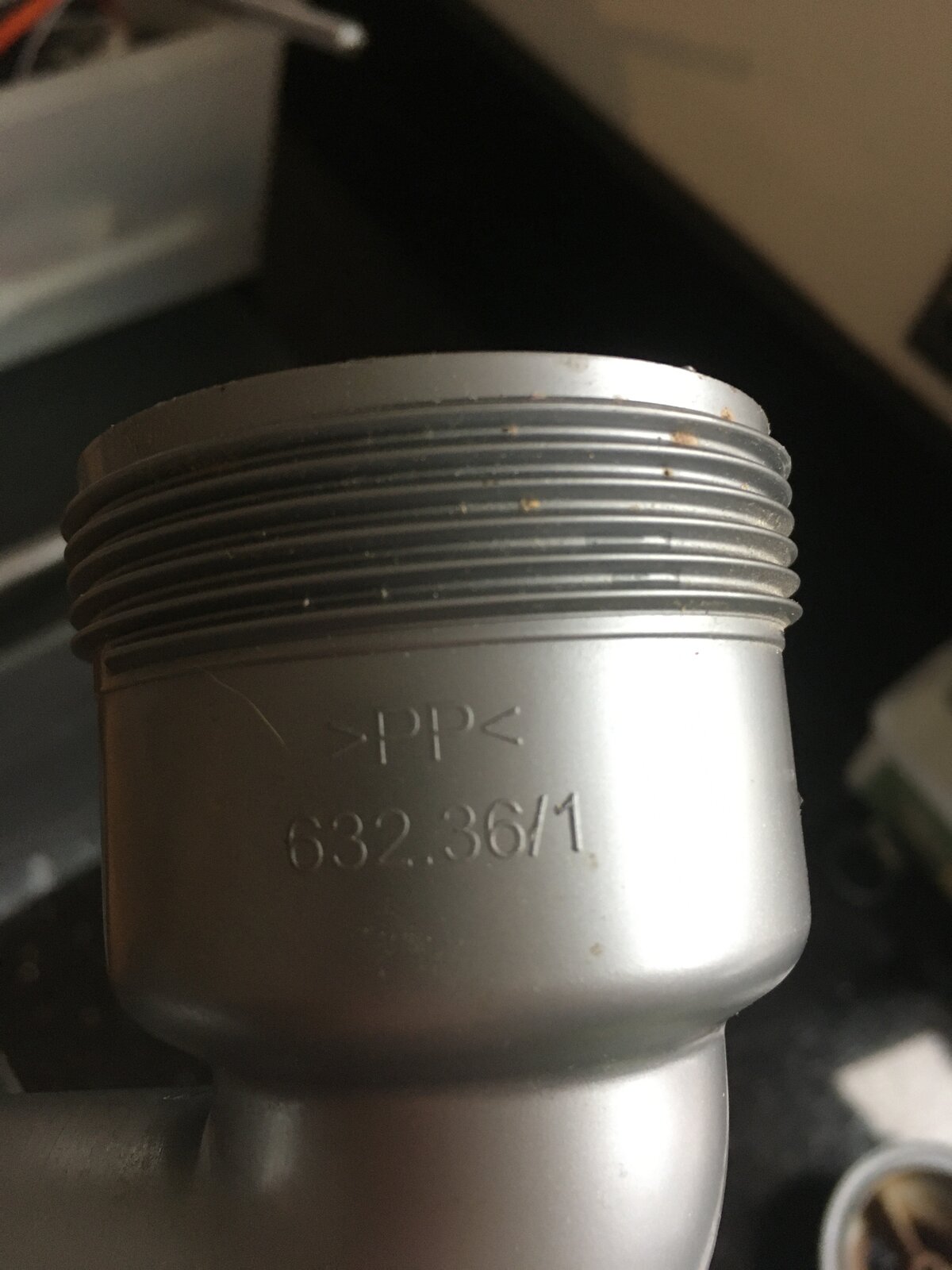

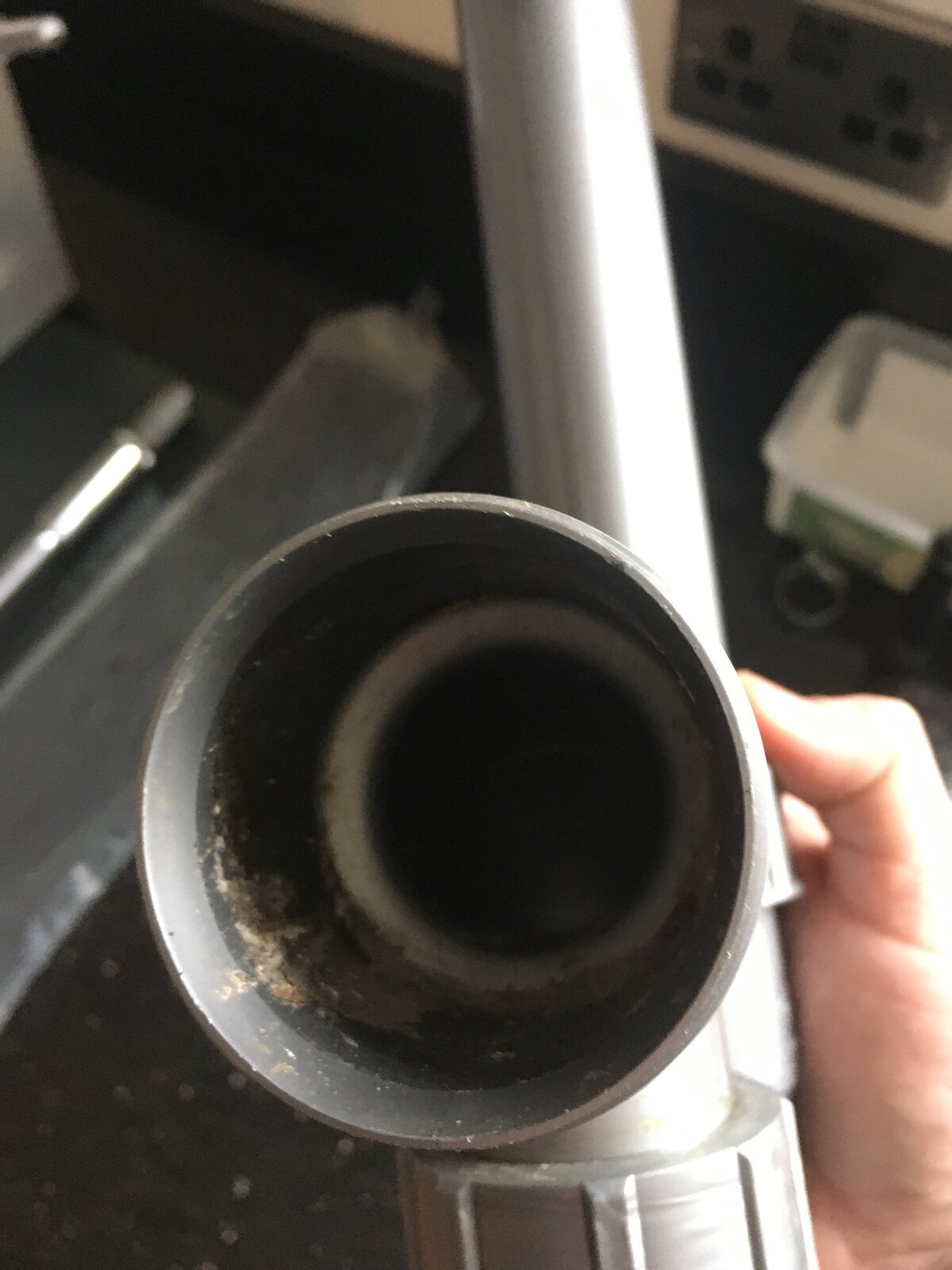

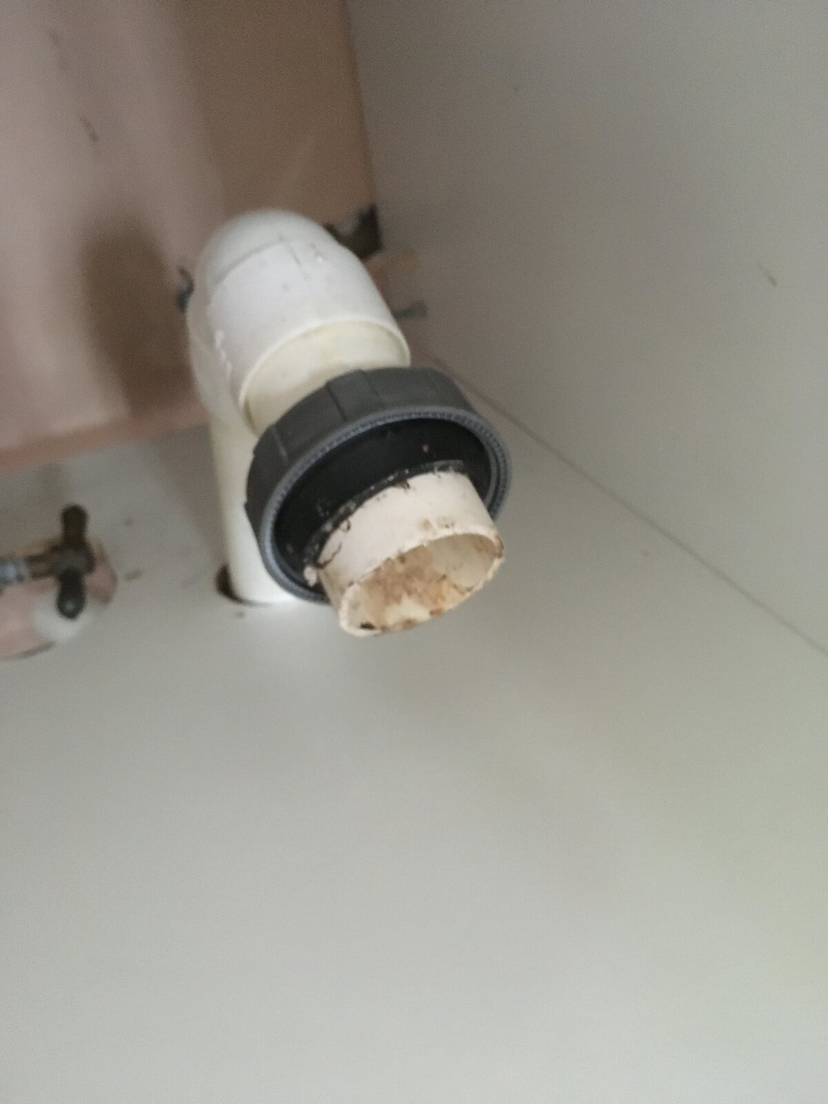

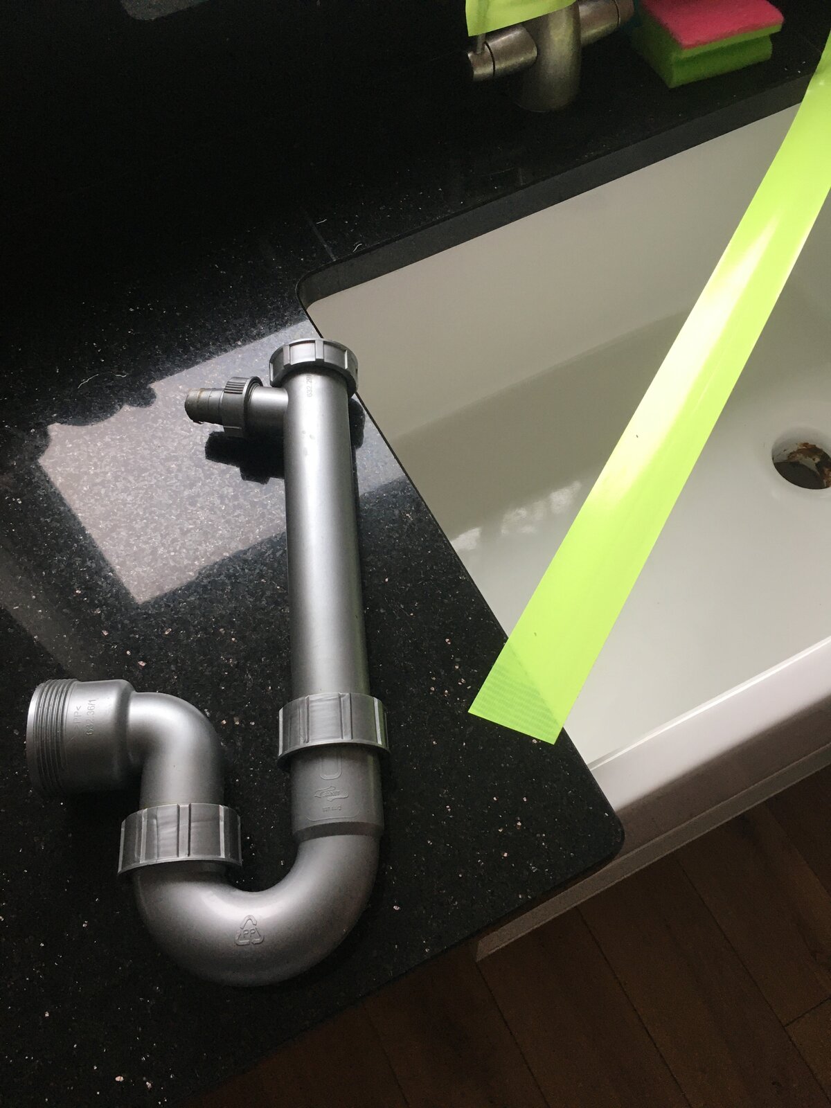

Few more pictures of the setup. Also if anyone knows whether I can just get 40mm pipe and put into picture 1 where the current 43mm goes and won’t get leaks even easier as I can keep the whole setup, apart from new 40mm to soil

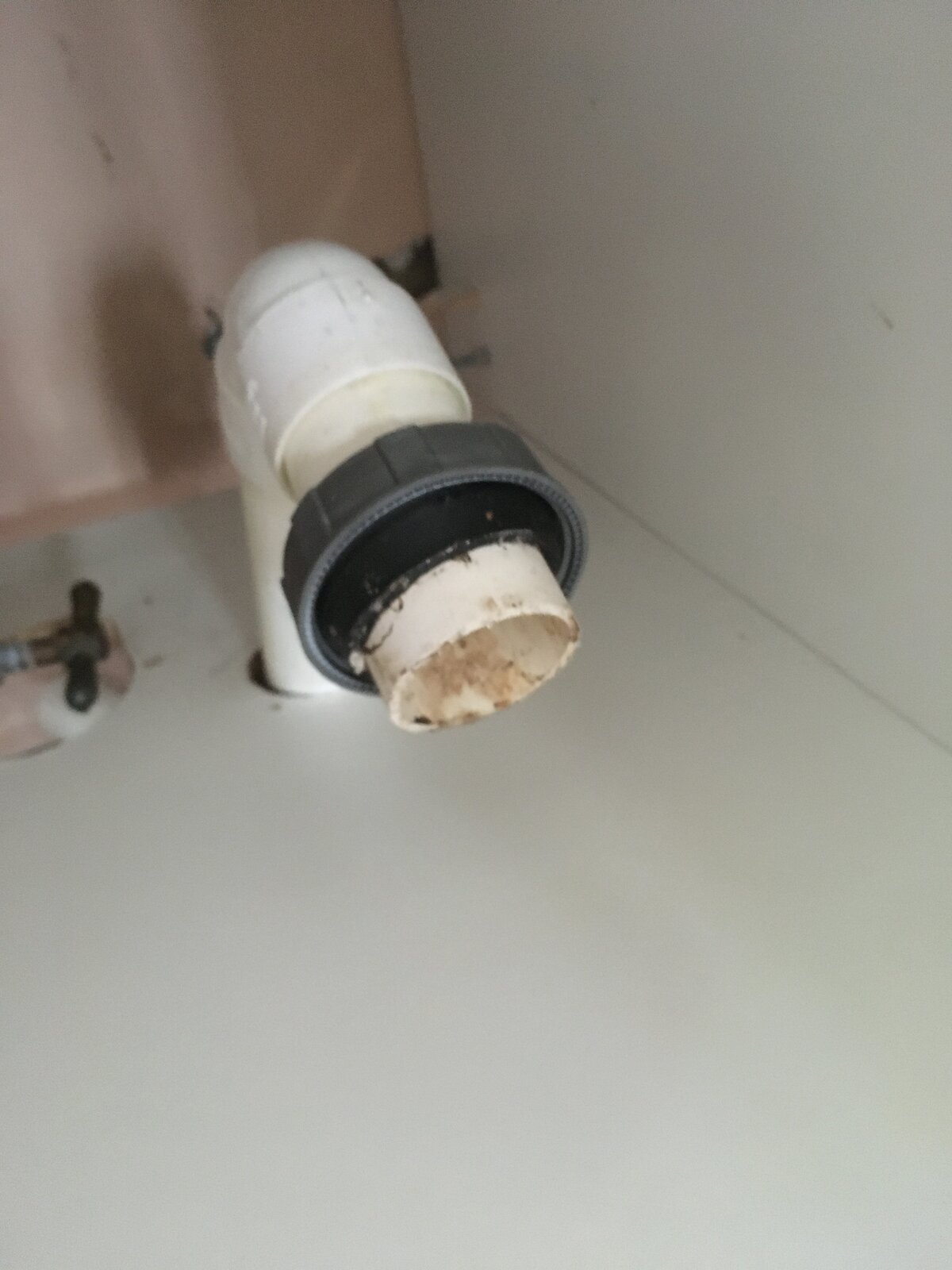

This below is a 43mm pipe. If I can get new 40mm pipe to replace this and it fits into picture 1/2 I’m good but I don’t know if it’ll be watertight as it’ll be 3mm thinner, but the current 43mm pipe wobbles into picture 1/2 but is good because of the rubber washer
If all the grey trap/ components are all good ,why change it ?
Compression fittings will accommodate solvent weld pipe as well as push fit pipe. The outer diameters ,although different doesn't matter.
Push fit and solvent weld pipes and fittings are not compatible with each other.
Hi, thanks for your reply.
Just to clarify, if I get 40mm pipe it’ll still work with the part in my 1st and 2nd picture on my second post? Obviously I’ll need a new washer for it but should be good?
I was only thinking I’d need to change the silver parts because it’s not a standard size, because a 43mm pipe goes into it now (it probably is but I have no idea tbh)
I guess as the 40mm pipe will come with a washer it’ll work like you said because when it’s tightened it should make a good bond, in which case the silver existing parts will remain which I’m good with

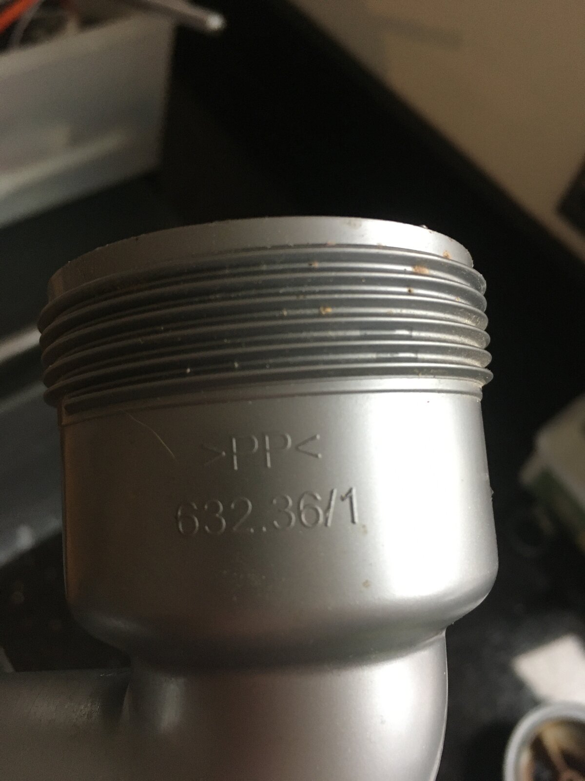

I mean a new seal, from the new 40mm pipe screwing into the 1st and 2nd picture. I’ll need to get one of them rather than reuse the same one in picture 4.

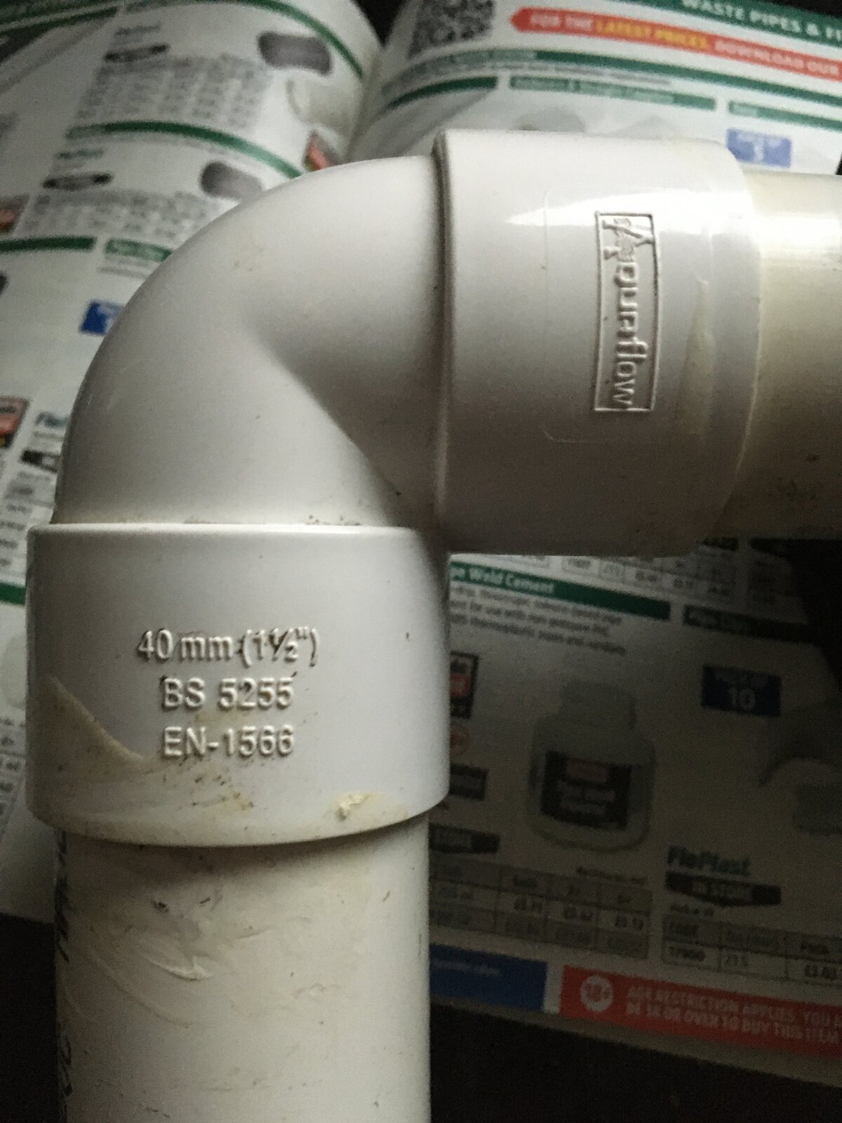

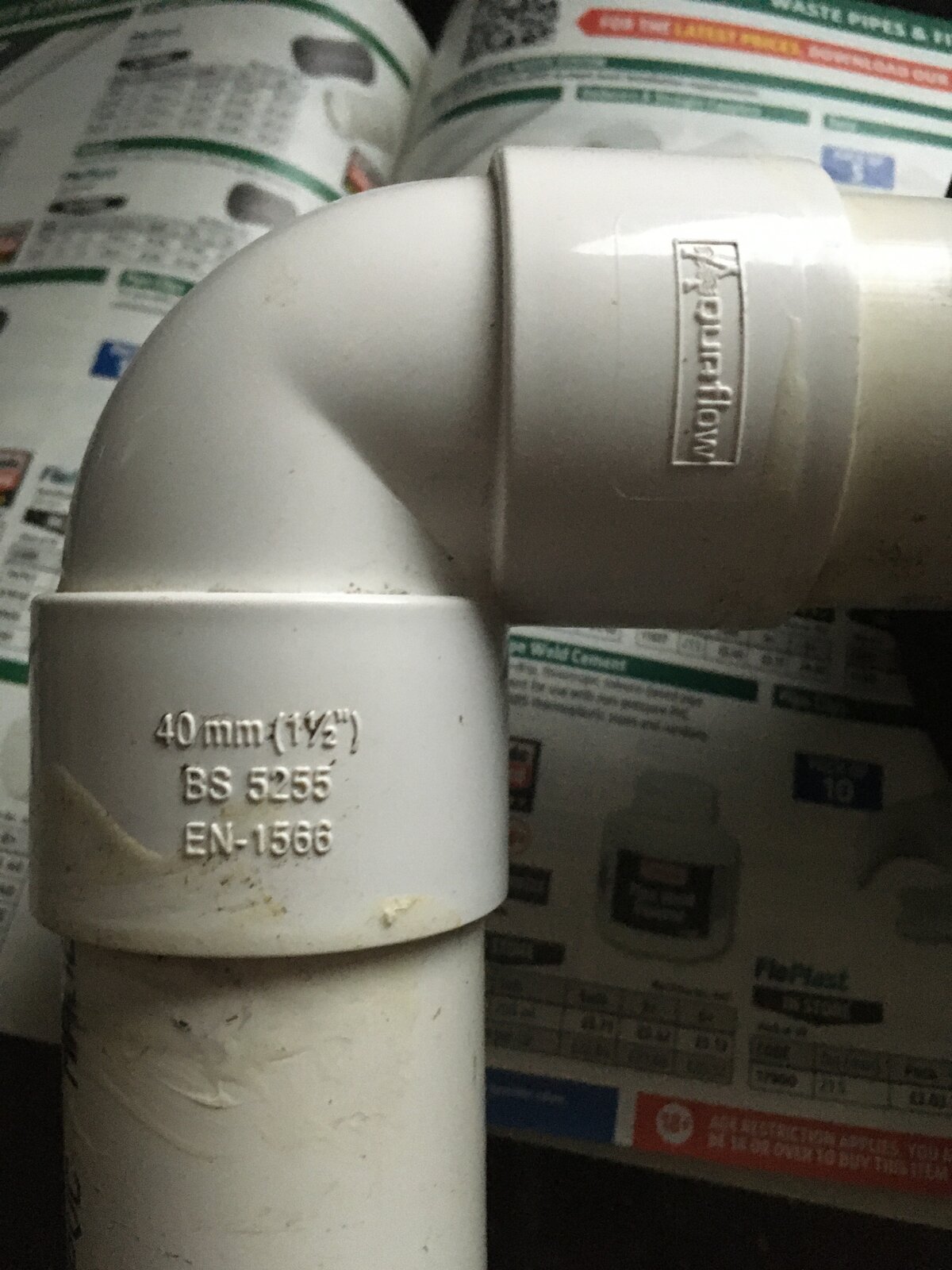

This is the other part I’m confused at, the solvent weld pipe is 43mm but the 90 degree bend says 40mm, how is that possible to get 43 into 40
Don't confuse internal and external diameters - the solvent pvc 40mm pipe is 40mm internal 43 external, the push fit PP 40mm pipe is 40mm external diameter. And presumably 1.5 inches internal or something.
And as mentioned above the compression fittings can handle both.
