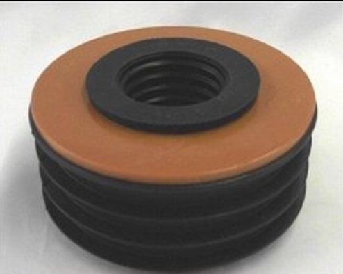

I intend to remove the bit of cast that is left and replace with 40mm waste but how do I connect that to the open vertical soil pipe that is there (directly below the waste)??
It's not like an external one where you can leave it open with a drain gulley or such like, this will be under the suspended timber floor.
You can but once the floor is down and the coupling isn't accessible there's chance that the waste pipe into the rubber grommet can be pulled out. The best solution is to bring the 4" soil to FFL and then connect on.

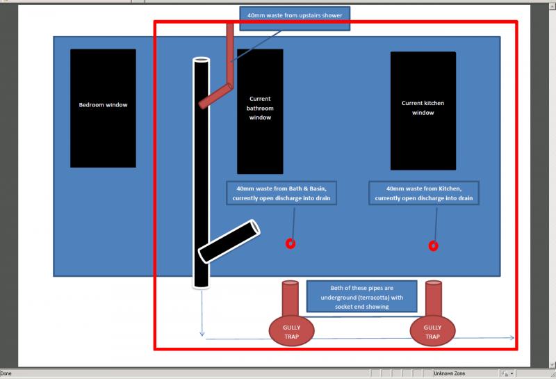

what if i capped off the two terracota pipes with screw access caps and ran a 50mm pipe from the kitchen, past the bathroom and into the existing soil pipe ?
Bit confused - you've so far mentioned terracotta, cast and plastic foul pipework in a variety of sizes.
If you go with your latest 'plan' you'll need to remove any redundant drain runs at the point where they join the main foul run.
