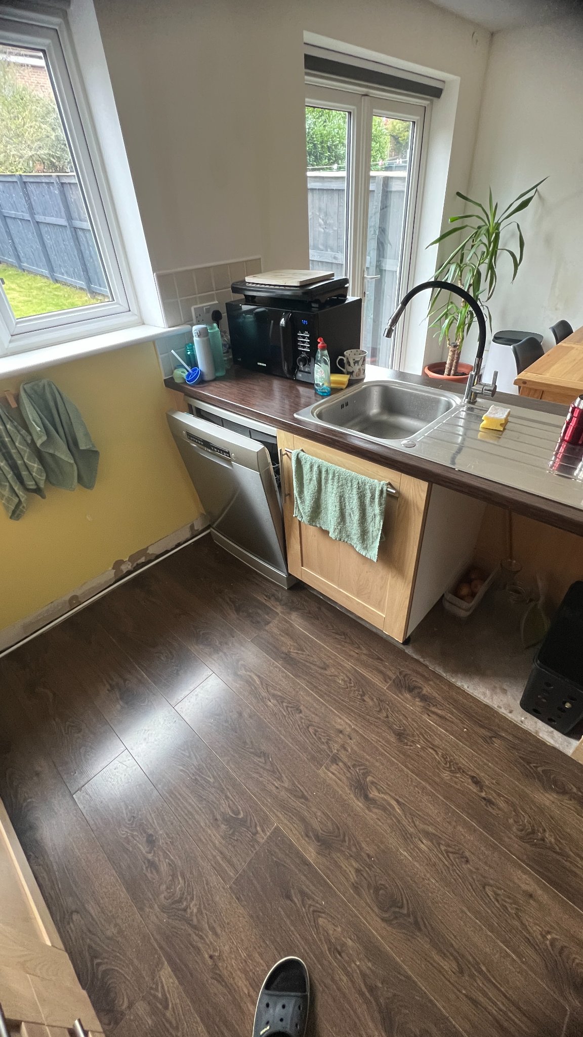

Hi all,
We recently moved a house and want to re-arrange kitchen units a bit.
House is 2009-2012 built. Kitchen has small island which is not useful at all, takes space and makes kitchen feel smaller, less space for dining.
Ideally I would move sink, drain and stop cock under the window. Get rid of useless island and make kitchen plan 'U' shape.
I have one big problem though. Kitchen sink with stop cock and drain is located in kitchen island, kind of middle of the kitchen.
I would need to re-route drain and water supply about 1.2m away. It's concrete subfloor (not sure what's under it, insulation etc).
I understand I would need to dig out concrete, re-route pipes and re-concrete again.
So main question is - is this ok to do under regs/permissions etc? Is it a must for a plumber to be involved? How do I shut off water supply to stop cock?
I am DIYer anyway, got most of the tools, just not sure how far can I go with it myself?
Any help is appreciated.
You can do it yourself, no permission required.
There should be an external valve just outside your property, usually on the pavement. If you can't find it your local water authority should help.

After I posted this, went outside and checked meter in the pavement - yes it does have shut off valve. Never noticed it before. cheers.

OP,
1. A ground floor WC is a very useful fixture for old people or kids, & can be a selling point.
2. What you propose with the WC used to need Regs approval? Perhaps it still does?
3. You presently have a peninsula not an island.
4. The internal stop valve might be under the kitchen sink - thats where it should be located after moving the units.
5. You would be best advised to use a WIAPS qualified plumber
