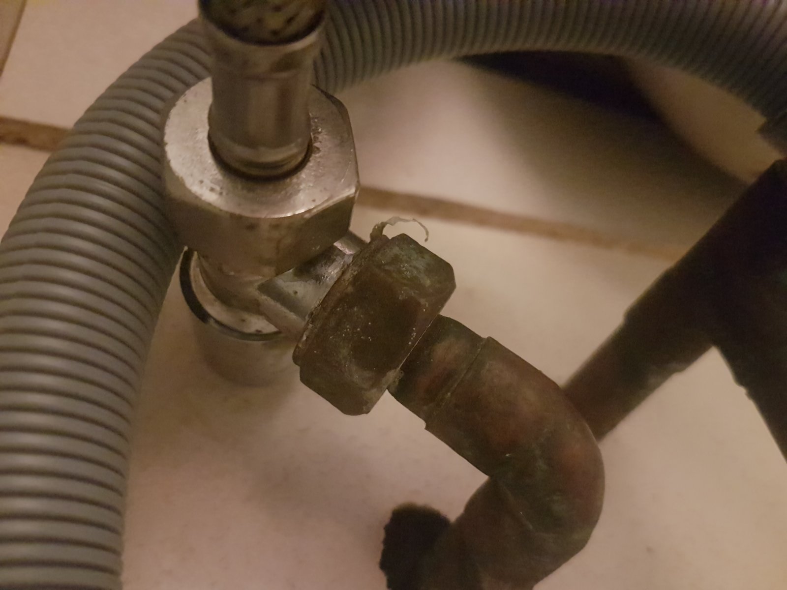

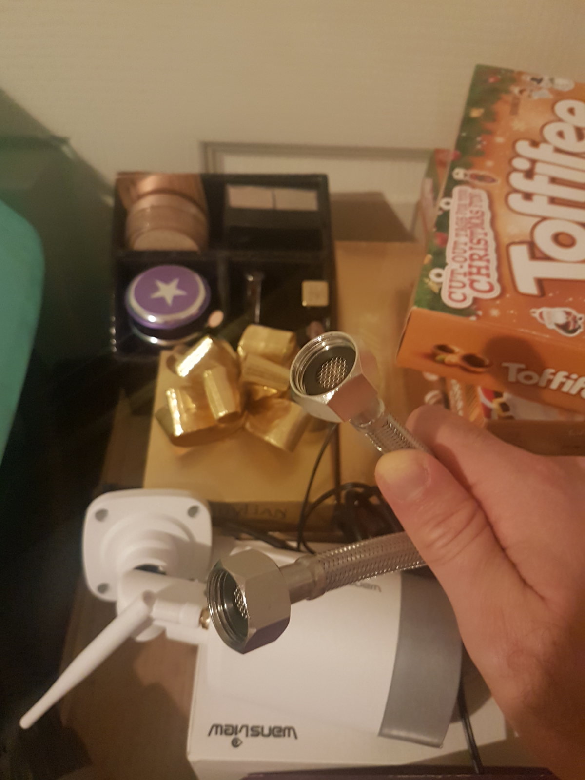

Hi guys,
Just a quick question, I've recently bought a new tap and was looking under the sink to see what the existing connections are.
I'm assuming I need adaptors for the tap to fit? I've looked through different options but some advise would be great.
Thanks!

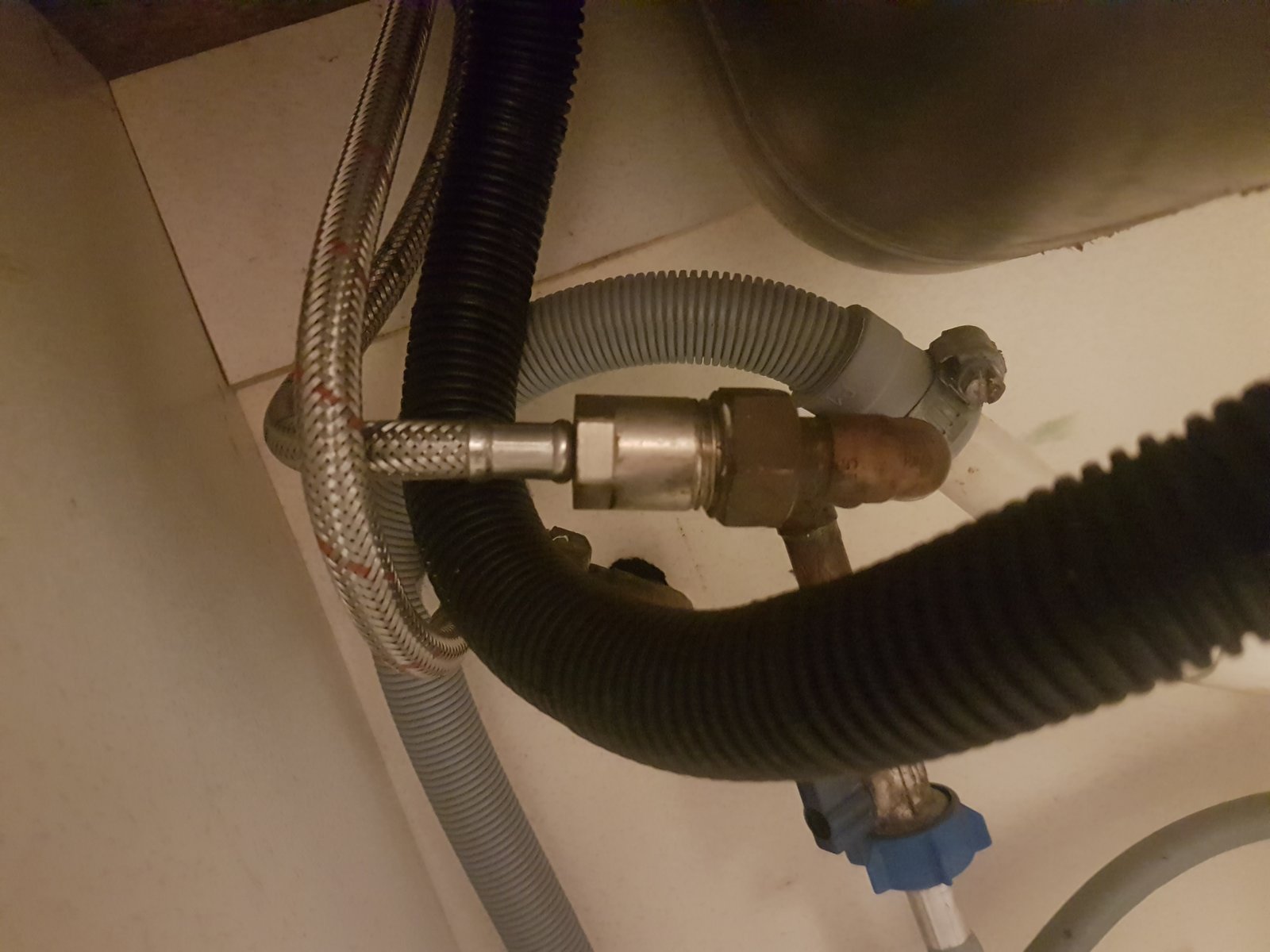

The one in the second pic is a straight swap
First pic , grab yourself one of these
https://www.screwfix.com/p/isolating-valve-15mm-2-pack/65251
Remove the two nuts and olives , attach one side of the isolation valve to the nut that will be left on the pipe with the olive already attached and attach the tail to the other end
You can cut off the olive and use the nut and olive that comes with the isolation but I've never needed to
Don't overtighten the two tails or you will cut through the rubber washers
Have a roll of PTFE tape handy too but you shouldn't need it
Brilliant, thank you for the advice. Just ordered an isolation valve and will have a go later. I've done other projects around the house etc. but not done any plumbing yet, so this will hopefully be an easy project to get going on. Looking through all the adaptors I wasn't quite sure which one would be right for it.
