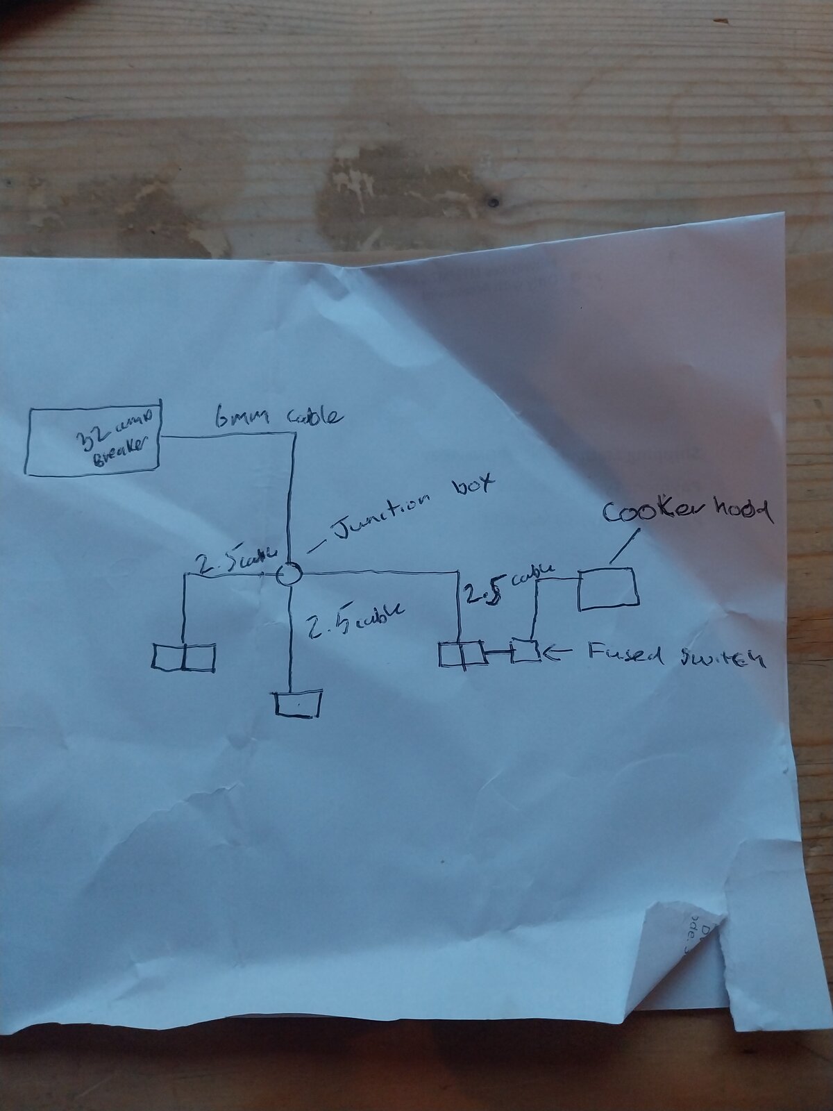

Hi all need some advice with my kitchen wiring, so I have 3 2.5mm wires coming out one junction box which is fed by a 6mm cable strait from the consumer unit with a 32amp rcbo one of the sockets also has a fused socket for a 3amp cooker hood, is this OK or will it need to be changed? See photo attached
Assuming if the junction box is rated at the right capacity then yes it's okay.
The circuit was probably for an electric oven.

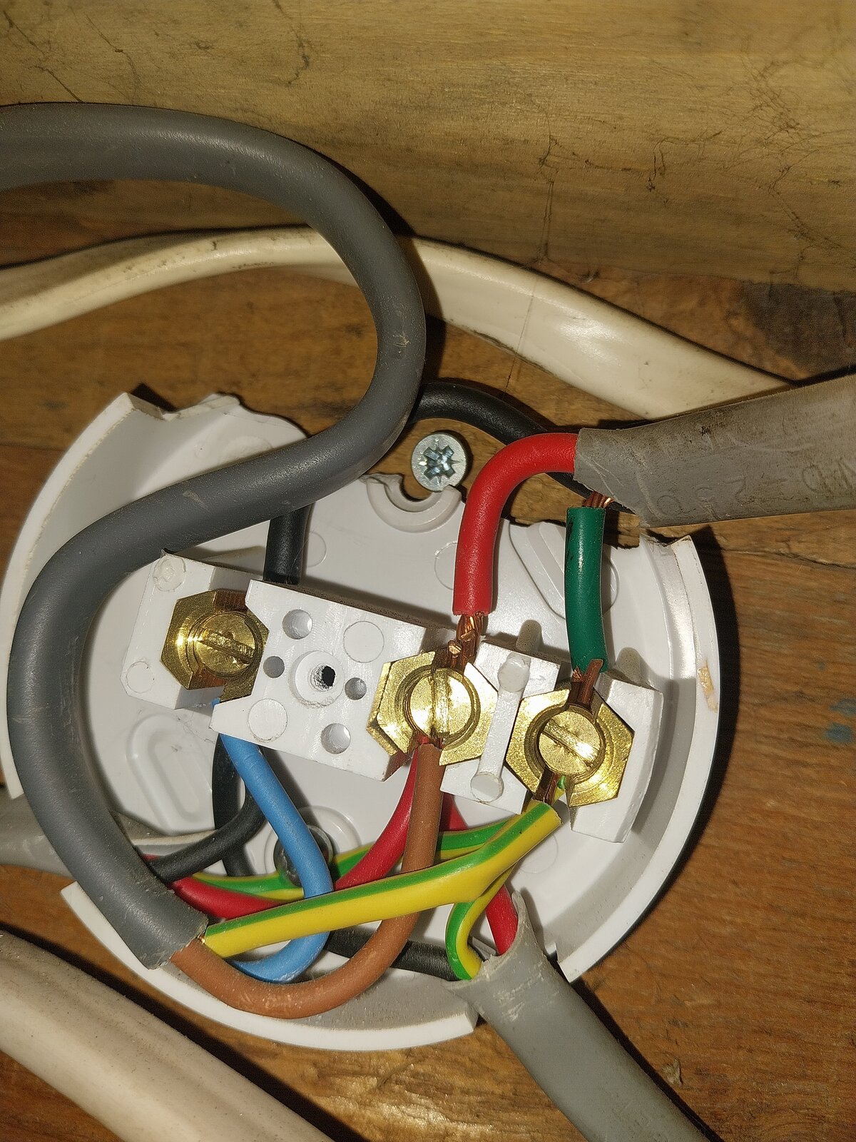

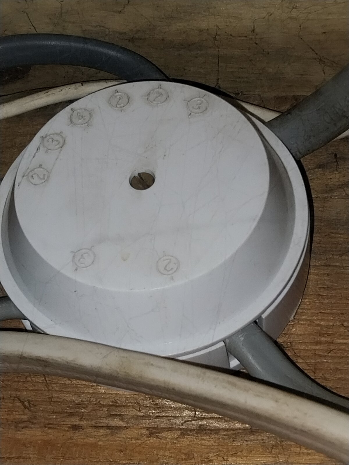

This is the junction box can't see any mrkings on it though
OP, remove the junction box cover and send a picture of it.
