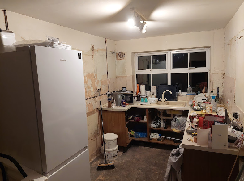

Hi,
here's a thread about a kitchen renovation for a house I bought in March. It's my first house but I have helped my Dad with DIY so not a total newbie. I haven't made great progress (mostly due to other jobs in the house to be fair). I'm hoping that posting here will motivate me to finish it as during winter I've really missed having a fully functional kitchen.
I don't have a good starting photo but it was classic 90s.

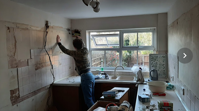

My teenage (but quite tall!) nephew helped me rip out most of the units (I kept the sink and a couple of side units so the kitchen retained some functionality). On the right side the wall units obscured the window. I like light and immediately decided the new kitchen wouldn't have wall units that side.

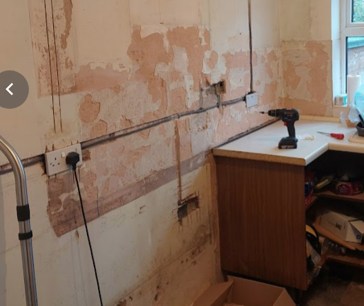

Some of the electrics were.. ahem.. interesting. When I got an RCD CU fitted the kitchen light tripped it. At least the problem was easy to find..

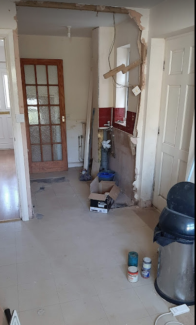

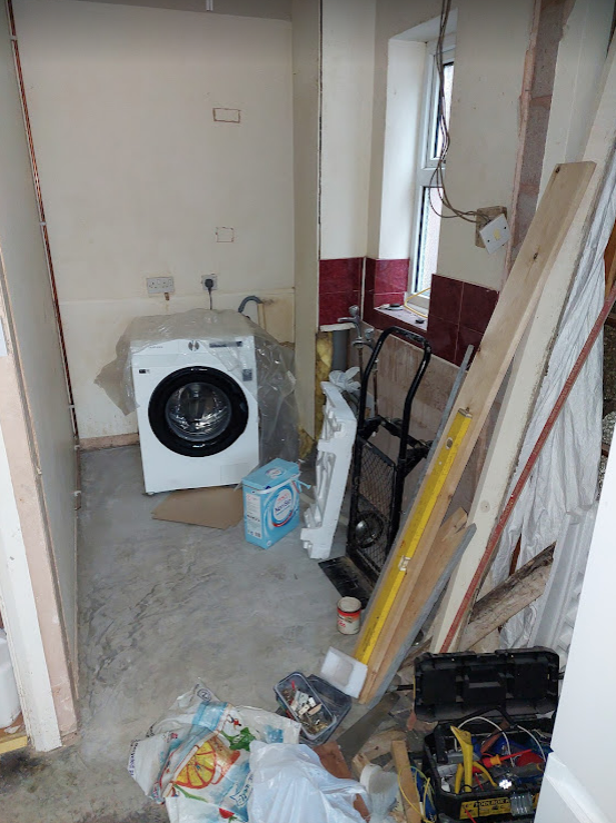

Removed partition to old utility room/pantry. It was a waste of a window and the plasterboard was rotten anyway. Not decided exactly how to use the space- simply that the washing machine will live down there. The soil stack is in the middle of the wall (why they didn't put it in the corner is a mystery). Seems a lot of effort to move the whole stack so I'll either just box it in better or move the top section of pipe and have a bend below worktop where it'll be well hidden.
Removed all the floor tiles. It's not clear in the photo but the screed is unevenly laid, especially in the utility room. I chiselled out some high spots by hand and will do more now I have borrowed an SDS drill. Then self levelling compound. Chasing all cable in wall rather than loose wires strung across the wall units! Oh... they'll all be level too!
Recent photo:

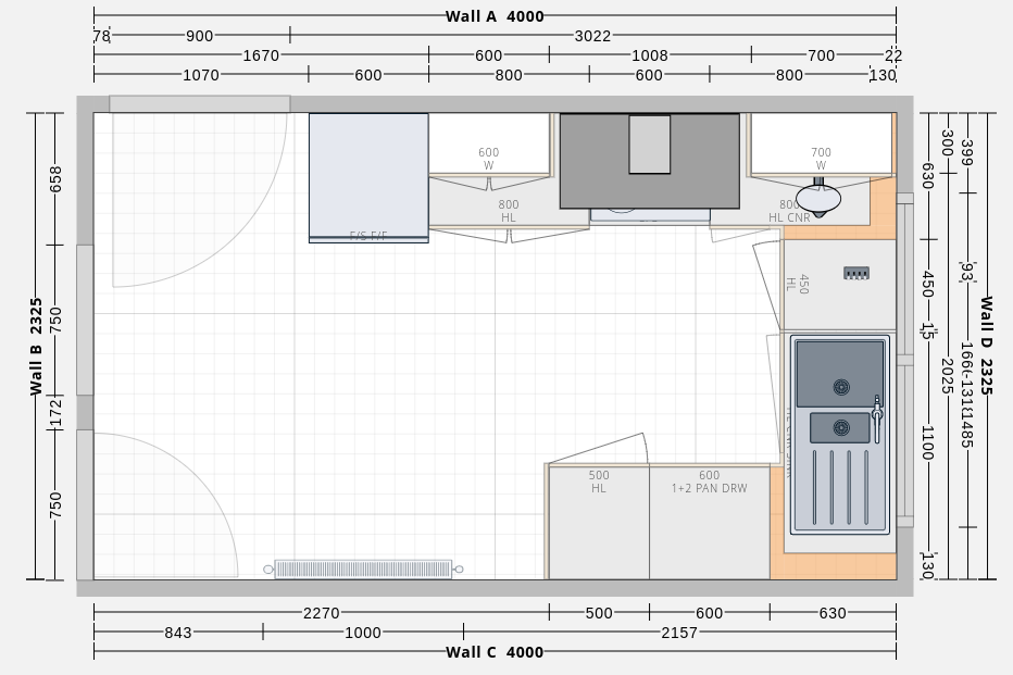

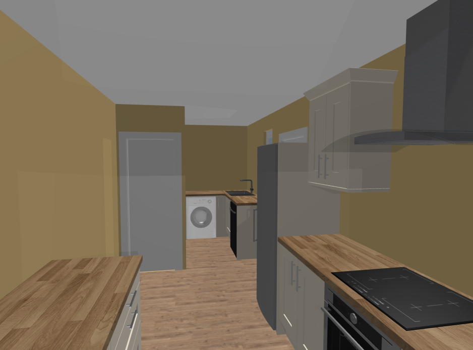

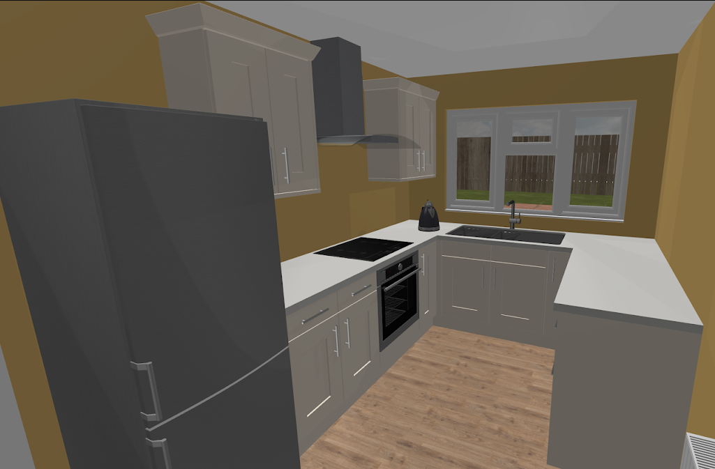

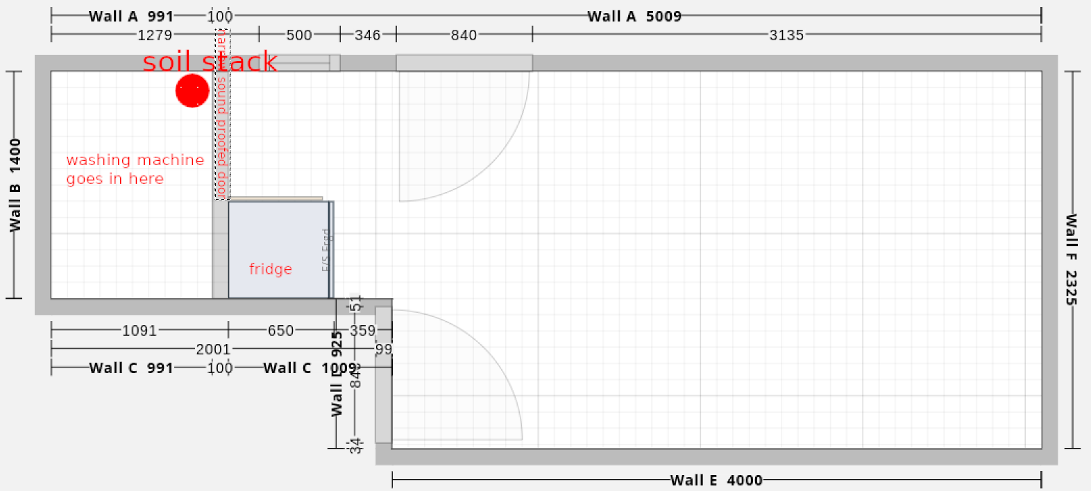

First design concept (fridge is wrong colour but the orange walls might stay!)

Great thread.
Make the window as big as possible.
Light is everything.
I'll add some morr comments. You put a lot of effort into this.
Think about putting a window on the right wall.
Think about not having two sets of cupboards on both sides. That's going to make the space very cramped.
Where is the dishwasher going?
Think about the space behind.
Kitchens are tools but they are also communal spaces. You spend a lot of time in it so see if you can make it more accessible.
Tall cupboards are great but you can't reach the top. You will need steps and somewhere to store them. This gets boring quickly.
You can't have too many sockets.
Think about having a pantry. This keeps the food stuff in one place away from the kitchen stuff. Old idea but a great one. We have added a shelf rack in our utility room and its been a revelation.
Utility room for dryer/washing machine/ chest freezer?
Have a look for open house viewings in your area, or go on Google and view any recent house sales. This will give you a good idea of what others have done.

Thanks, really helpful!
The right hand wall unfortunately is internal. Side door will have a window eventually, which will help.
Yes I wanted to avoid cupboards on both sides so there'd be space for a little table and hopefully make it feel less cramped. However, I think the extra storage and worktop is needed. If I put the fridge in the old utility room it'd be fine but then it's a few extra steps from the cooking area to fridge and I'm lazy! The main area looks like below.
The utility bit is ~2.1m x 1.4m- I'll update the design to include it (as it'll help with deciding about fridge placement).. roughly it looks like below. I like the idea of a pantry but don't think it would fit.
The other idea was to change the side door (which I barely use) for a window to allow a full length (6m) worktop and base unit cupboards down that side.
Dishwasher felt a waste of space so I didn't include it. Probably you're right though it should be there or at least I'll do the plumbing and put in a 60cm base unit I can remove in the future.
Good point about sockets. I've got 3x doubles on the cooker side now but can fit 2 more (respecting the 30cm exclusion next to the cooker and keeping the fridge there).
This morning I scrubbed and primed the utility area floor- aiming to get the self levelling compound down after dinner :) The skirting at the back (low part of the floor where water pooled) is rotted but the plaster seems OK-ish.

Why the need for a "sound proof door" partition?
Do you have another rear door for back yard/garden access?

Morning all, hope you had a happy Christmas and thanks for the tips/encouragement!
Not done much :/ Got the levelling compound down in the utility area. It's a big improvement but I rushed it and overestimated how much it would self level. Washing machine runs quieter, an unexpected bonus.

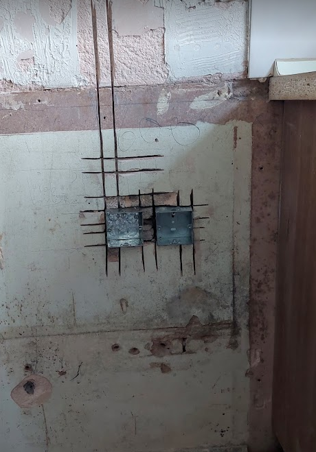

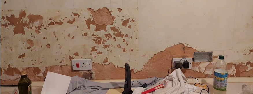

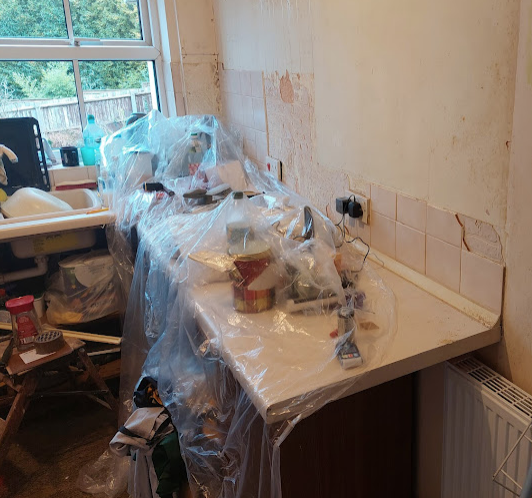

Yes I have a new ring for the kitchen sockets. Current plan is 3x doubles (1 USB) on each side of the main area (and the single on the cooker switch)- they're done on one side but I still need to do the other side (which currently has a single socket wired between lounge and bedroom). That feels loads compared to the original kitchen but I might squeeze in 1 more. I haven't planned the lighting yet. Floorboards above are up so fitting down lights should be easy.
Other electrics to do:
-Move/replace cooker switch (at least so it's level with the sockets).
-Oven fused point.
-Hood fan fused point.

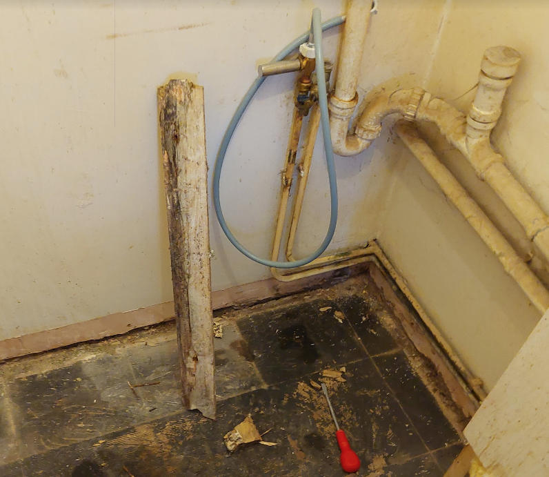

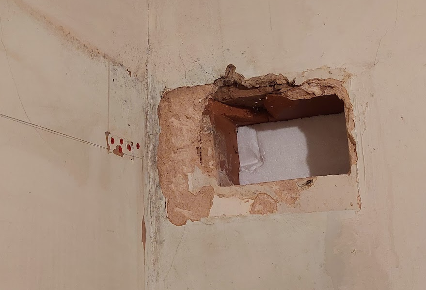

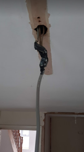

Plumbing needs more planning. I get bad water hammer and I think it's partly because the cold supply does a weird C shape around the kitchen with 90 degree compression elbows. I'll try a more direct route with gentle bends in the pipe. In the other direction I'll get 10mm hot water pipe in for the sink. This will need boxing on left of the window. Central heating and gas (unused) is already boxed on the right. I might just plasterboard all of the far wall round the window/above the worktop (18mm void should be enough and won't be noticeable loss). There's no stop-tap specifically for the kitchen (supply enters from kitchen floor) but the main one works (has had plenty of use :) ).
There's also an old broken air brick vent to deal with.
Damp- good call. There's a bit of mould by the broken air brick but I think it's because the old extractor hood was badly piped out there. Otherwise it looks surprisingly good.
The sound proof partition was for soil and washing machine noise. However, now I've seen the washing machine is much quieter on new flooring I won't bother (just box in the soil neater). So it'll just be open with space for a slim dishwasher, washing machine and a small sink down there.
There are only patio doors from the lounge. I've found that fine so far but perhaps it's because I use the lounge as a workshop so don't mind walking through in muddy shoes! So I'll probably keep that side door even if it wastes space.

I dont see any advantage in having a second sink or a dish washer located in the recess?
The d/w should be located as close to the main sink as possible.
The S&VP in the corner can be overboarded to suit.
Where is the washing machine discharging to - the S&VP or is there a gulley outside?
Where is the boiler - dont attempt to use a 10mm H/W supply - roll out a min of 15mm plastic pipe
but in reality you need a plumber on site to sort out (long?) runs? of h/w to various appliances and fixtures.
Kitchen rads can be vertical - jut like bathroom rads - to save space.

Hack off bad plaster and then brick up & plaster over the inside skin of the old air brick opening, later you could brick up the outside air brick opening.
The mold is only a bit of condensation.

The 2nd sink will be handy for cleaning muddy clothes and DIY stuff away from food preparation area I think. I'll put the old sink there for a few weeks to see how it works out. I see the point about d/w and agree (either don't bother or put it somewhere convenient).
Boiler is directly above recess/utility area (old airing cupboard) so it's not a massive run- just the 22mm pipe makes it seem like a lot of water has to come through. 10mm plastic wouldn't support a dishwasher next to the sink for sure.
Yes the washing machine, downstairs toilet sink and (former) utility sink went straight into the soil pipe (all separately). If I keep that setup I guess noise control would be difficult. There is a pipe directly outside the wall under the path but I think it would be a lot of work to join into. I had thought about moving the whole stack outside but given the hassle and costs with BC it doesn't seem worth it.

Yes the mould scrubbed off easily. Cleaned up plaster this afternoon and temporarily filled hole with polystyrene. Tempting to cut out the broken part to get right to the cavity and then sticky foam onto the existing insulation so it's not a cold bridge.

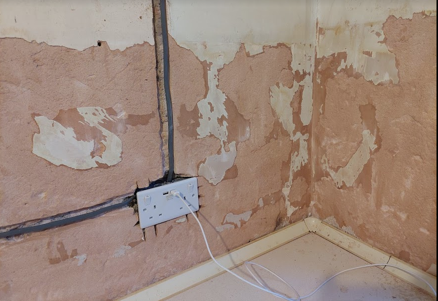

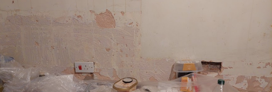

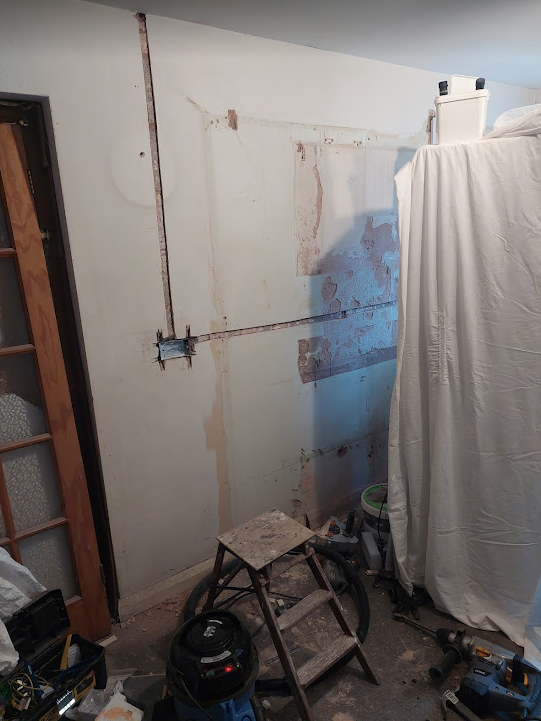

Did a bit more chasing (until the neighbours came back- still needs chiselling out). The sorry lesson from today is that the cheap Henry knock-off bags are useless for plaster dust extraction on the chaser :( Serves me right for trying to save 50p per bag. Back to original hepa flo bags next time for me. AVOID https://www.ebay.com/itm/133285314354 (unless for normal household vacuuming)

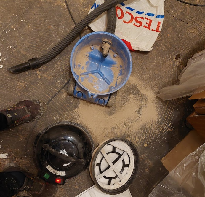

Did a satisfying shift today, although didn't achieve as much as hoped.
Tiles came off fairly easily but I should have taken @tell80's to totally clear the room and units- planning to relocate the sink temporarily tomorrow at least.
Also pulled out the wall plugs (apart from the ones that disintegrated and left the stub in) and nails (had to just cut one out with angle grinder as my crowbar efforts were too wimpy).
Then the real work of scraping all the adhesive and loose plaster off began. After that I wire brushed, followed by vacuum brush and then PVA.
Before:
After:
This seems to have given a firm base I can skim over, although I'm still slightly tempted to hack away more plaster. Coincidentally there was a concealed back box behind the tiles almost in exactly the spot I had planned to put a socket- seems they couldn't make up their mind about height for the three old sockets!
Other wall close up:
Slowly getting there! Next- get the remaining units out, decide on dishwasher placement, finish chasing, bonding plaster in the bigger gaps and skim over. Not sure I'll be done by 3rd Jan!
