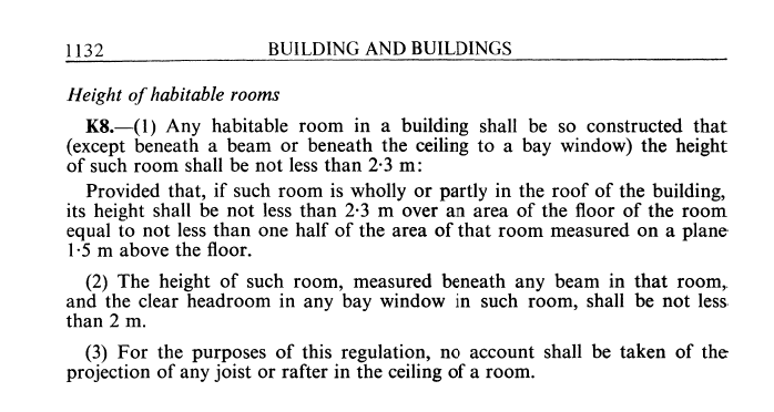

must have at least half the floor area over 7ft high.
It was actually stricter than that, it was 2.3m over half the room.
