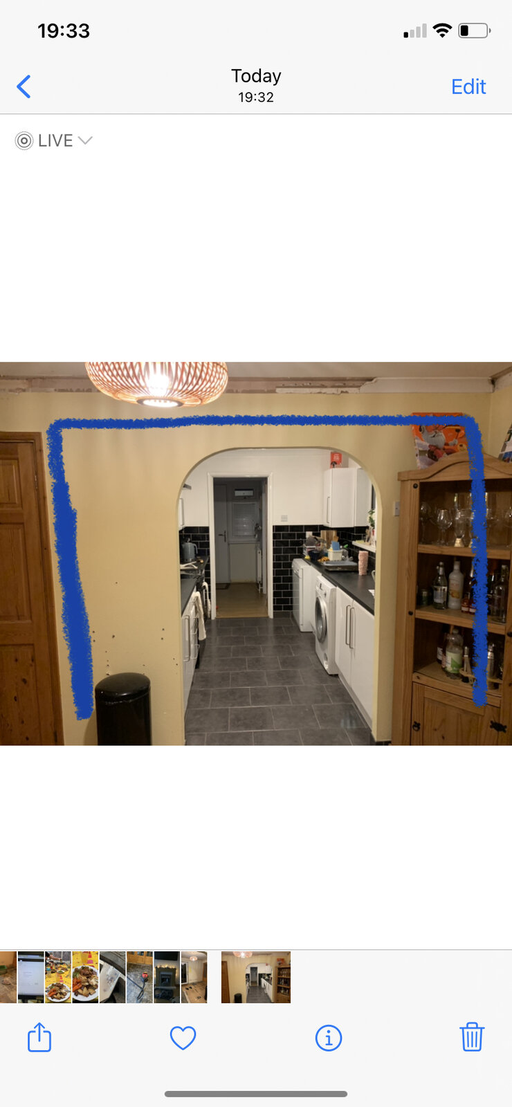

Hi all
I am knocking through this stud wall, blue line on the picture. Behind the wall (where the cabinet is) is the soil pipe.
Just wondering how the best way to remove this stud wall is?
Many thanks

Wrecking bar for the p/board, recipro saw/jab saw for the stud work. Identify and Isolate the wiring run and any other services. (Removing the switch will give a clue as to the direction and source of the cables). Decide how you are going to conceal the soil pipe first. You may be able to re use some studs or even leave in situ. Lots of dust.
