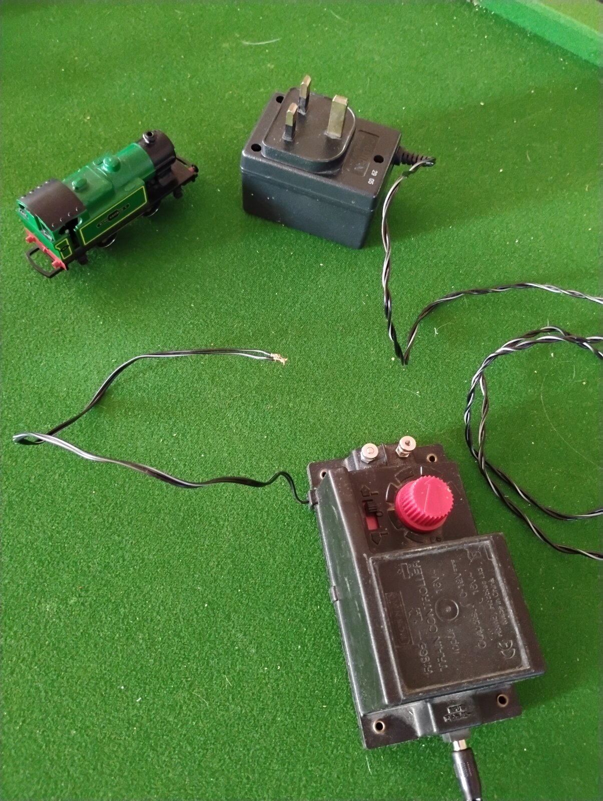

So my little boy wants to get into Hornby. He's bought some track and we just got a transformer and controller from eBay. But I don't know what to do and I think something is missing. I'll attach a picture so if anyone knows what to do next that would be handy. Cheers.
Scratching the brain cell and going back 60 years, the DC output from the transformer needs to be connected to the rails of the track.
Forward and reverse is dealt with at the transformer - the black sliding switch with the red background, in fact.
John :)

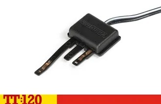

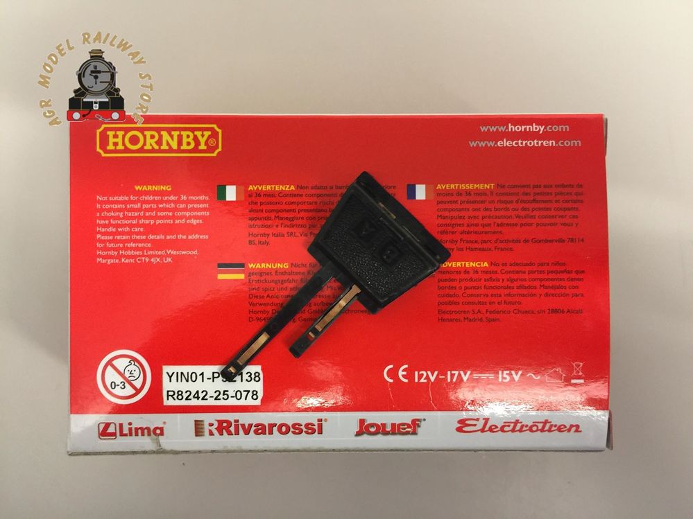

There should be a connector that slides into a gap under the rails that transmits power to the rails.
Don’t switch on with those output wires touching!
You could experiment by connecting the wires to the track with crocodile clips once you get some track laid out.
John
Track connector clip needed. You clip or solder the wires into one of these. Buy online. Have fun! Need to set my old Hornby up in my loft for my kids
Did the seller make any claims about the connector? Or have photos not showing the bare ends?
Maybe he didn't con you - maybe (and this is no fault of yours whatsoever) you just didn't know what you were buying, and ended up, unfortunately, buying something not 100% complete.
Doesn't look as though the situation is irretrievable though.
