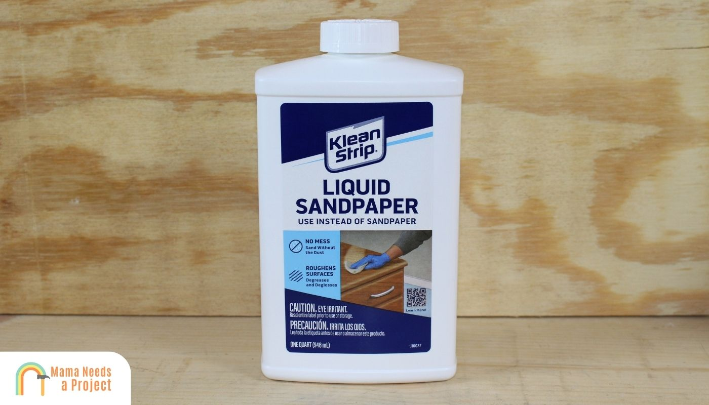

Treat the surface with Liquid Sandpaper to save dismantling it (y)
